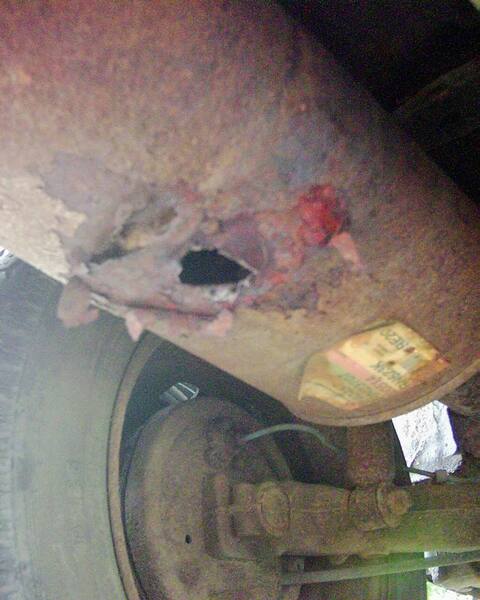

No idea...but nothing visible in this snap I got of mine when the exhaust failed spectacularly one afternoon.  It went from "fine" to "dear god I can't see where I'm going because my eyeballs are vibrating out of my skull" in the space of about 0.2 seconds.
I do recall it handling really quite well once you got used to it feeling like you were driving a pillow and that it would go round the corner far more securely than the floating and rolling would suggest.
Would be just out of shot there, the rear ARB is bolted to the arm just behind the fulcrum. Probably only the turbo that got it, mine has turbo trailing arms from the factory.
Phil
Figured that might be the case...is the only photo I have of the underside of it though!

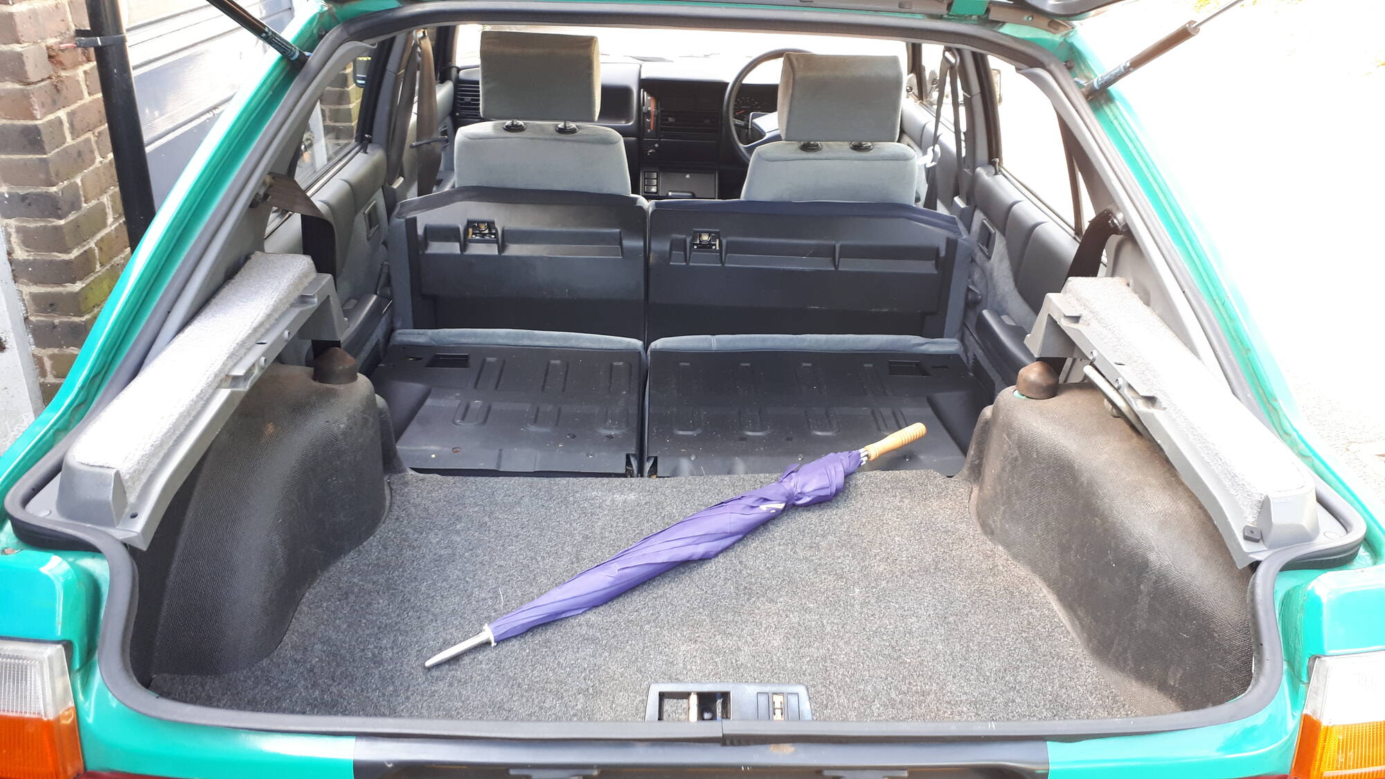

Some random tinkering yesterday. Although I've done a few tip runs in this, I've never had the seats folded down.  Pretty good load area, and the struts aren't too intrusive.

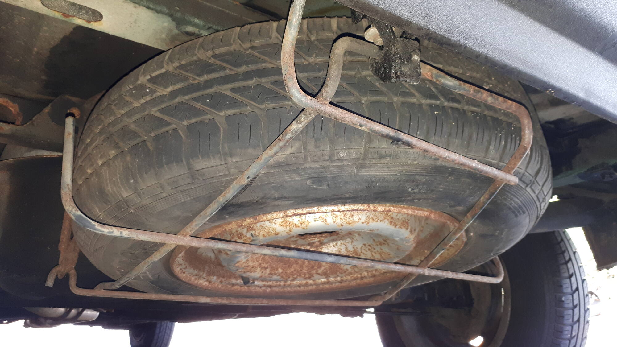

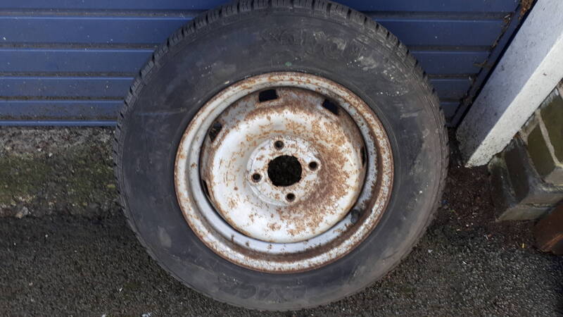

I've been meaning to check the rust situation behind the spare for a while, so off it came.
First off I wasn't sure how to release the carrier, but worked it out quickly enough.
Good job, as Régie's manual omits this bit of information.  It mentions nut 4, but there ain't no pic.

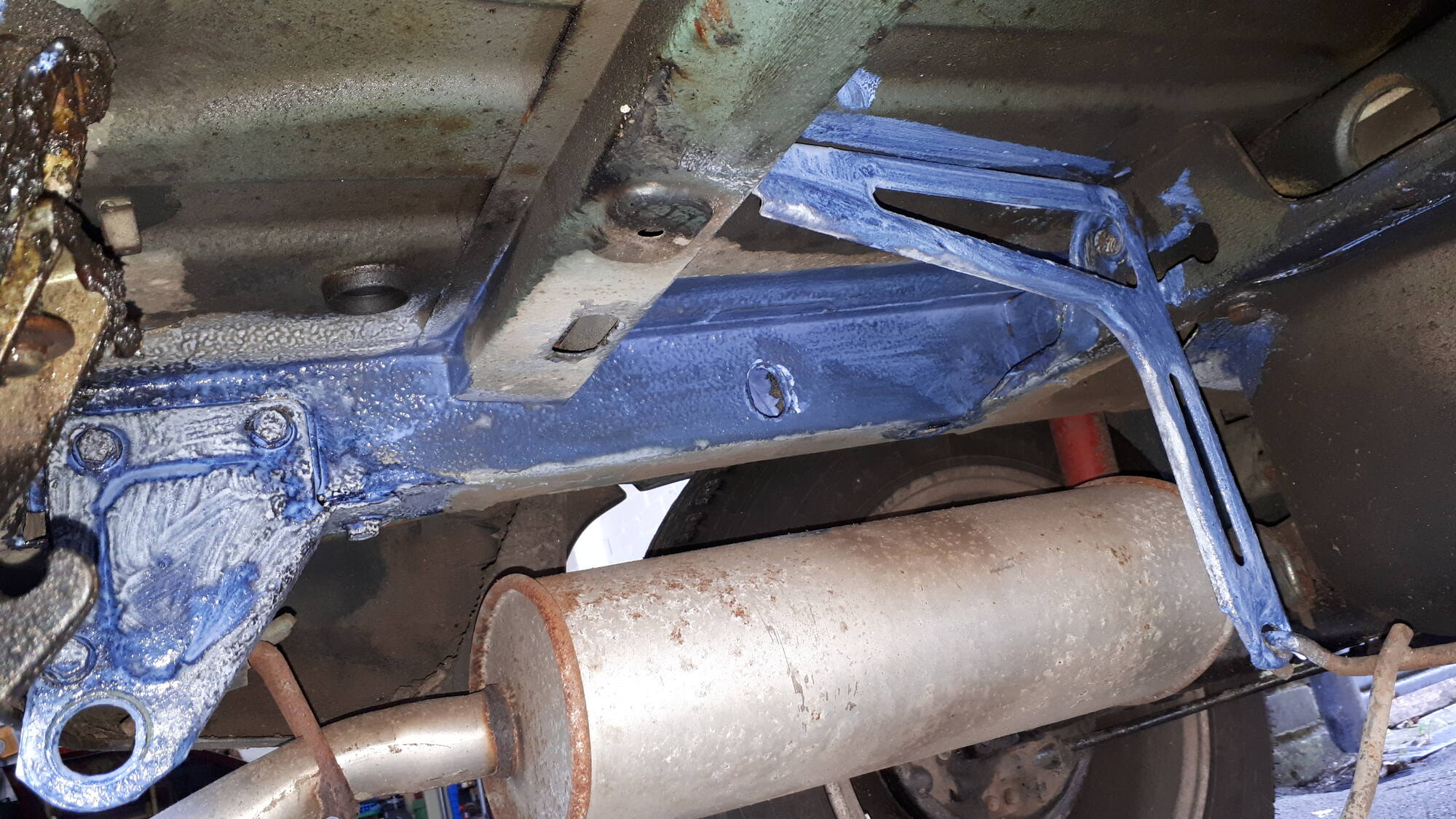

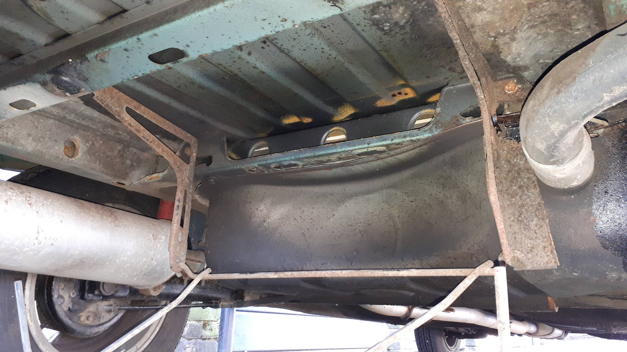

Apart from the brackets and a few small spots it's surprisingly good under there, so I cracked open the rust converter.
Further along the floors look well protected from the factory.  I was tempted to wire brush any dirt off, but there's the risk I'd split the OE underseal and just create future problems.  It's survived 33 years on rural Cornish roads like this, so why bother.  Likewise the outer sills and mud traps.  I cleared out some crud behind the front arch liners, but it really is solid in all places.  The only areas where I will lob some Dynax cavity wax is the box sections at the rear, as I could see a few rust spots in there.

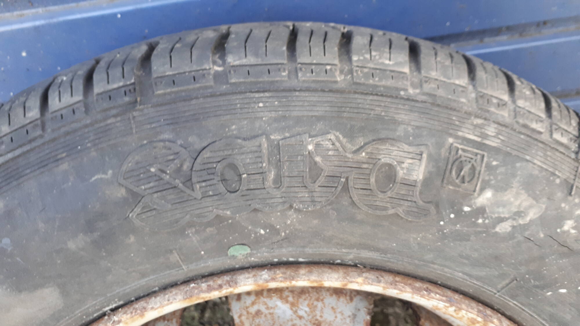

The spare is old so that'll need replacing.
Made in Slovakia no less, so that's probably early to mid 90s.

Interesting.  You have an additional expansion box on your exhaust.  Mine was just straight through to the silencer at the back.
1987 11TC.  During the changeover from Phase 1 to 2, made apparently with whatever scraps were rolling around on the factory floor.  Barely anything matched the parts catalogues.
That spare wheel and tyre has done a grand job of protecting that section of the floorpan....
Exactly the same spare wheel system as the BX uses and, if memory serves, Peugeots of the same era.  Seems to be a French car thing.
Can't say I'm a fan of having spares slung underneath, but that's definitely a plus point.
I once had a near miss avoiding someone else's spare that had dropped from its carrier, so that's the flip side obviously.
I agree with everyone's comments here that an underslung spare tyre is easier to steal...but if you do have a flat, at least you don't have to unpack the entire boot to change the spare!
As long as you can actually reach the release nut... Also, these hangers have a nasty habit of seizing up through lack of use.
It’s also not much fun in the rain, or if you have been driving on muddy roads and the spare wheel is covered in mud, or worse from local farms..

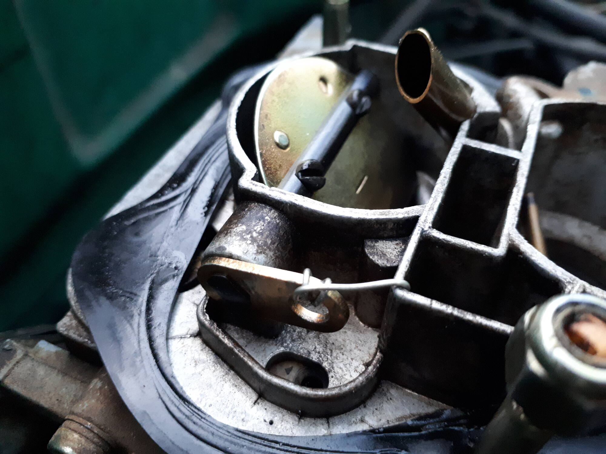

A few weeks ago I had my first FTP in this.
Fortunately just half a mile away, so I managed to leg it back home, fetch the Cav, and tow it to a safe place with the help of Mrs T.
It'd briefly fire, but no amount of fucking about pumping the throttle or giving it choke would help.  Turns out the choke flap connecting rod had fallen off.
So with some invaluable advice provided by Mr @320touring, I got some old fuse wire and bodged it so the flap was around 40% shut.
With some balancing of the manual choke I got it started late one evening and limped it home.  A slow coast towards one set of traffic lights, then it was down hill all the way.

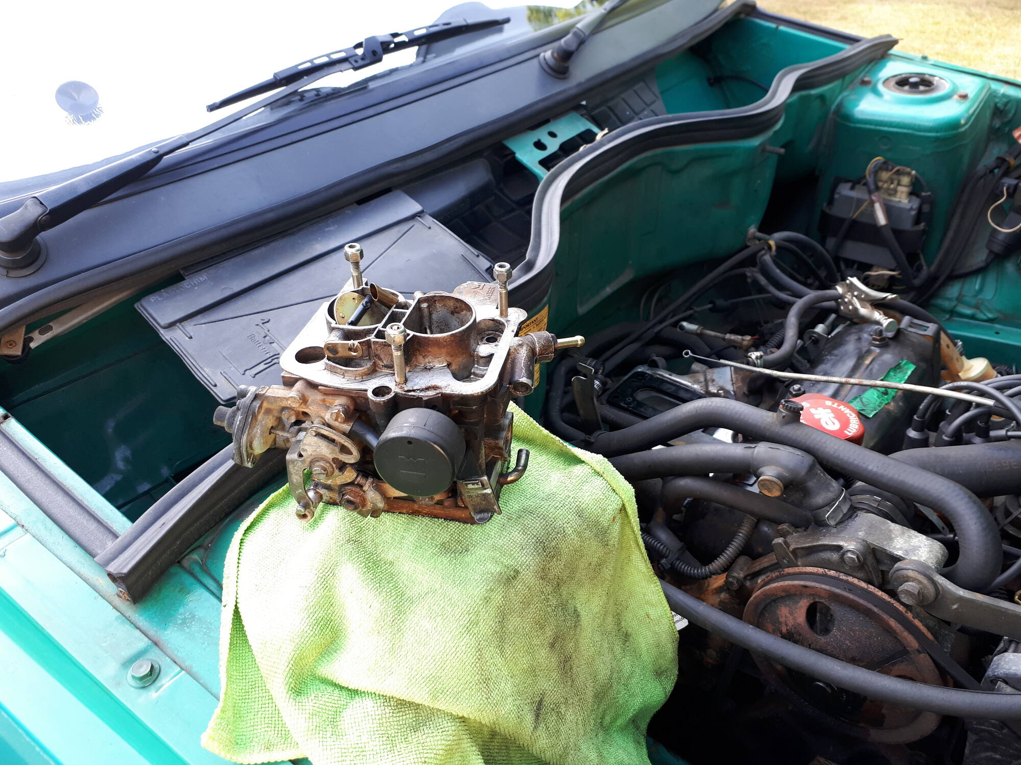

Took the carb off the next day, which made me feel like a real man at last.  First time I've ever done so on any car.
The part I need goes where my thumb is up to the lever at the top.  Initially I was going to bodge something, but I contacted a few places and Southern Carburettors have the connecting rod in stock.  They had to order the mounting bushes, and apparently it's a known fail point where the bushes eventually wear and the rod just drops out.  Great that innit.  Oddly Webcon Ltd who are the UK distributor for Webers said the part wasn't listed or sold separately.
