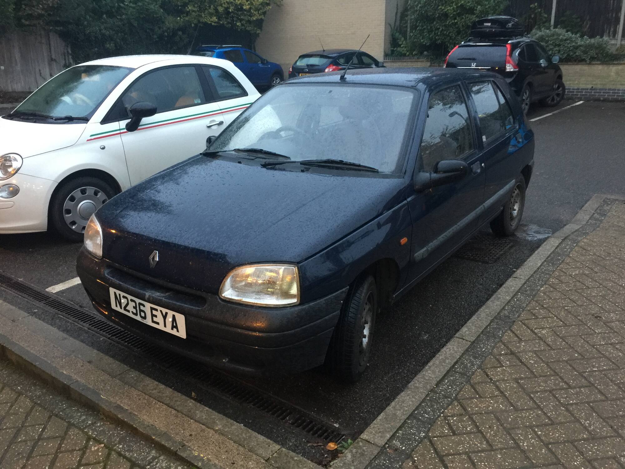

i chucked it in for an MoT today at my usual place and this happened:
That was reassuring but it wasn’t all plain sailing. I was asked to come and have a look at the car on the ramp. The tester showed me the drivers side calliper was binding and had worn one of the pads right down. I guess this is the source of the scraping noise under braking, I had convinced myself was the rear brake shoes until I pulled a drum off to have a look. In my defence, 10 months ago when I last checked them all four pads were fine.
The tester reckoned it was the slider rather than the piston that was sticking, so I’ve ordered a slider kit and a set of pads, will tackle the job later in the week. She said it should have failed but passed it because she knew I’d repair it.
I also had my attention drawn to a very worn steering rack (with plenty of play on the drivers side) and a leaky front shock. The rack is a job I’ll do in the spring - it’s far too cold at the moment.
Ive also just had two new ditchfinders put on the back as the old ones were very old and one of them had a puncture. They go with the two new fronts I had fitted shortly after purchase.
The plan for the near future is a full service including plugs and leads, and obviously the calliper and pads as mentioned. I took the Renault 11 trimz off mostly to clean them which I’ve done and also because it’s so difficult to get the airline on the valve when you’re pumping a tyre up all the time. I actually quite like the utilitarian look without them, being a base RL model it shouldn’t have full trims anyway, it had centre caps originally.
