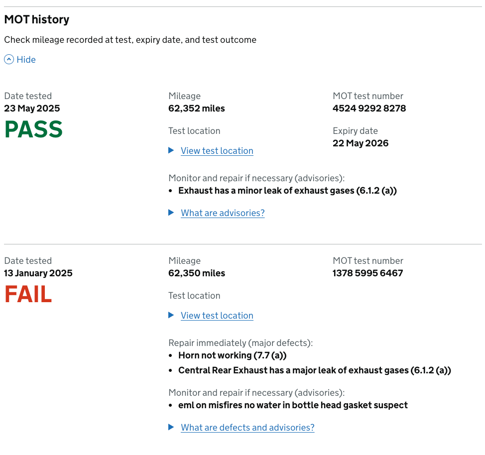

LightBulbFun Posted June 24 Author Posted June 24 2 hours ago, SiC said: Ah, so he didn't sell it as that he knew it had HGF? Was this something you thought it might from the mayo? Or something he deduced from the mayo when in person? yeah he didn't think there was a head gasket issue but my guessing is based on the MOT fail before the pass, and then seeing Mayo, he bought it auction or something like that by the sounds of it, between MOT maybe? and well sure the keeper address on the V5 started with "NDA Belvedere Auctions" so make of that what you will! 2 hours ago, SiC said: Either way just drive it and see if it consumes any water or mixes. I suspect it'll be fine. but yeah there was coolant in there that looked like coolant (orange stuff) maybe a bit low? tho I admit I was struggling to find exactly where the min-max mark was on the coolant bottle! (not because it was dirty or anything I just couldn't find it LOL) and and the level did not seem to change, we did pull over to check just before crossing tower bridge, but we have only done 15 miles or so 2 hours ago, SiC said: Code reader, depends on the budget. But for just this car, I'd get a ELM327. Look for a v1.5 with a PIC microcontroller in - usually the eBay sellers make a fuss about it. They are the 'proper' ones. As in they're knock offs of genuine (which you can't get anymore) but not the cheapened out version that some sellers now sell. Get one of the many OBD code scanners apps on Android. Torque is often cited and also Piston used to be good. No idea if either aren't chocked full of ads now though. Loads of obd scanner apps though. They all only do the basic engine. If you want to scan more modules on it try this app: https://play.google.com/store/apps/details?id=com.ScanMyOpelLite.Main If everything works okay then this is the paid version: https://play.google.com/store/apps/details?id=com.ScanMyOpel.Main A lot of bad reviews are going to be from crap ELM327 adapters causing miscommunication. If you want a universal reader then cheap OBD scanners will do the same as torque/piston/etc - just engine. More expensive (~£100) will do engine/airbag/abs. Even more expensive (>£250) will do all modules like scanmyopel above does on just Opel/vauxhall. I'd probably start with a elm327 and torque/piston to get the engine error code out. Probably a O2 sensor code, cat efficiency code or maybe even thermostat. Possibly even from not being driven enough and getting to temperature. thanks for the low down details , are there any IOS versions or equivalents? not really an android household here im afraid! I can find a few reporting "V1.5" IE https://www.ebay.co.uk/itm/365369288121 but not too many that explicitly mentioning having a pic microcontroller (and can that in itself be trusted? LOL) 2 hours ago, Andyrew said: I certain on this age corsa you can still do the "pedal test", that should get you a code up in a morse code style flashing the spanner light. You won't clear a light but it's free. I'd guess the light will turn itself off anyways, coil pack misfire or crank sensor was the usual. As Si has said, mayo on cap really common, oil in the coolant isnt alway HGF either if the tank looks murky. These cars can take a surprisingly large amount of abuse and still just not die. They will sound like death but just drag on. oh thats handy! ill see about trying that/getting him to try and see what it flashes back! (I am hoping if it is not HGF then it will be something nice and simple like a coil pack or duff sensor thats not too hard to change, that would be nice!) lesapandre 1

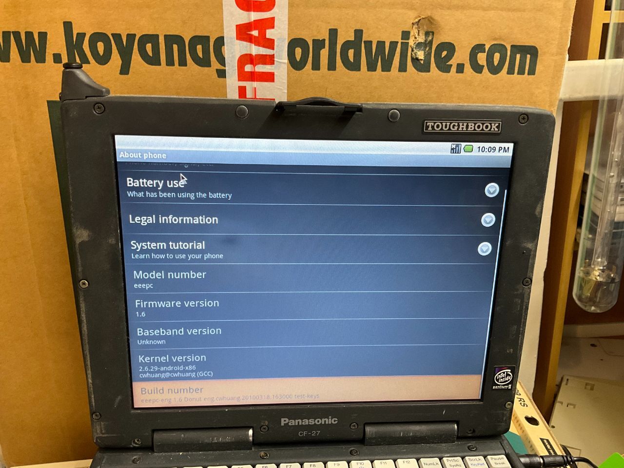

LightBulbFun Posted June 24 Author Posted June 24 43 minutes ago, SiC said: I'm sorry to hear that. My condolences. well I did set this up a while ago, maybe I can find a bluetooth PCMCIA card for it LOL #softwareabuse \ lesapandre 1

urpert Posted June 25 Posted June 25 On 24/06/2025 at 12:06, LightBulbFun said: yeah he didn't think there was a head gasket issue but my guessing is based on the MOT fail before the pass, and then seeing Mayo, he bought it auction or something like that by the sounds of it, between MOT maybe? and well sure the keeper address on the V5 started with "NDA Belvedere Auctions" so make of that what you will! but yeah there was coolant in there that looked like coolant (orange stuff) maybe a bit low? tho I admit I was struggling to find exactly where the min-max mark was on the coolant bottle! (not because it was dirty or anything I just couldn't find it LOL) and and the level did not seem to change, we did pull over to check just before crossing tower bridge, but we have only done 15 miles or so thanks for the low down details , are there any IOS versions or equivalents? not really an android household here im afraid! I can find a few reporting "V1.5" IE https://www.ebay.co.uk/itm/365369288121 but not too many that explicitly mentioning having a pic microcontroller (and can that in itself be trusted? LOL) oh thats handy! ill see about trying that/getting him to try and see what it flashes back! (I am hoping if it is not HGF then it will be something nice and simple like a coil pack or duff sensor thats not too hard to change, that would be nice!) Car Scanner is a good iOS option: https://apps.apple.com/gb/app/car-scanner-elm-obd2/id1259933623 lesapandre and LightBulbFun 2

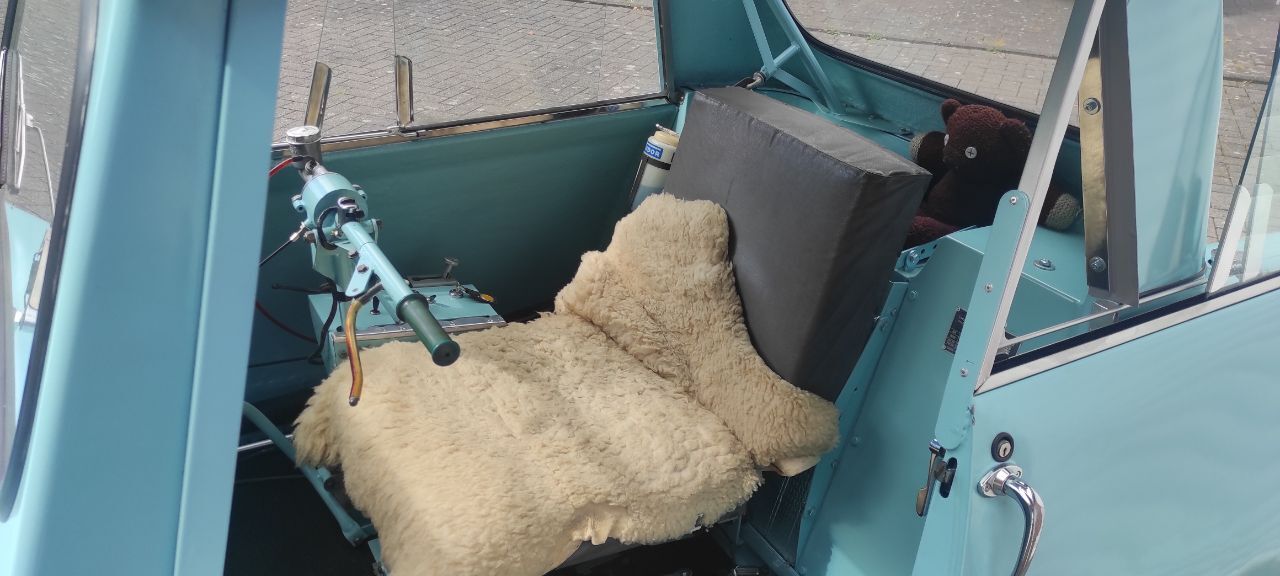

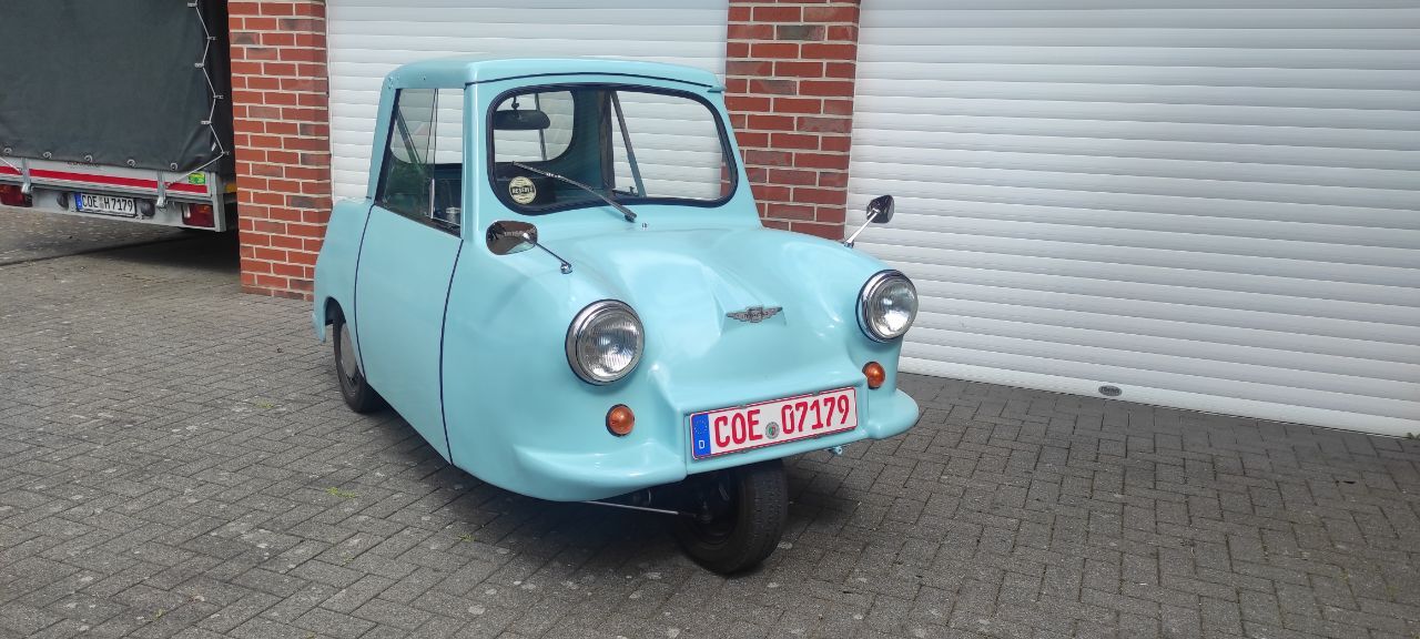

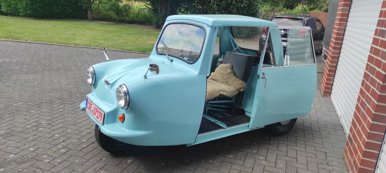

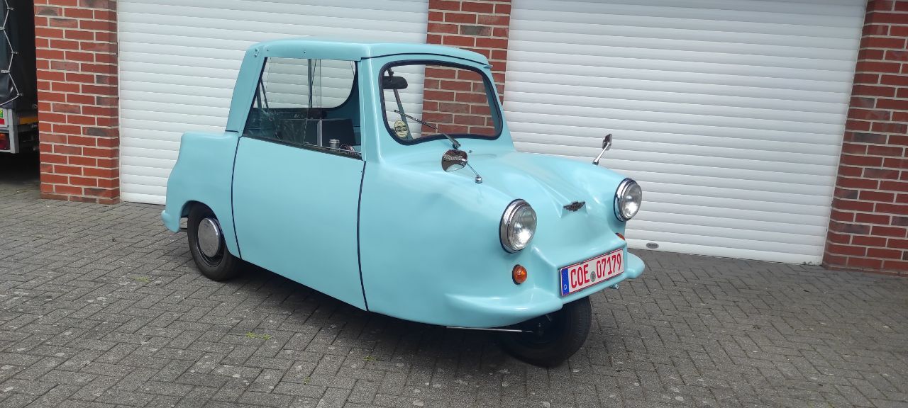

StefanH Posted June 26 Posted June 26 Hello, thank you for your reply last week regarding the shock absorbers in my Invacar MK12E. Maybe it is possible that the weeking ist normal. Think i will drive it like it is. Here pictures of the car a few days ago. Wibble, Carl1981, adw1977 and 16 others 18 1
LightBulbFun Posted June 26 Author Posted June 26 Very Awesome to see HEV once more looking resplendent and very awesome to see that it looks like you did manage to get it registered over there? I think its the first time I have seen an Invacar Mk12E on foreign plates! martc and Wibble 1 1
