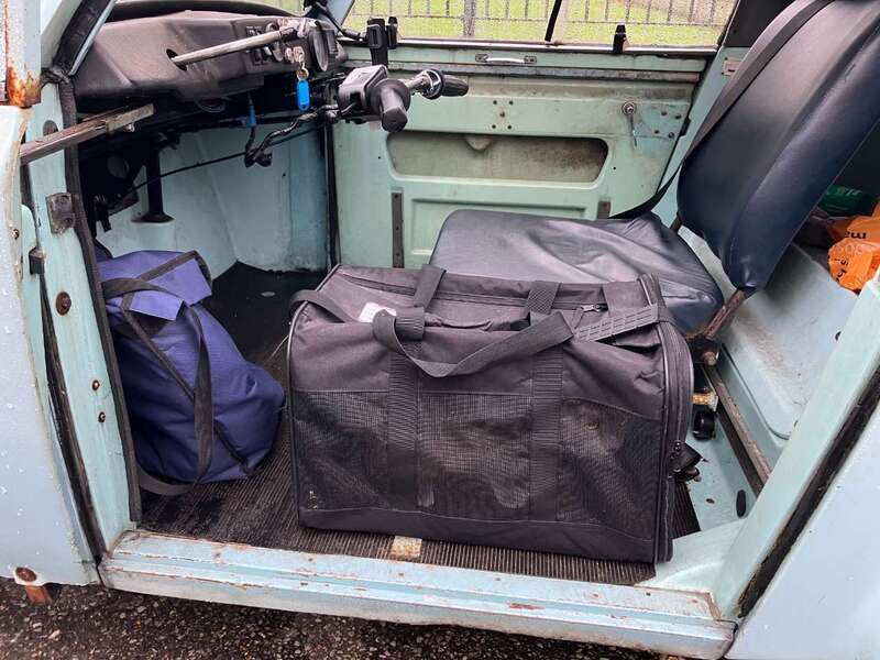

LightBulbFun Posted December 13, 2024 Author Posted December 13, 2024 today was a trip for two! as it was Morris's (my cat) bi-yearly checkup and yearly vaccinations appointment at the vet! thankfully he in his carrier fits nice and snuggly in the folding wheelchair space eventually arrived at the vet, Morris was given a his Jabs and checkover, given a clean bill of health (if not slightly overweight, 5.7kg, meant to be 5Kg, but theres a reason his middle name is "Fat-Bastard" ) and then eventually we were back home Morris did not seem to mind the trip in REV, or not anymore this usually meowing that he does always when he gets taken to the vet! he even settled down and stopped meowing for a bit on the way back all in all I was very pleased to have REV for this trip, without her I would of been a bit snookered, since usually 2 of us take Morris to the vet together, but due to slightly unforeseen circumstances, I was on my own for this trip, and this is exactly why I am very pleased to have my very own Invacar, as Morris is far too heavy for me to lug about the place otherwise! (from previous experience, Uber gets frumpy with you if you have a cat in a bag!) also I have to give props to the vet practice, as they did indeed when I asked about it, call me back and let me have an earlier appointment in the day when they happened to get a cancellation which meant I did not have to do this somewhat sleep deprived in the dark, as the original at 4PM (and my sleep cycle *is* somewhat snookered atm) , and not only that but the lady at the desk saw me pull up outside the Vet and either saw the blue badge or just me struggling about the place, and came outside to take Morris inside for me, and then let me know that there was a loading restriction in addition to the double yellows that i had missed, so I was able to quickly re-park REV before I got a ticket! as an aside, I do need to investigate the fuse box, either clean up the fuses and terminals or replace it for a new blade fuse one, as once again I lost my ignition switched circuit, a bit of twiddling of the fuse got it back again, but its always little bit disquieting losing indicators as your working your way through a busy London junction LOL Dyslexic Viking, Mrs6C, Rust Collector and 12 others 15

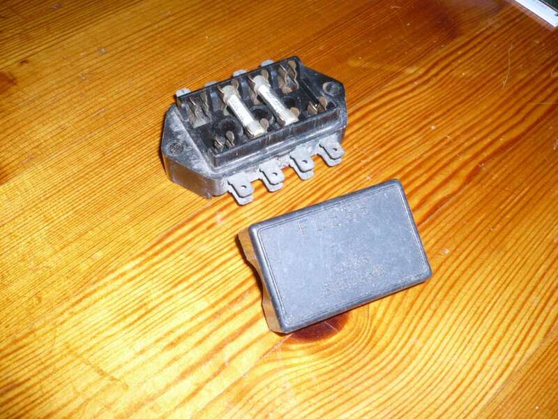

Mr Pastry Posted December 13, 2024 Posted December 13, 2024 8 minutes ago, LightBulbFun said: I do need to investigate the fuse box, either clean up the fuses and terminals or replace it for a new blade fuse one, Is this any use to you? Mrs6C 1
LightBulbFun Posted December 13, 2024 Author Posted December 13, 2024 14 minutes ago, Mr Pastry said: Is this any use to you? sadly I dont think so as REV has a 2 terminal box like this sort https://www.autosparks.co.uk/lucas-2-way-glass-fuse-box I am hoping I can bring it back to life with a bit of fine grit sandpaper on all the contact surfaces and fuses, (but I do wonder out of general curiosity if anyone makes one of the same form factor/footprint, but that takes modern blade fuses?) I appreciate the offer nonetheless however
Yoss Posted December 13, 2024 Posted December 13, 2024 My Triumph has the exact same fuse box (yes even medium size family cars only had two fuses in those days) and it gives me the exact same problems. I sporadically clean it all up and try and squeeze the contacts together without a fuse in to try and tighten the contacts. This works for a while but you know you'll be doing it again soon. LightBulbFun and egg 2

somewhatfoolish Posted December 13, 2024 Posted December 13, 2024 At the risk of stating the obvious £20 for a new fusebox seems less of a ballache than trying to de-gunkify the existing one covered in verdigris? This one isn't much bigger and has LEDs indicating when the smoke has escaped. auntiemaryscanary, Sheefag, bigfella2 and 4 others 5 2
LightBulbFun Posted December 13, 2024 Author Posted December 13, 2024 14 minutes ago, somewhatfoolish said: At the risk of stating the obvious £20 for a new fusebox seems less of a ballache than trying to de-gunkify the existing one covered in verdigris? thats is partly why I was wondering if anyone does a blade fuse equivalent of the same footprint, so I can fit one without having to modify any mountings/drill anymore holes through the bulkhead (tho part of me is tempted to replace it like for like, glass fuses do have a larger contact area then a blade fuse, which is generally a better thing, but then again glass fuses dont grow on trees anymore tho one could always carry a few spares, swings and roundabouts I suppose!) although in typing this I realised to replace the fuse holder I think there is likely going to have a nut on the other side of the bulkhead to undo it, which I am not sure one can actually do on your own? (since you would need to undo the nut/screw from inside the car while holding the nut with a spanner on the other side!) something to look into, but it might well just be easier to see if the existing one will clean up, as trying to replace it might well be a PITA for me... somewhatfoolish 1
somewhatfoolish Posted December 13, 2024 Posted December 13, 2024 Is there a picture of the existing fusebox in its natural environment? In the absence of growing 8' long arms with 4 elbows vice grips can be your friend. LightBulbFun and Rust Collector 2
Mrs6C Posted December 13, 2024 Posted December 13, 2024 3 minutes ago, LightBulbFun said: but then again glass fuses dont grow on trees anymore They don't seem to be in short supply. A quick Google of 'glass fuses' brings up a healthy number of entries, including bulk packs from Halfords! How about taking up @Mr Pastry's offer of the four fuse holder and then you would have a couple of extra opportunities for running fused wires to ancillaries.
LightBulbFun Posted December 13, 2024 Author Posted December 13, 2024 Just now, Mrs6C said: They don't seem to be in short supply. A quick Google of 'glass fuses' brings up a healthy number of entries, including bulk packs from Halfords! proper Lucas ones sadly dont, the ones at Halfords IIRC are non Lucas types, which gets a bit scary, because a "35A" Lucas fuse like the sort used in a Model 70 is only rated for 17A continuous , 35A is its blow rating, but I have seen many people vehicles (including @dollywobbler's own TWC) were someone has replaced it with a non Lucas 35A *continuous* fuse which could lead to a dangerous overload scenario before the fuse blows (35A is more then what the entire Dynastart unit is rated to output) this is something that I do wonder how many people actually realise is something they need to watch out for when it comes to replacing Lucas fuses? (that their rating is their Blow rating not their continuous rating)
somewhatfoolish Posted December 13, 2024 Posted December 13, 2024 If replacing/changing it I can't imagine why you'd stick with glass fuses. While they can be ordered online easily enough it's been a long while since petrol stations or garages routinely carried them and motor factors stare at you like you've just asked for a reacharound. Zelandeth, LightBulbFun, chadders and 2 others 2 3
LightBulbFun Posted December 13, 2024 Author Posted December 13, 2024 1 hour ago, somewhatfoolish said: If replacing/changing it I can't imagine why you'd stick with glass fuses. While they can be ordered online easily enough it's been a long while since petrol stations or garages routinely carried them and motor factors stare at you like you've just asked for a reacharound. which coincidentally is what it feels like I am doing every-time I have to reach under the dashboard and give them a twiddle... egg and somewhatfoolish 2
