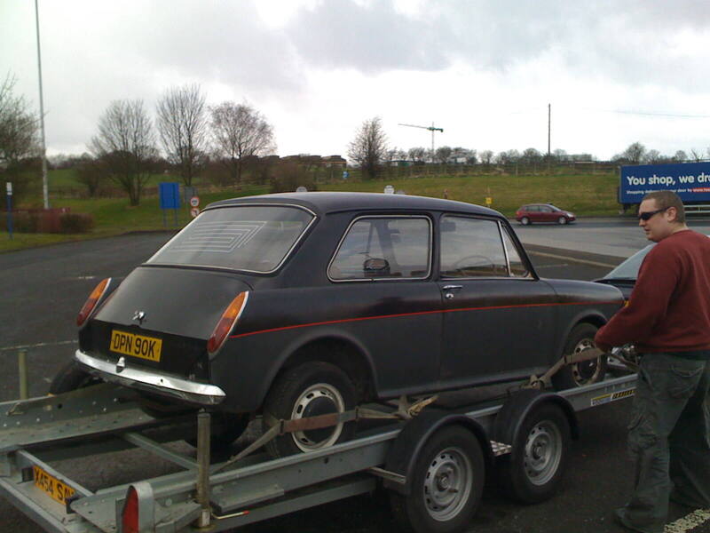

sharley17194 Posted July 6, 2019 Posted July 6, 2019 when i first picked her up! danthecapriman, loserone, LightBulbFun and 3 others 5 1
SiC Posted July 6, 2019 Author Posted July 6, 2019 24 minutes ago, sharley17194 said: when i first picked her up! You could repeat this scene once again if you wanted to have her back! What happened to the rear screen heater? You can still see where it was on the rear screen.
