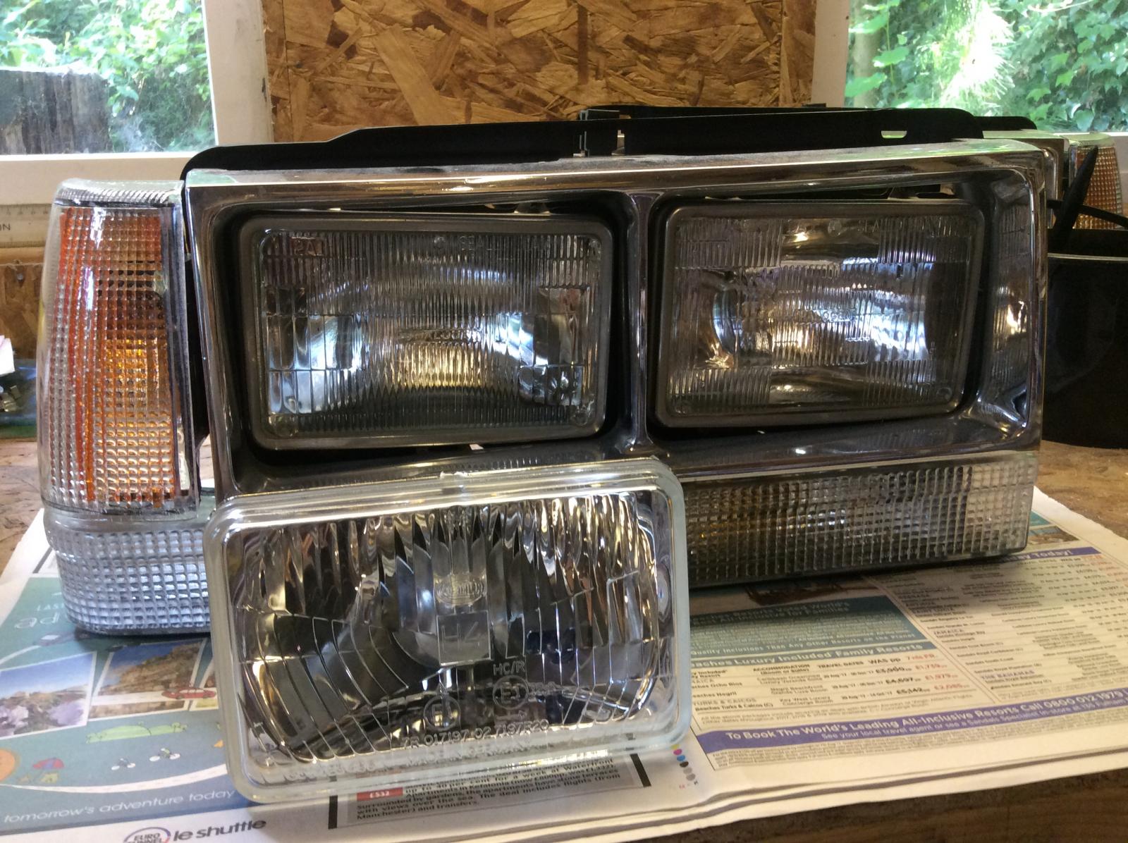

https://www.ebay.co.uk/itm/161753196982
These are the RHD rectangular headlight units American cars tend to need. These ones contain the combined sidelight bulb holder and socket.
You can then use a standard H4 headlight bulb, use the built in sidelight unit which gives you white light.
Then simply use the existing indicator with amber bulbs as the indicator only.
Remove the sidelight wires from your combined indicator lamp, reroute them to the new headlight mounted sidelight.
These are the above headlights being fitted to my US Volvo headlight units. You can see the sidelight in one of the pics.
Potential new layout?

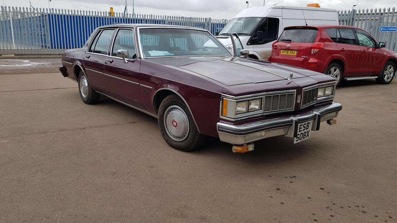

Damn good result on the MoT though
Brilliant result on the MOT
confused though as it must have had a test or two here previously, maybe a more relaxed tester in those cases?

I mentioned that to the tester. Last mot was 2016. He said it should have failed.

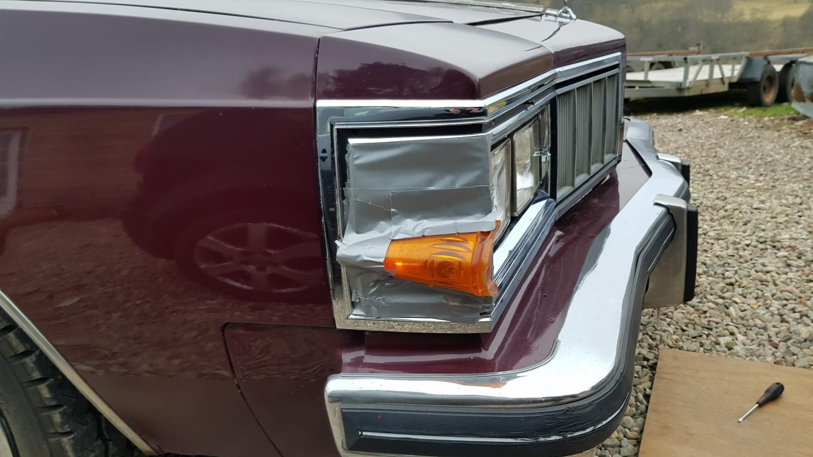

I've been messing about with some spare parts so that I might get a pass while I'm waiting on those lights dan linked to arriving.
I think I've missed my vocation as a car designer. Going for a bit of yank meets commie with these Moskvich parts.
I wonder what the MoT man would say if I turned up with this modification?
Only joking.
I'm halfway through fixing a bracket to the bumper for a slightly more secure temporary fix.

In an effort to warm up relations with the Russians, I brought communist and American representatives to the negotiating table. Through intermediaries, Vlad gave the go ahead for the Moskvich lights to provide forward indication for the Yank machine.
It might be an ugly marriage of convenience and will no doubt be short lived, but the temporary arrangements have seen the big oil burner pass its test.post-5582-0-57096200-1523131637_thumb.jpg
