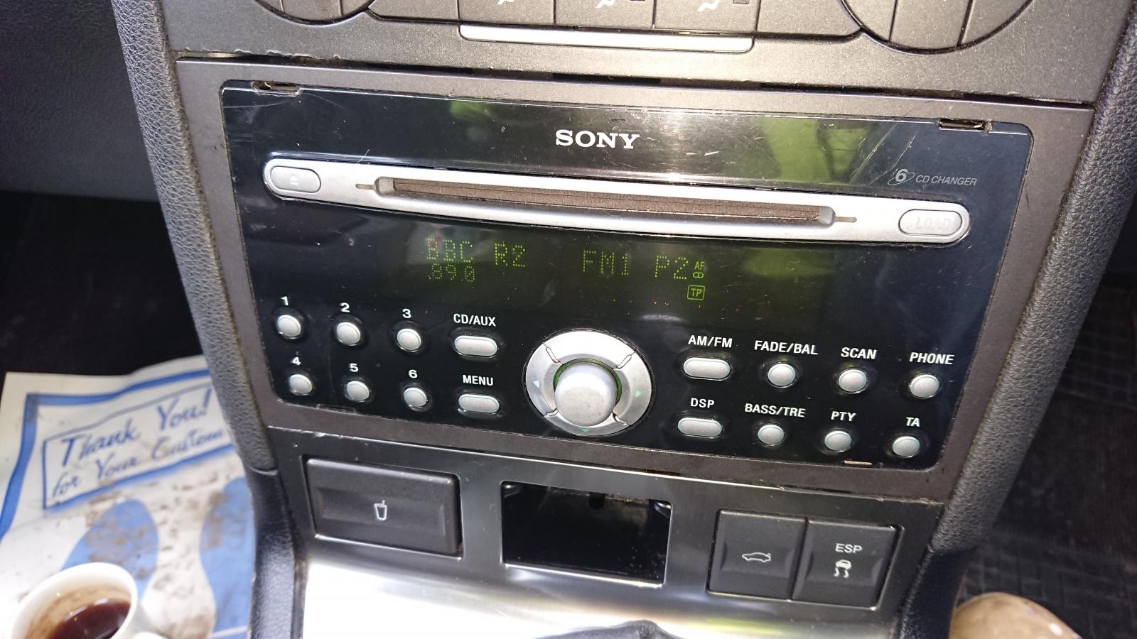

Questions for the masses: How do i get the radio code and / or second key without applying for a second mortgage? Is there a schreechy they all do that sir for the engine?
Don’t know about keys but the internet will yield a code, quite possibly even gratis, if you pull out the radio and get the serial number.

Radio keys ordered to remove radio, to get serial number, to get code, which will be cheap or free. Keys due Thursday. (Place your bets).

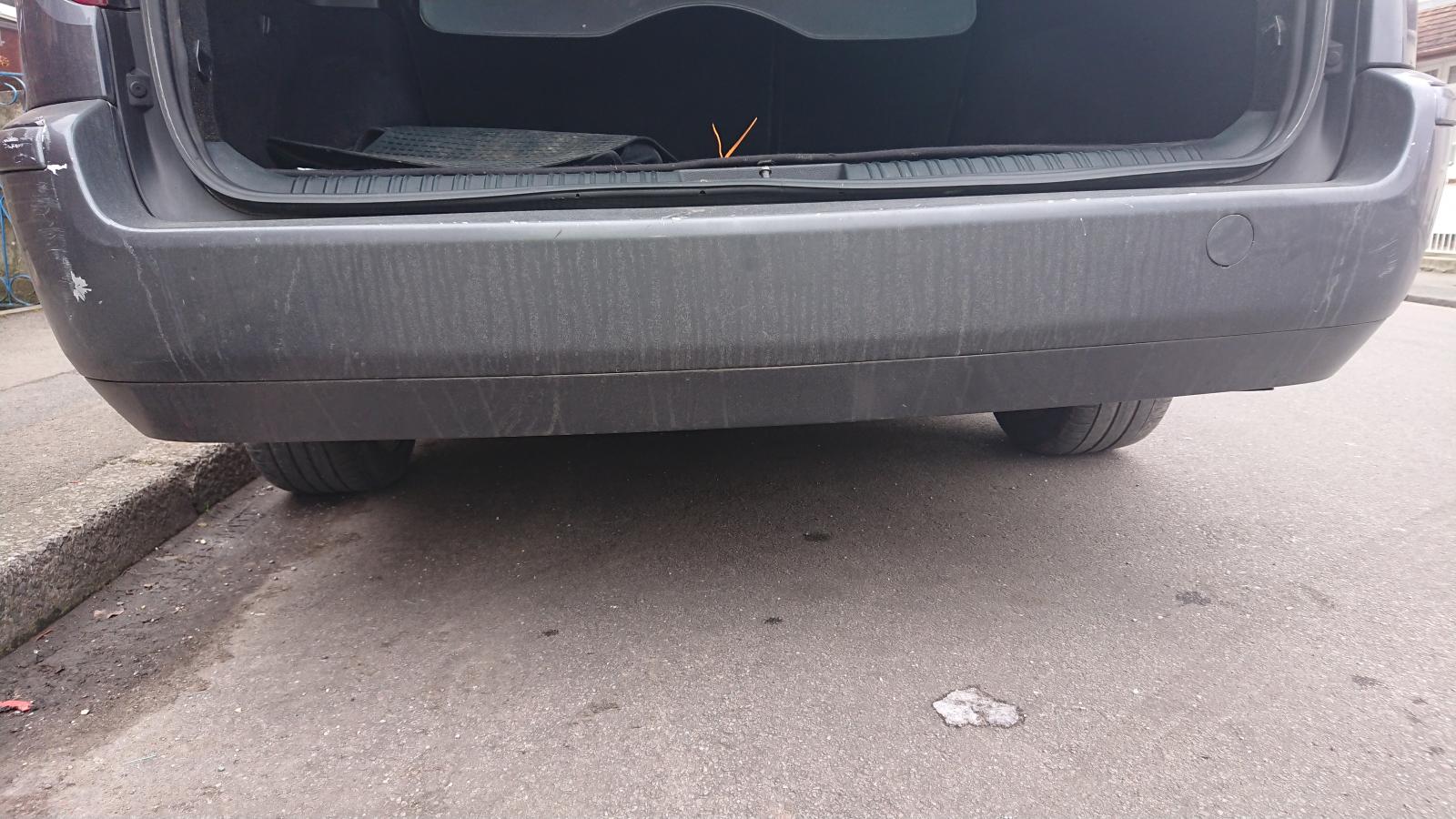

Parking sensors are broke and just emit a constant tone. Internet says that happens, I will attempt fix later.

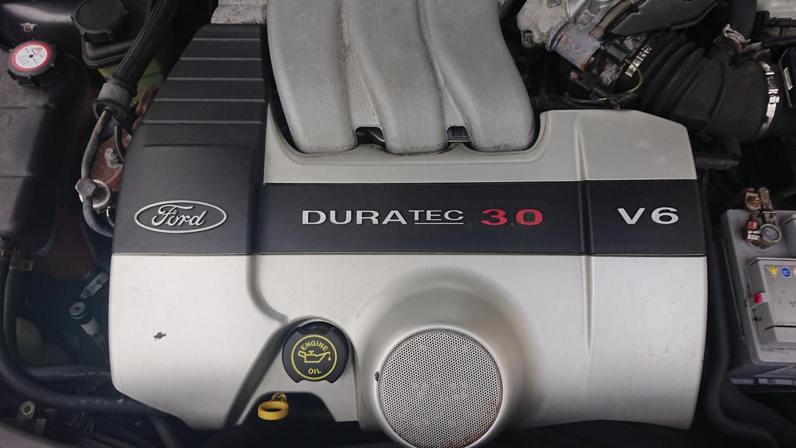

Have had time to play today.
Second key acquired from the local locksmiff. (80 quid). But it is a new key, rather than a clone, so other keys can be added at will. Which, following the advice above, should be considerably cheaper.
Radio keys from ebay arrived so popped them in and pulled the head unit to get the serial number.
Whoever you are, thank you you sensible person you. I do stuff like this all the time and I hope it makes people as happy as it makes me if they ever find it.
Pumped up the chooons on a drive and stereo is better than adequate and no speakers are blown (yet). Good.

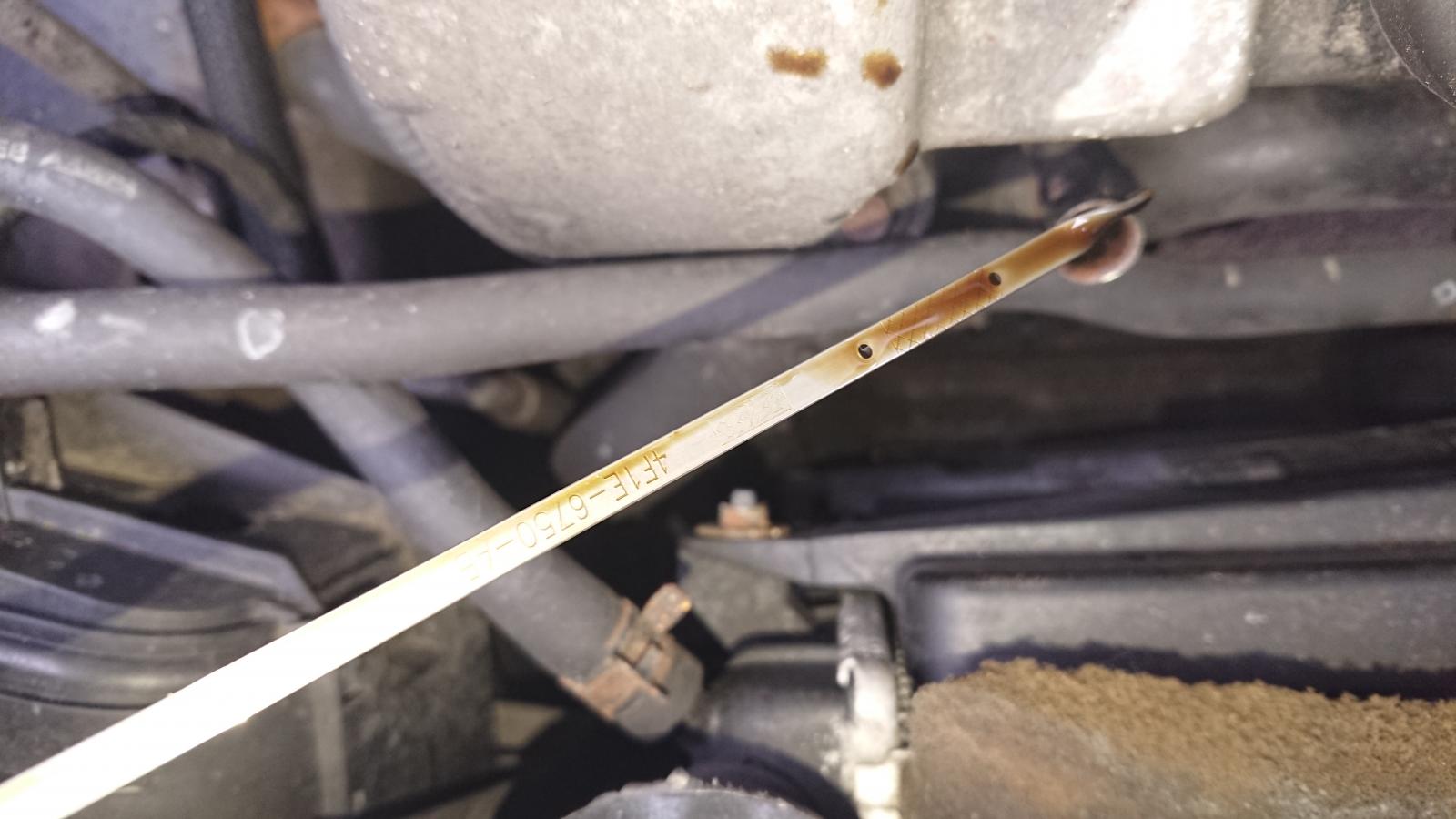

Next question is has it ever been serviced?
Oil looked recentish. Certainly not black and lumpy.

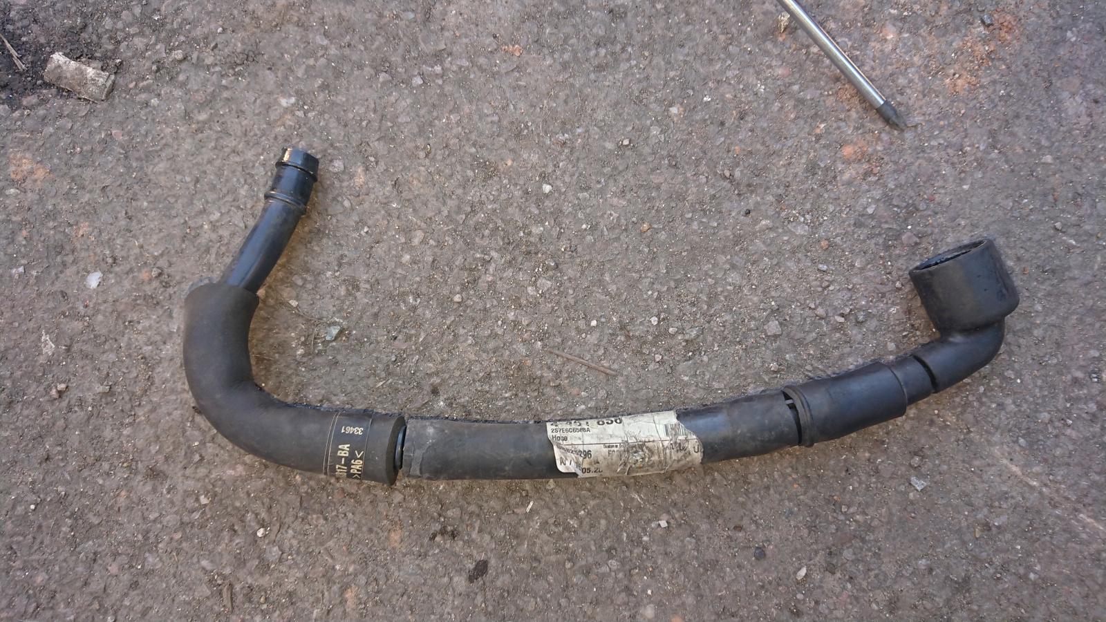

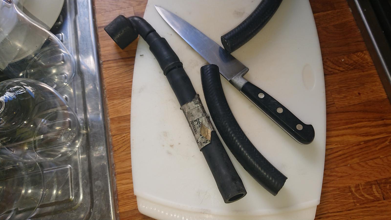

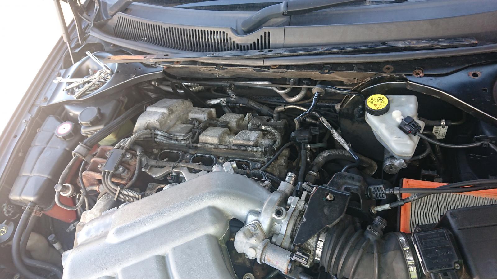

I started it and it made the noise, so bimbled round to the mechanic. On revving and in particular on the sink back down there is a rhythmic weird goose honk crossed with ghost whhooooooooohhhhh. He looked and listened, said he'd never heard the like and then said "everythings a fucking tight fit in there isn't it not sure i'll work on that one". Which was reassuring. Equally, although loud it doesn't sound life threatening in any way so we are still at drive it until something happens and then see.

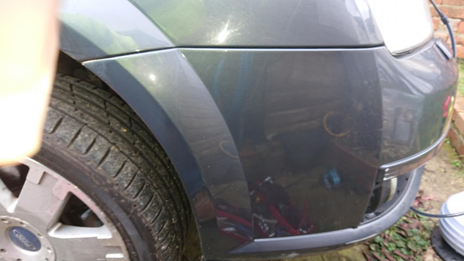

Next up, Parking sensors. Put it in reverse and there is a solid warning tone. "Parking sensor duff" says the internet. Easy.
Impressively flush fitting parking sensors aren't they. Can't see where they are at all.
A quick look behind...

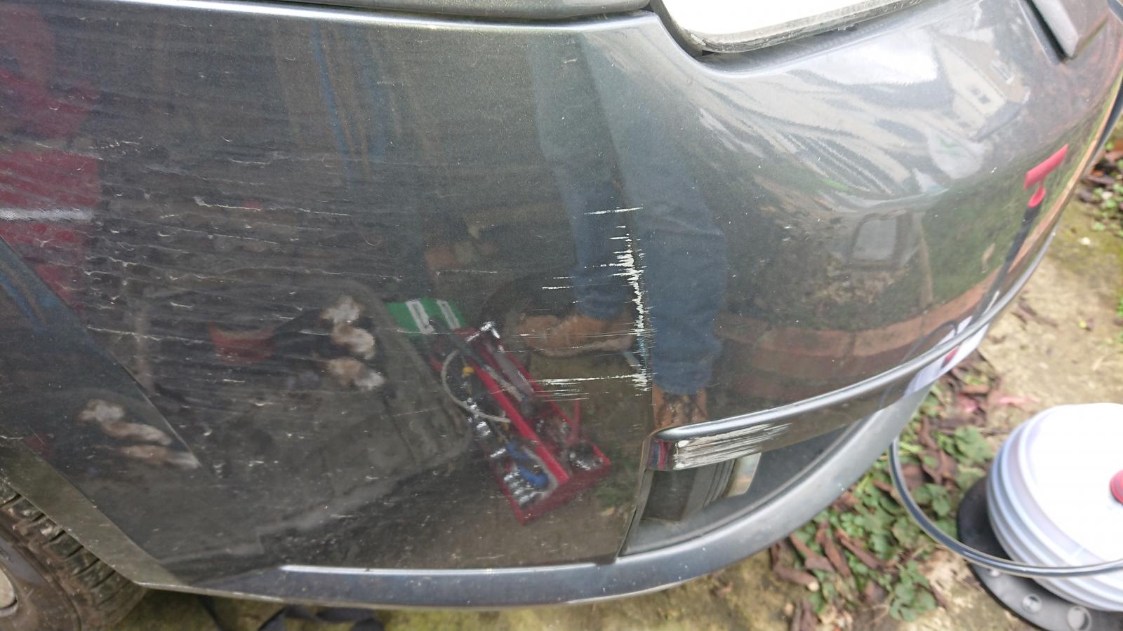

Bastard. That'll be the cat c bumper then. Um, anyone breaking one of these with parking sensors? While we are at it I need a towbar as well please.
That does sound like the crank breather pipe has collapsed and split. TADTS; mine had, though it didn't make any noise and didn't seem to affect the running. I spotted mine while I had the upper inlet manifold off to change the plugs (which also didn't need doing, but meh). The official pipe is 30 quid or something; being a tightwad I just pulled the (pathetic) bit of Ford rubber off the two plastic ends of it and cut a piece of (much more substantial feeling) 5/8" radiator hose to fit, total cost three quid from the motor factor down the road including the two jubilee clips I used to make sure it was secure.
The inlet manifold is a bit of a pig to get off, you have to grub about between it and the bulkhead as there's a pipe secured to it back there. Removing the brace bar bit under the wipers makes that a bit easier, only two bolts to pull it out, so would recommend doing that. Can probably do the job in <2 hours. A magnetic retriever would probably save a lot of swearing if you drop one of the nuts, though miraculously enough I didn't.

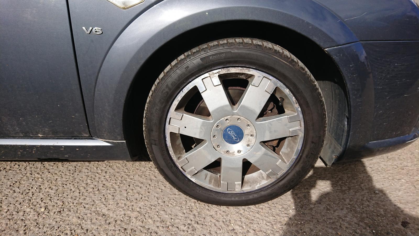

New* shoes and alignment check.
Goes in a straight line now. Huzzah.

Farty hose replacement it is then. Inlet manifold off
Farty hose acquired. Not split but brittle and stiff as a vicar
Some kitchen butchery (much warmer) and replacement with some heater hose.
Refitting is the reverse of removal. Except I managed to trap a wire so it all had to come off again to free it.

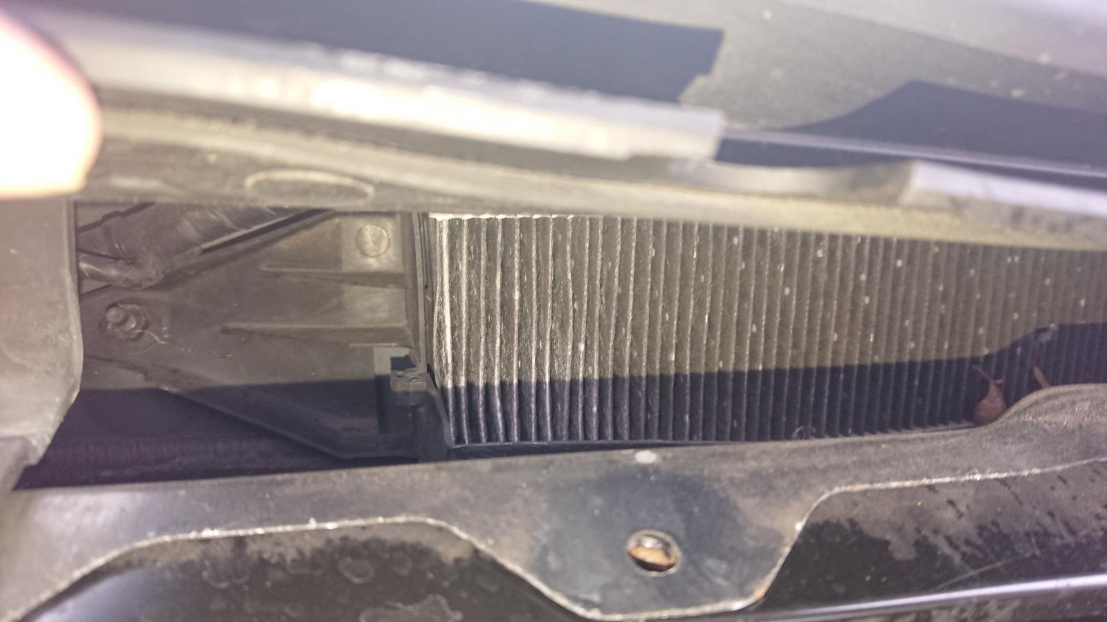

New air filter, cabin filter more closely inspected and now rated as gopping. I thought it was a charcoal one. Turns out it's just filthy. I banged it out and will replace, probably in the autumn knowing me.
And it started and idled with no drama after. Always nice when you've been up to your elbows in something you need tomorrow.
Feel kinda remiss pointing it out at this stage, but that pipe can be replaced without removing the UIM
Good practice for when you do the plugs though..
if you are lacking gingercators on the front, its an orange cap that can be removed in about 2 seconds..usually done to get rid of the 'fried egg' look of orange bulbs in the front
As I put it back together I reached that conclusion. On the way in though I was unsure which pipe it was. As you say, good practice and bonding.

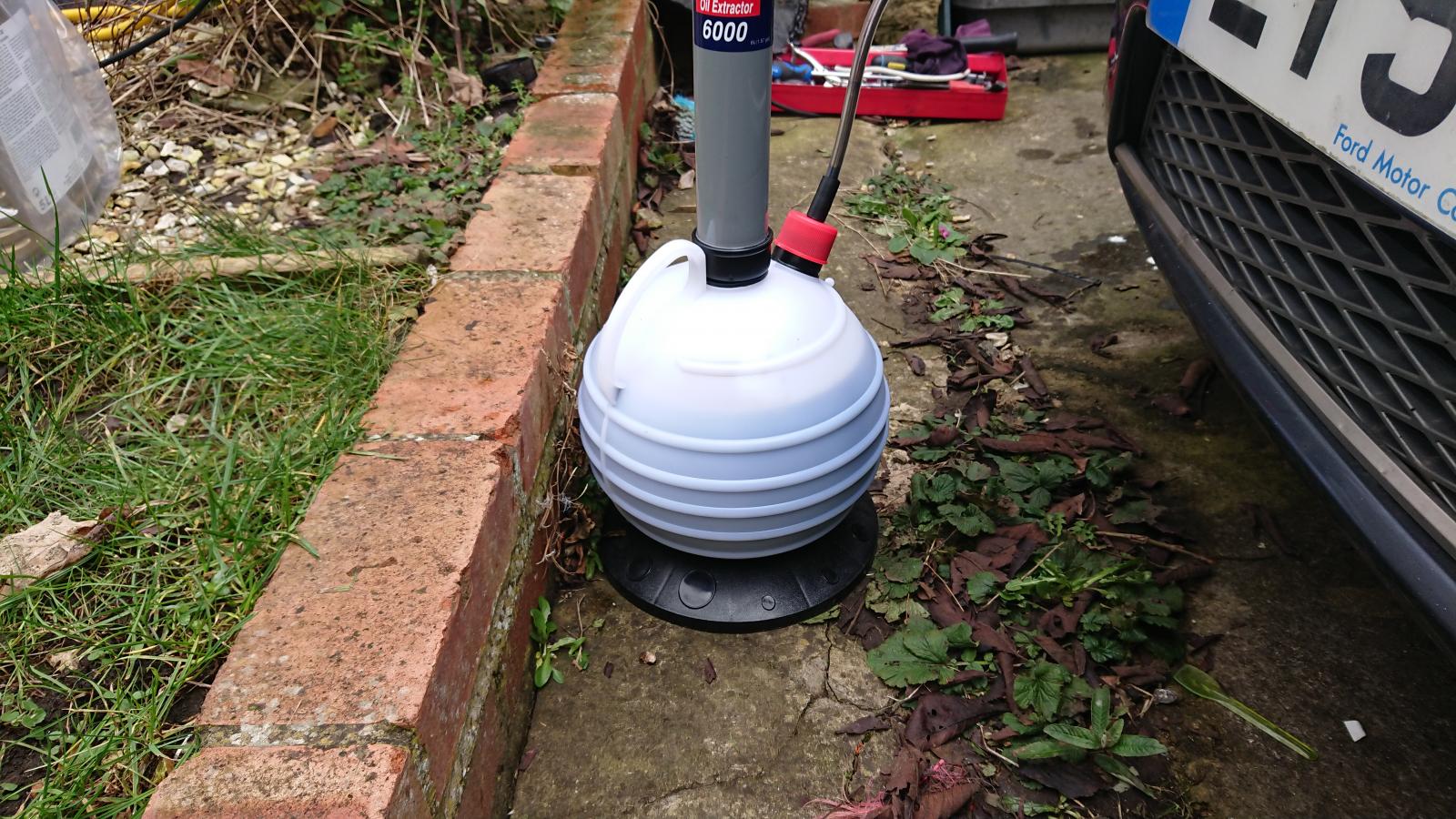

Time appeared today to play with my new pela. Assume the position.
Do the filter which was remarkably easy. Situated at the front in the middle. Just a shame there is too much radiator in the way to get to it from the top, I still had to lie on the floor to get to it. Seeing as I broke my arse sledging in OMGSNOKAOS that still posed some discomfort.
I hadn’t really warmed it up, so the oil was thick, so the pela was very slow. So after a cup of tea idle control valve off and sprayed with electrical contact cleaner.
Just cos really. It’s always improved anything I’ve done it to.
Pela still sucking. So break out the t cut and turn this
Into this
Which was worth doing.
Pela done
New oil in and jobs a goodun. Very easy to pour from the pela into the waste pot.
Was the sum total of the mess, (all from the filter) which for me is a fucking miracle.
