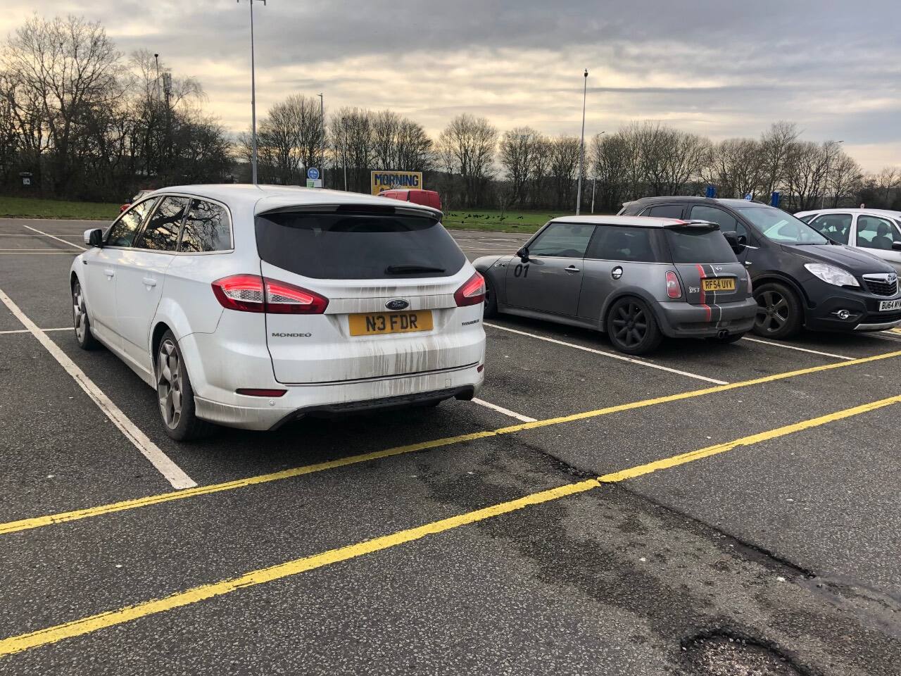

The racing mondeo soaked up 545 miles today at 47mpg whilst collecting the new racing mini. What a great car it is for cruising
