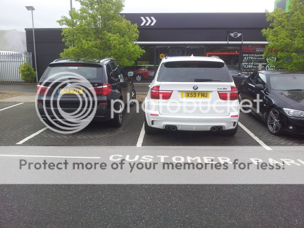

collected my sister after dropping her x5 at bmw dealers for them to look at possible leak..
she parks errr well.....

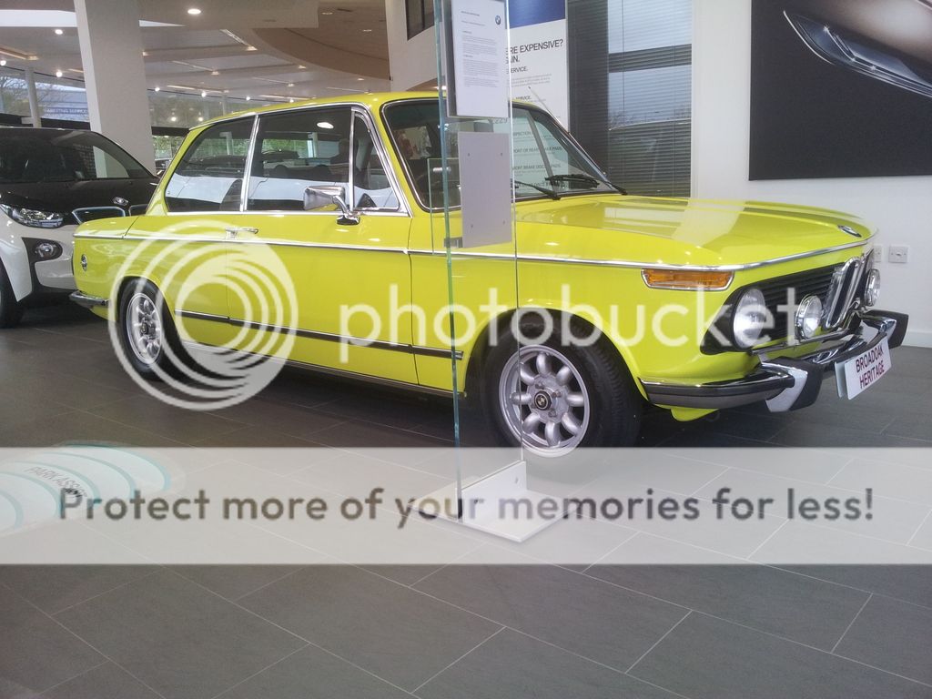

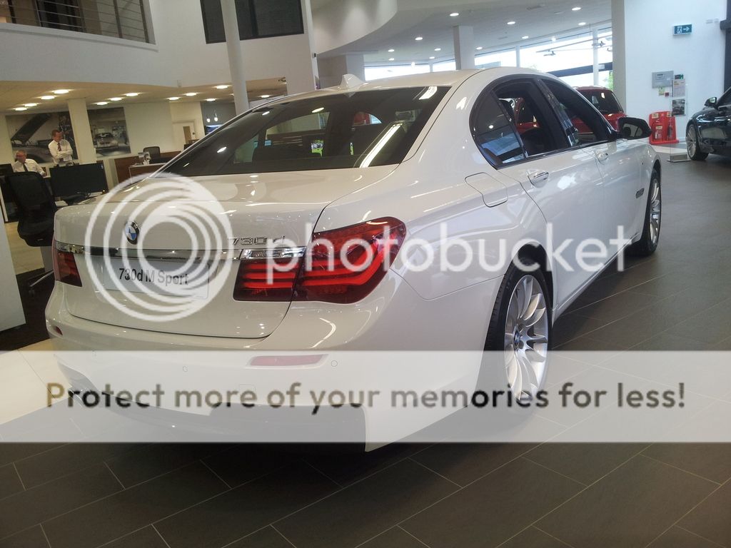

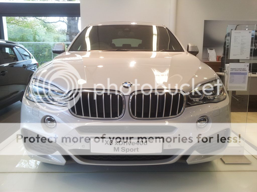

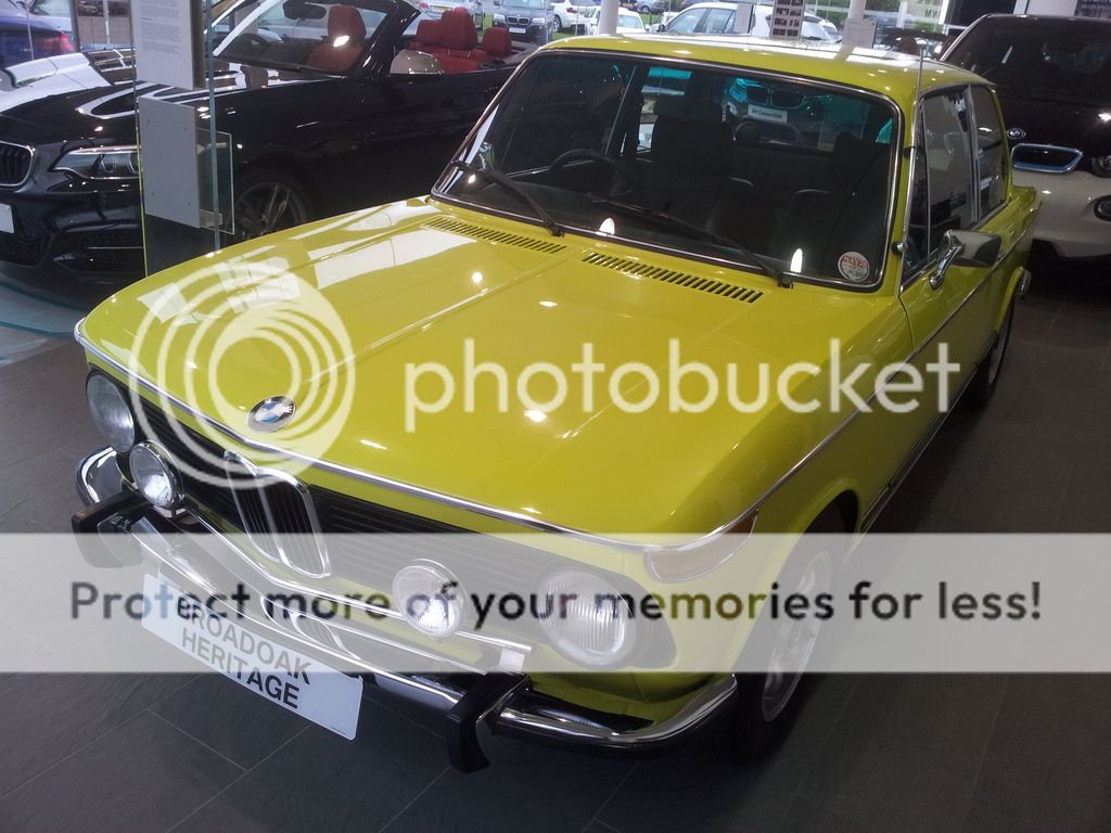

prices are lil high...
did like grey x6
this was mashoosive
but this was  nicest in corner

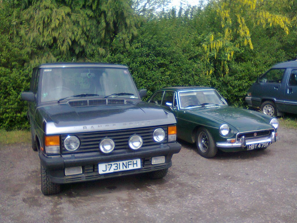

I had forgotten how nice to drive these old Range Rovers are especially when you are not paying for the petrol. Today I took my friends RR for MOT to the garage that has done leaf spring bushes on my MGB GT that was ready for collection.
