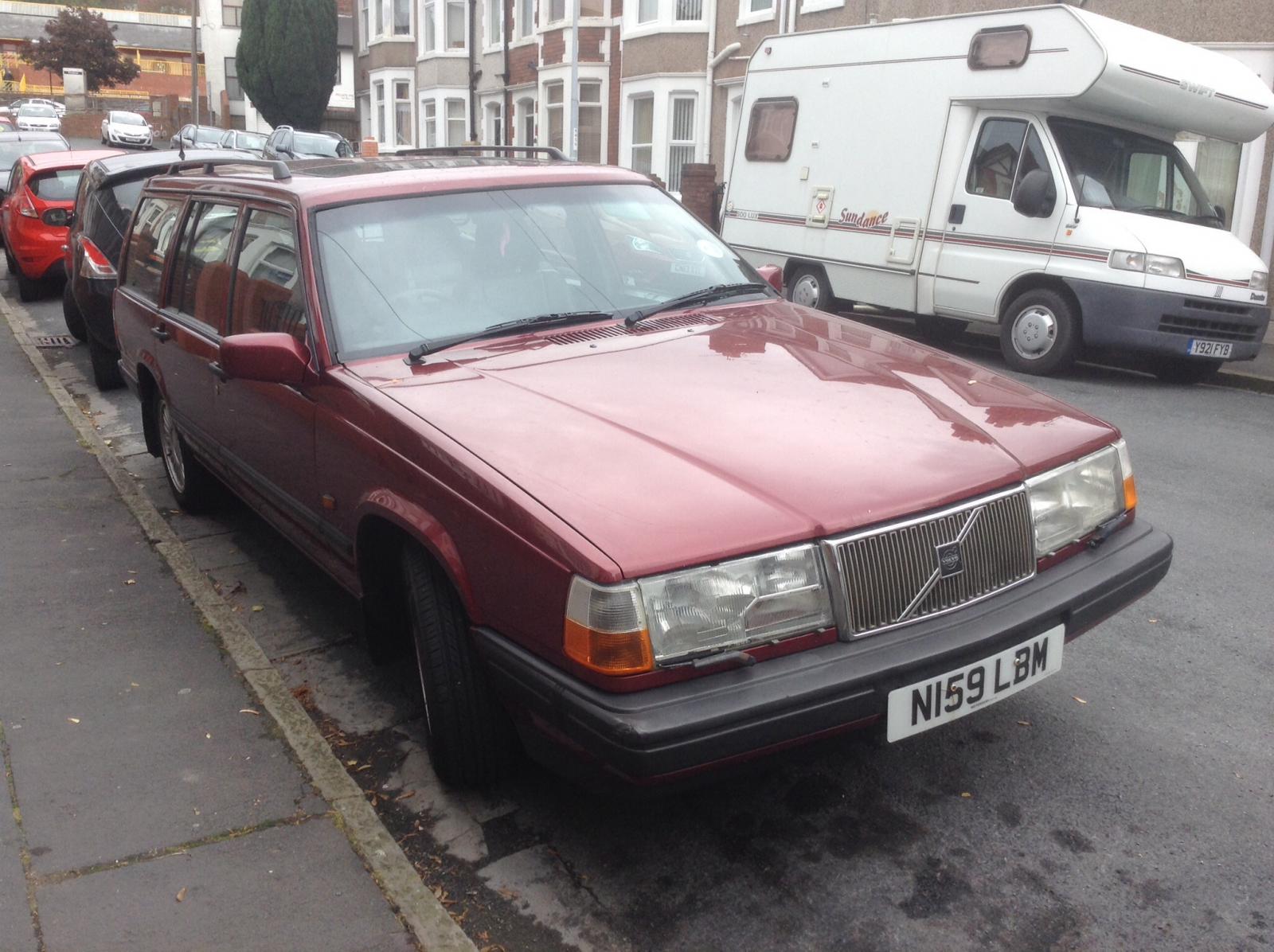

My everyday volvo, 20 years old, 248k. I took it to halfords for a £29 MOT.
Bugger me, it passed! Not even an advisory. Bloke said it was in better Nick than a lot of the newer stuff he sees.
Result!

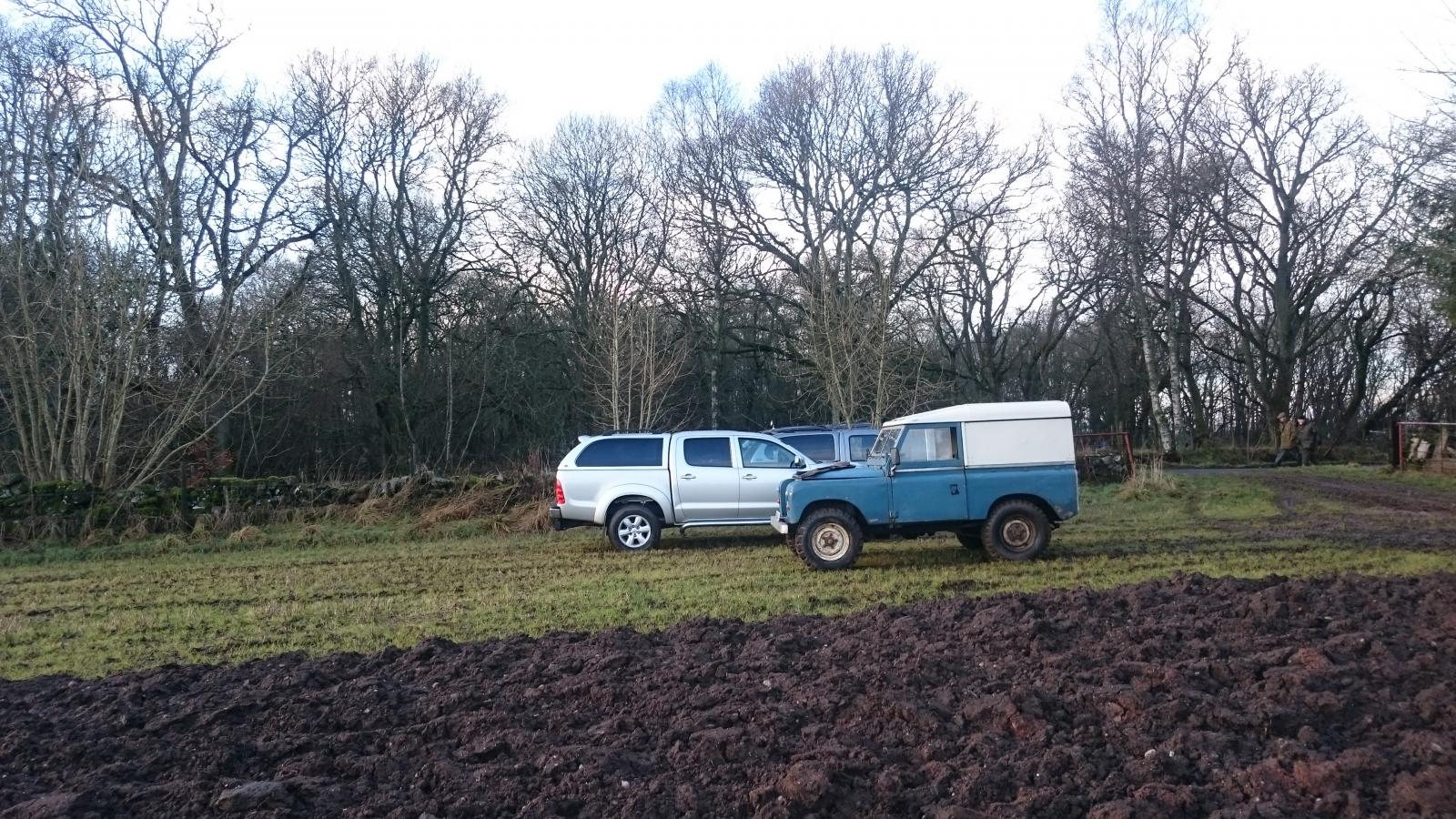

The hilux had to be pushed out of that flat field thanks to its road tyres
