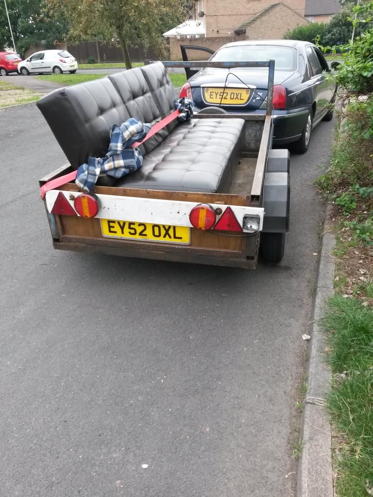

Not much driving the rover 75 and trailer to return a sofa bed back to work...
