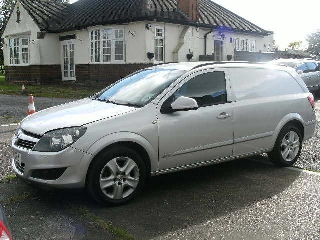

Been with my old man to get a new van today.
All vaxhalls r shit etc etc
http://www.ebay.co.uk/itm/2011-Vauxhall-Astra-Sportive-CDTi-Van-6Speed-/271480323426?pt=UK_Commercial_Trucks&hash=item3f357cfd62
These drive lovely, and his old 54 astra van had done 230+k and still ran ace, bloke didnt even have a look inside it or start it up and gave 900 quid px for it. Got some izuzu herritage in the 1.7cdti's I believe and probably no better than the fiat lumps. Had a ace history so he got it bought.

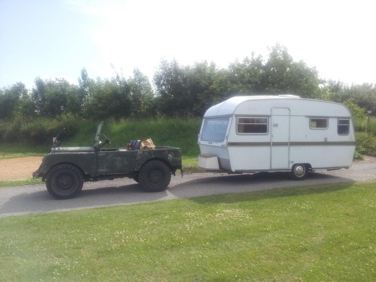

Been helping the missus sort out the caravan - it's a 70s Thomson and she has repainted the inside and made a selection of new cupboards etc.
I have to say, the old Landy is not the ideal towing weapon!! Really must find the time (and cash) to MoT my Range Rover before July at the latest.
Need to sort some of the wiring out, and get a new pair of tyres. The brakes and lights all work a treat which was a relief.

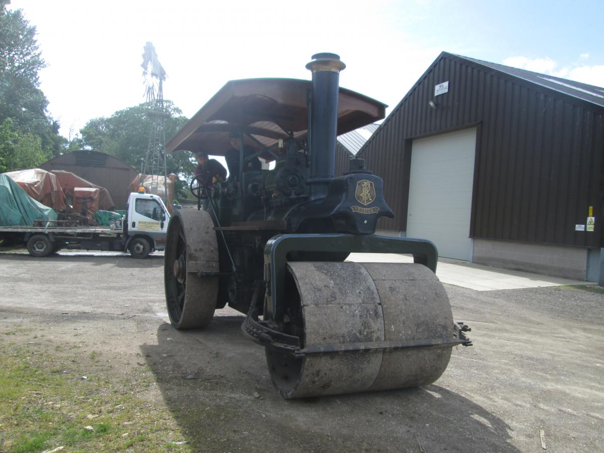

Yesterday I tidied the yard of my friends - who allow me to keep various junk there - up with the roller, which has been tucked up at the back of the barn for four years. No problems at all though. 102 years old and still capable of doing what it was built for.  :-)
