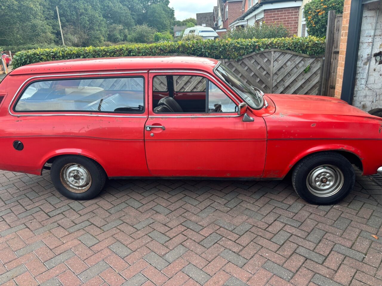

pulled this out the garage today, got the lights working, re -aligned the bonnet lights and grill, stripped and cleaned the carb now need to drop the fuel tank as it’s full of yellow stale petrol, job for next weekend maybe.
Will probably have more motivation when the Logbook arrives
