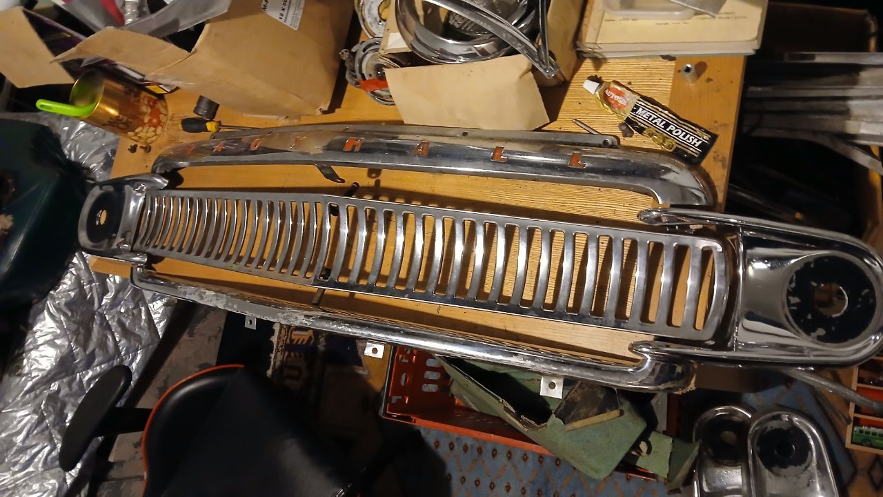

Going through my box of Cresta bits to try and assemble a decent front grille assembly...
