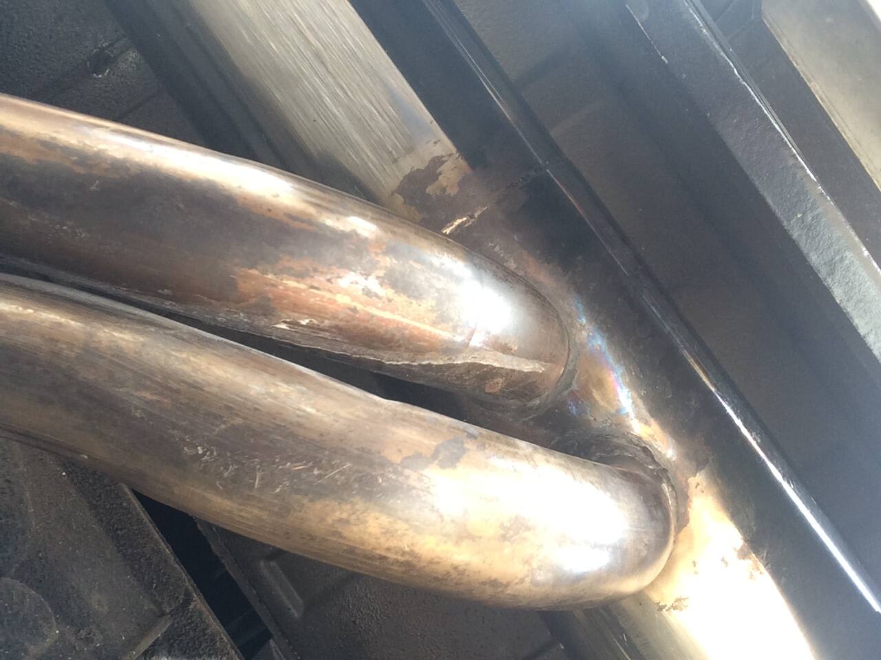

The x1/9 now has a shiny stainless exhaust. Not too difficult (for my friend) to fit. Sounds good too- not loud or tinny. Not got it out on the road yet though as the weather is awful. It sits a lot higher up under the floor than the old one, fills most of the width too with the pipes entering from underneath but still above the lowest point of the chassis /gearbox mount.

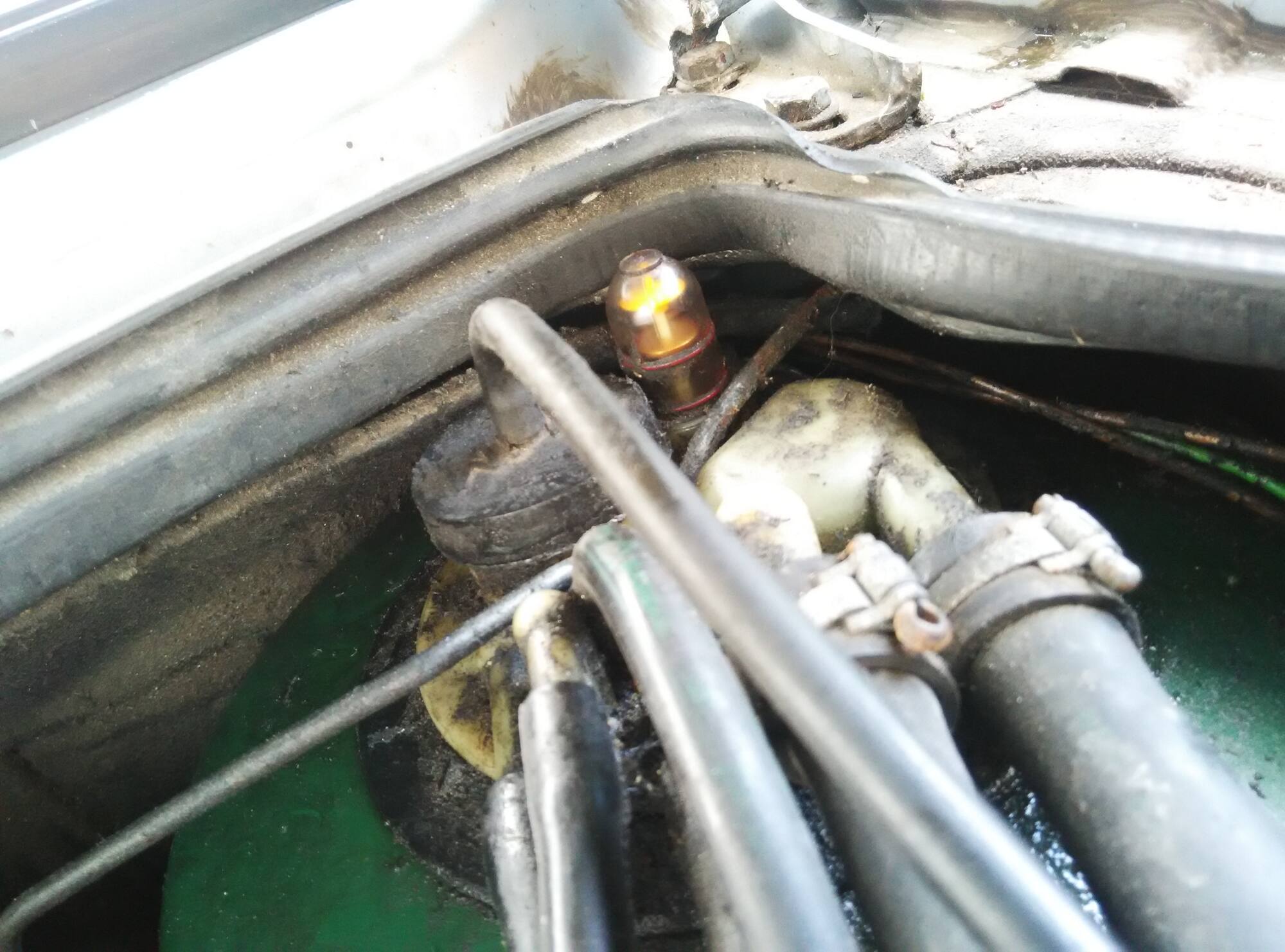

Managed to plug two leads into the back of the LHM float sensor. The build-up of greasy grime in this area over the years is unreal.IMG_20190810_162628.thumb.jpg.82718a98a615195760147404417ddb7e.jpg

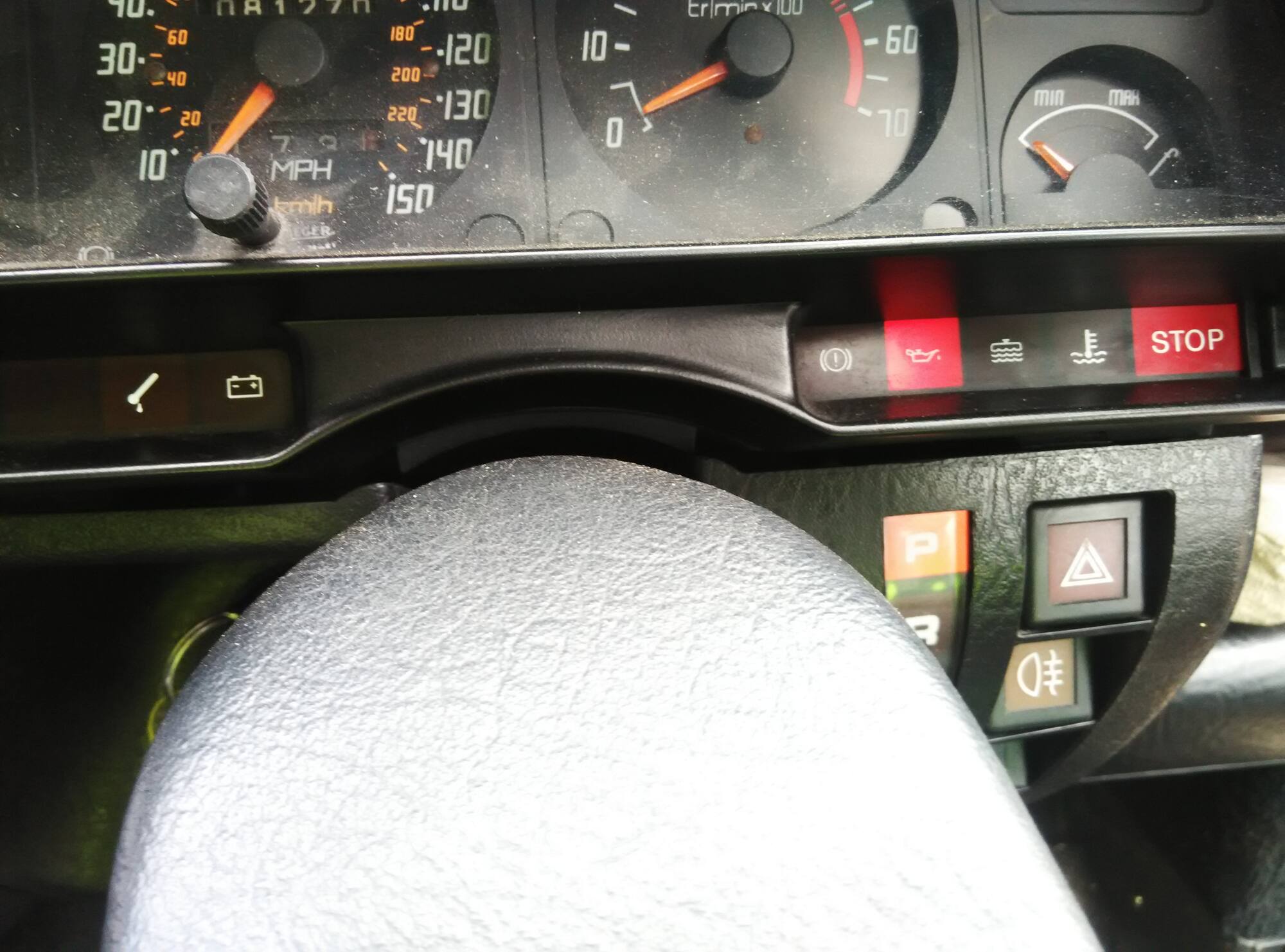

Meanwhile, some warning lights have gone AWOL when I turn the key without starting the engine. Puzzled as they all work when I press the test button....
I think the test button just tests the bulbs, not the function of the sensor. So, if the bulbs work, must be a fault at the other end.

Just now, Tadhg Tiogar said:
There are loads of other ends....
Well, check one at a time :-)
my cxs we’re generally electrically very good bar the odd relay connection. But the last was in 2006. Which warning bulbs have you lost? Could it be a fuse?
All fuses intact. Handbrake, battery, coolant tank and overheat warning are missing.
Handbrake is the switch under the centre console, probably sticky contact if you don’t use it much being an auto. Coolant is contact under the bottle direct to the sensor ( gets wet), battery could be the small exciter spade  connection to the back. overheat I don’t know.
If the battery light isn't working, there is a good possibility it's not charging. Most cars use the bulb as an indicator and a resistor to provide a voltage to get the field coils going on the alternator.
I don't use the handbrake at all, only parking brake and footbrake. Probably needs readjusting anyway as a result.
Small exciter spade connection....hmmm...now that you mention it, I have seen a green wire with a spade connector hanging loose in that general area, and I've long wondered what it was for and where it was supposed to be plugged into.....
The alternator is a new exchange unit and it definitely works, otherwise the battery (also new) would be flat after a few trips.
9 minutes ago, GBJ said:
Why not?
Because CX handbrakes are frequently shite, and mine is no exception.
Not surprising if you don't use it.
Still, why bother, eh? So long as you're happy.
Actually they get shitter the more you use them.  The cables stretch and there's no adjustment mechanism to speak of.
To be fair, readjusting it (which these cars seem to require at regular intervals) isn't the easiest so I've kind of left it as it is.... ....and this handy Norwegian CX guide only slightly simplifies the process.
The MoT tester may fail it this year (he sort of blanked it last year) for that reason, so it will have to be done again.
