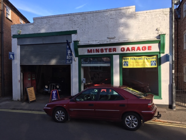

Well, I've kinda settled into a 'Just drive it' routine in the last few months.  Sorted it out with some new rubber a whiles ago, got a wee pipe replaced on the rear when it wet itself in the green way, but otherwise there's been a lot of 'whooshing' to and from work going on in general.
I had however been largely ignoring a growing set of 'clonks' from the front end - albeit rather muffled and softened by the green liquid scenario.
But, I finally got the fear and decided on blowing some paycheck.  The car felt like it was worth it.  So, off I trundled to the local garage near work.

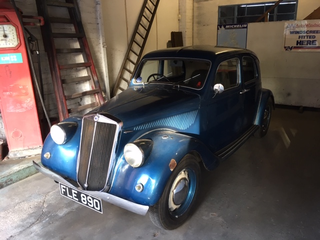

It's worthy of a pic or two.
What's that hiding in there?
Mmmmm....cracker wee Lancia like....
And in behind the glass?  Any two wheel lickers care to I.D. it?
So a day and 220 clams later, I was furnished with new ball joints and TRE action.
Wow.  The difference is palpable.  Whooshing just got whooshier.  Looking forward to getting it properly serviced (overdue) now when clams permit.

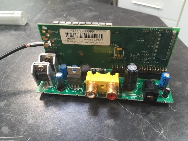

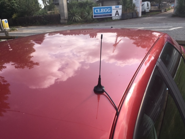

I went to a car boot sale the other month (as is my wont), and picked up a wee household DAB radio for 40p. "Amazing" sez I.
Took it home and mothballed it, as I had no real need for another. Picked it up again a while ago and had a look at it. "Ah" sez I. "it's only 7v". "Oh, wait a minute, I'm sure I have an old Goodmans car charger (for a now defunct cd player) which i found in a skip that's also 7v".
And so a seed is sown.
Here is the dab radio in question. Matsui brand and very SMOLL. Easily gotten on ebay BTW.

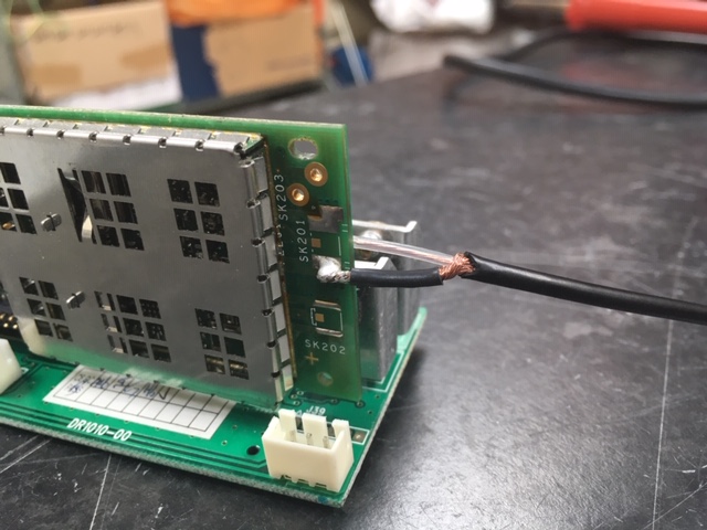

Had a wee look on ebay, and got an external car DAB aerial with a magnetic base for £2 (post paid) from a VERY FAR AWAY PLACE.
Which arrived a month or so later. Nice long lead on it.
Chopped the connector off the end of it and got my soldering iron out.
Whilst I was at it, I re-soldered and fixed the secondary (and defunct) 12v socket in the car.

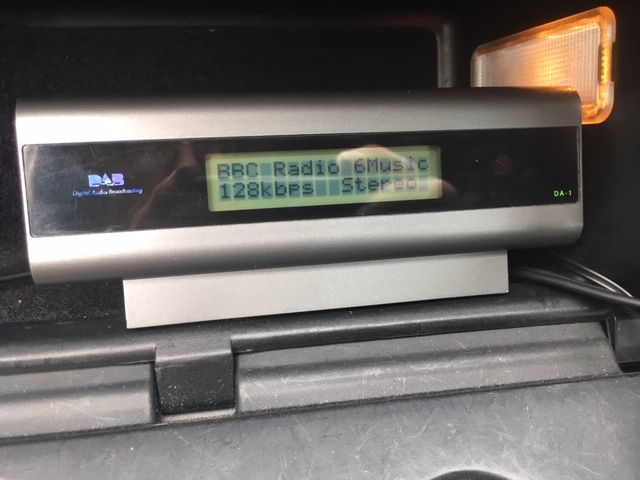

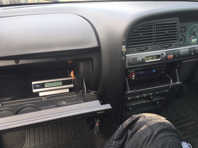

All back together again and velcroed into the glove box.
Audio out from the RCAs on the back and directly into the 3.5 Aux on the front of the stereo.
Wires all tucked away nicely behind dash and seals etc.
WORKS A DINGER LIKE!!
Happy days.
Reception is ace no matter how far into the wilds I get.
Recommended bodge for all Radio 6 listeners.
