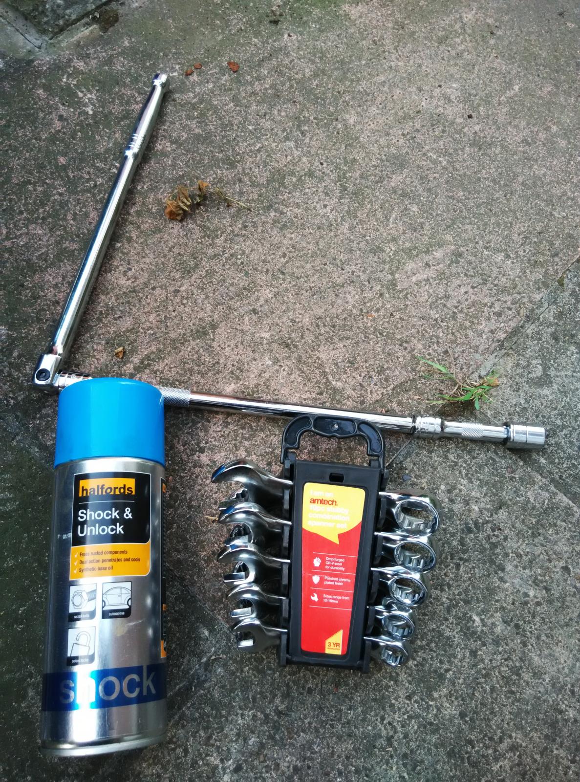

Due to the idiosyncrasies of Citroën battery positioning, I have been out spending on tools that are apparently necessary to extract a battery from a CX.... and which, naturally, I didn't have to hand. Let's see...
£10 on a Halfrauds socket extension bar
£13 on a set of 10 Amtech stubby spanners, only three of which I actually used
and £7 on a multimeter.
So that's twenty-three quid just to get a battery out. It's now in the shed, being recharged on an ancient Halfrauds 11amp trickle charger. Should be at full power by some time next week....

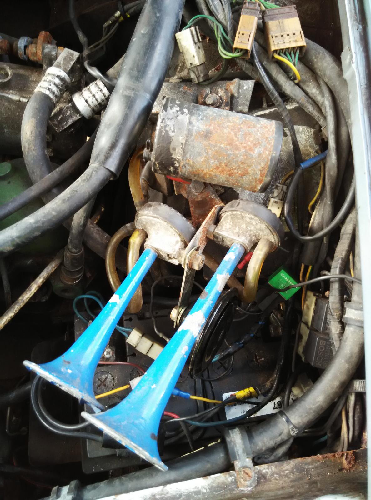

With the CX battery being flat, it would have to be extracted from under this lot:
Realise that you're not going to have access with the basic socket set, so mitch off to spend a tenner on an extension long enough to clear the battery, and splash out on a set of ten stubby spanners (only three of which you'll actually use, but your friendly* motor factors assure you it's cheaper (£13) to buy the set than the three individual spanners at six quid each):
Then realise, on getting back from the factors, that nothing's coming out unless you first unbolt and remove the air horns and compressor. This turns out to be the only easy bit of the job:
Note that the whole horn thing's looking a bit fucked after thirty years, but we'll deal with that later. The extended socket proves only just long enough to clear the battery and undo the two bolts on the retaining plate.....which looks well past its best:
Fish out the 13mm stubby spanner to undo the negative terminal clamp next to the wing. Scrape your skin getting your hand in there to lift clamp away. Then fish out 11mm spanner to undo positive terminal clamp and lift away. Somehow lever out battery from underneath Citroen comedy cabling:

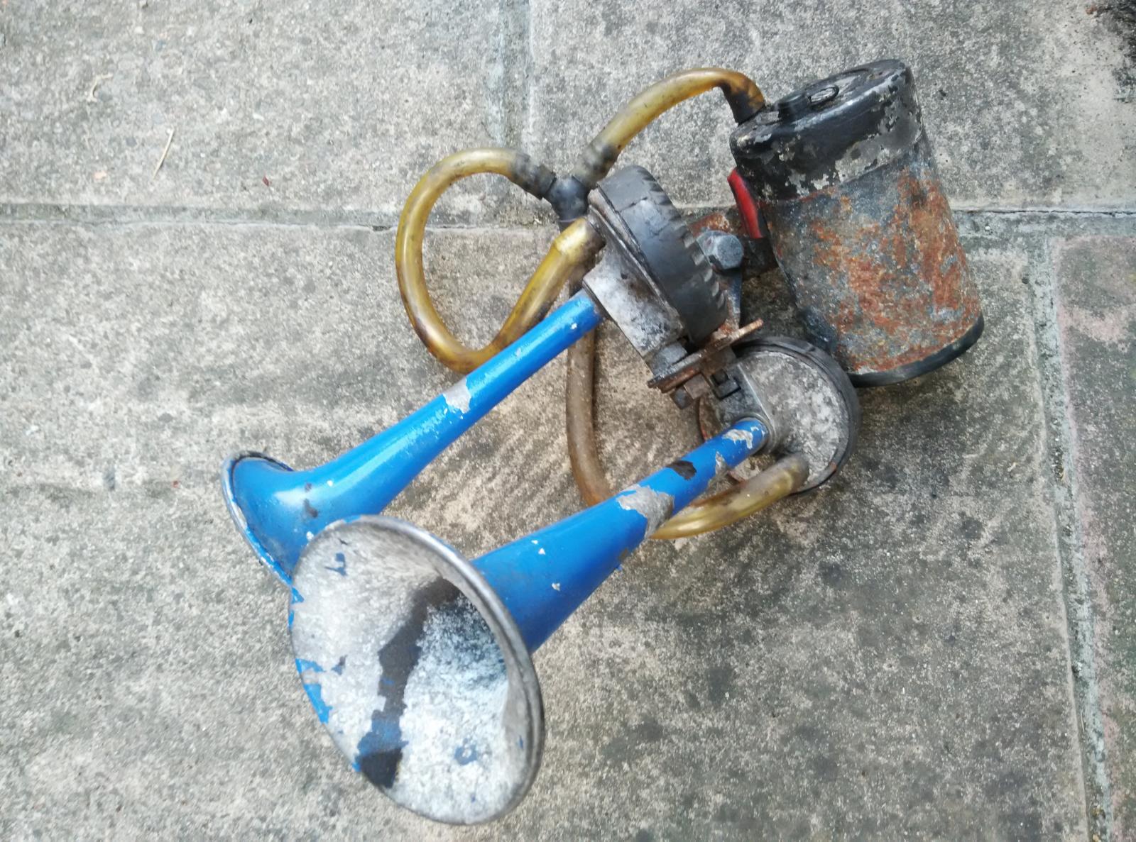

The horns. They looked fucked, so I took them apart and cleaned off the corrosion:
The compressor, on the other hand, looked like it had led a hard life:
After a brief struggle with corroded screw heads, it broke down into this:
It's just a big multipole electric motor. Actually, the armature and commutators didn't look that bad, and only needed a wipe with a kitchen towel:
The motor brushes looked like they hadn't seen much action either:
Hopefully this should all work again once the motor has been tested*
