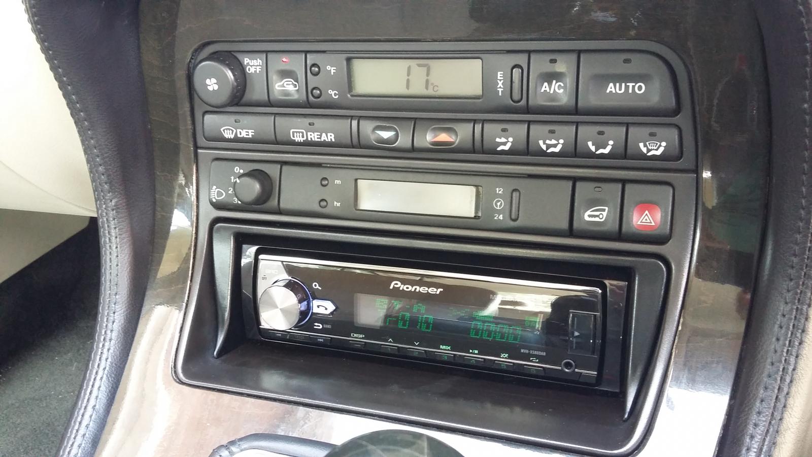

  • Spotify Premium: for £10 a month I can put together playlists, albums, etc on my PC, then easily download the lot onto my phone (up to ~3300 sings).
  • New head unit: Pioneer MVH-X580DAB.  Mechless with DAB, it's a simple bluetooth connection to the phone which allows me to access those albums and playlists offline.  All controlled from the head unit so I can leave the phone in my pocket.  Subdued design so it doesn't jar too much with the rest of the dash.
  • Upgraded front speakers:  I chose Focal ISC165s as they had good reviews, are reasonably priced and fairly slim.  Jaguar used some obscure speaker size so I had to lash up some adaptor rings using uPVC soffit board (unlike MDF it's waterproof, doesn't produce potentially hazardous dust and is easy to work with).
  • Underseat subwoofer: Pioneer TS-WX120A.
That whole lot came to just under £350, which seems fairly reasonable; ICE used to be much more expensive but I suppose the market for this kind of kit is rapidly diminishing.  Certainly all those small, expensive car audio shops every town used to have seem to have disappeared.

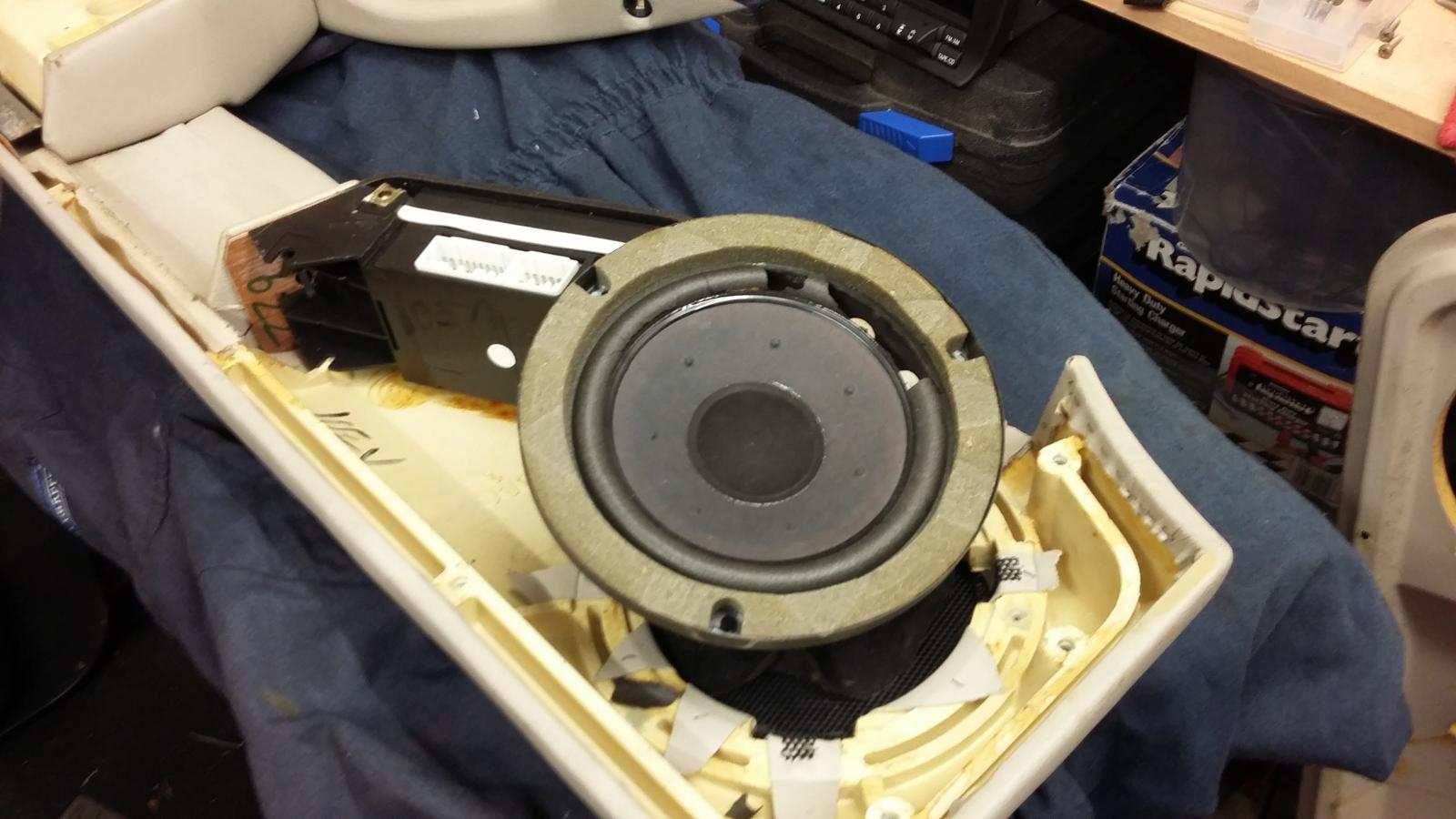

The problem with the original speakers became apparent when I removed the door cards:

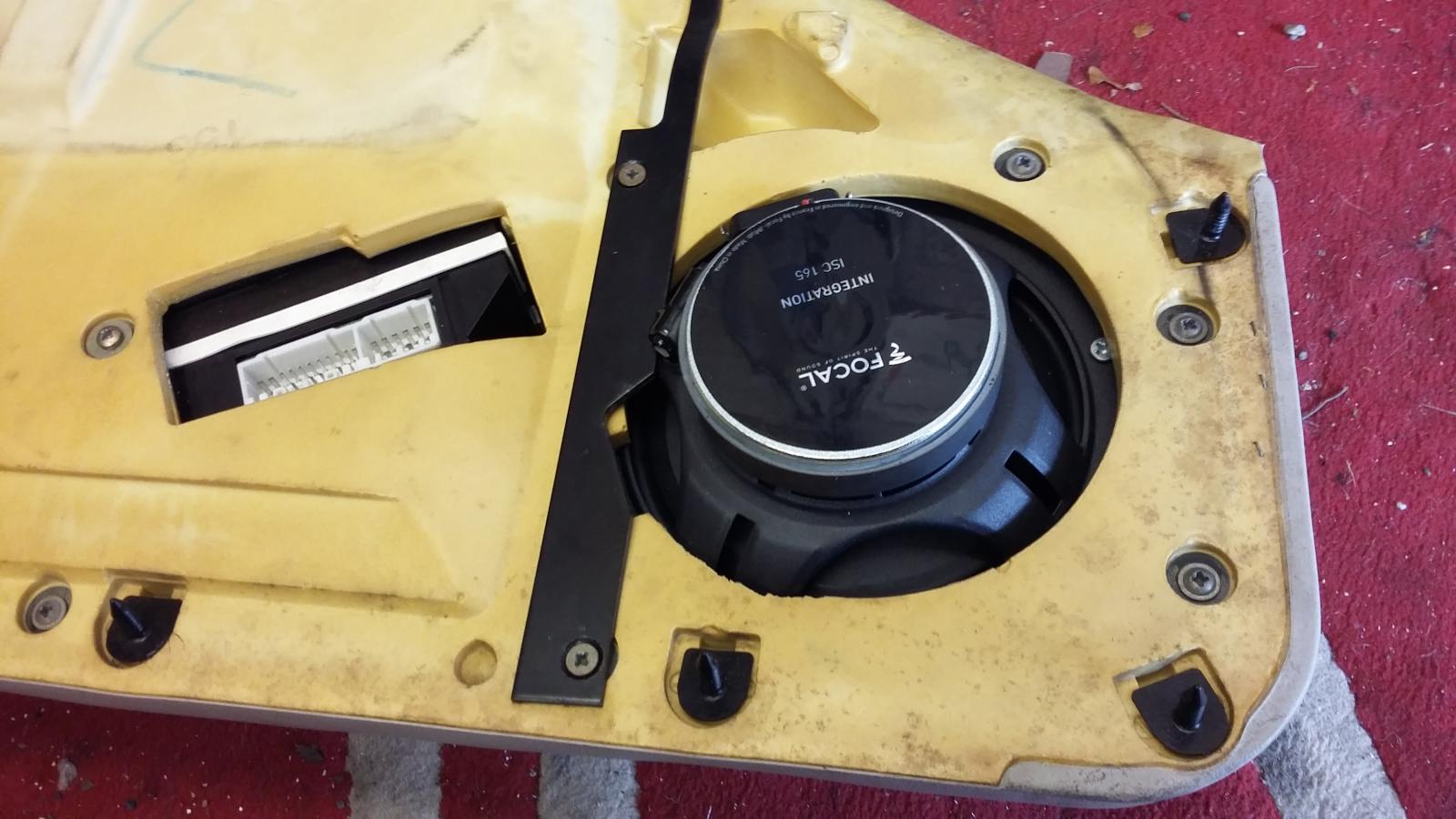

New speakers are quite a snug fit and I had to cut a little foam away.

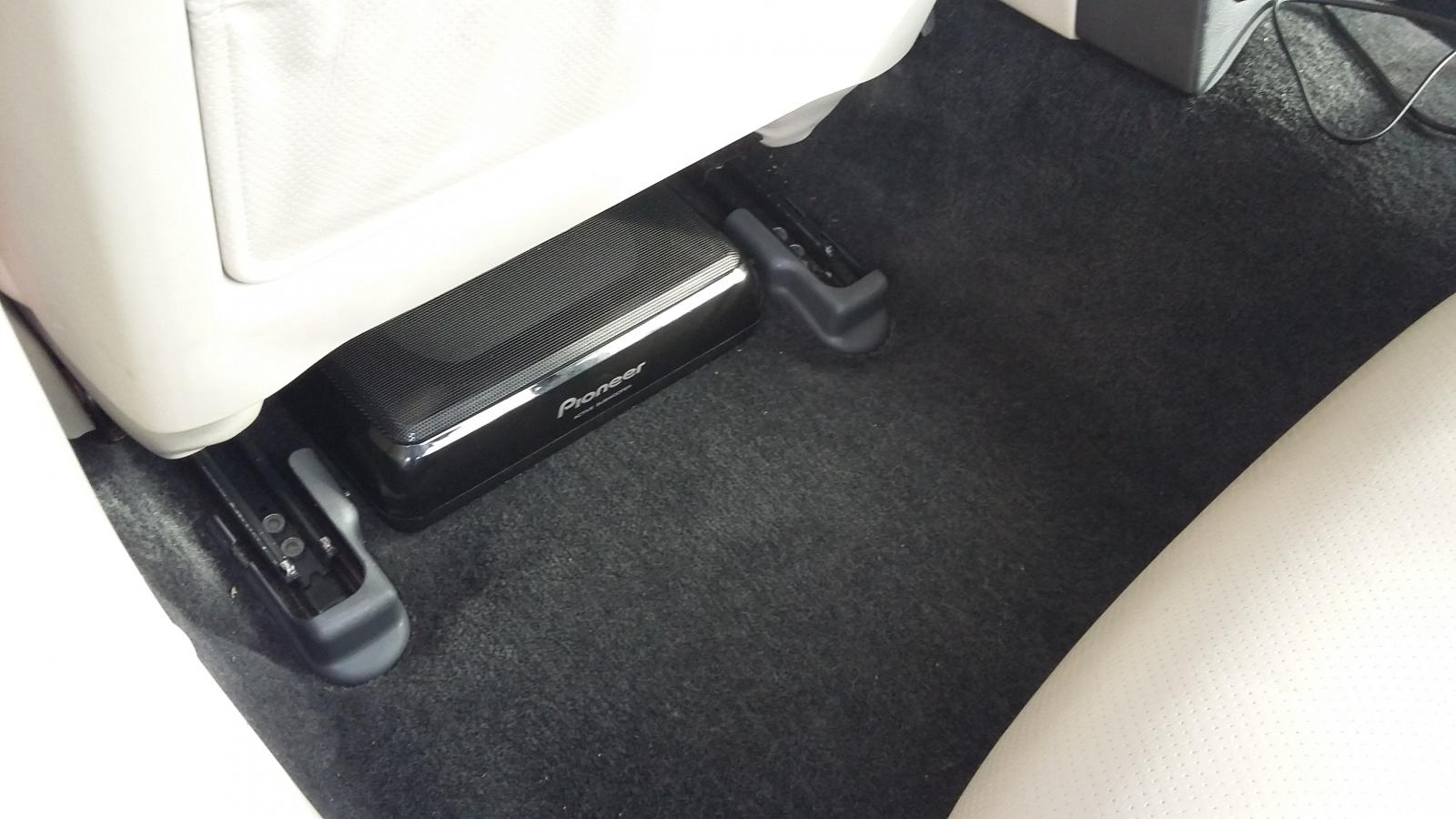

The sub fits neatly beneath the passenger seat.  In this photo the seat is fully forward, normally it can't be seen but it does steal a few inches of toe room for the rear passenger - but then a SWB XJ6 is a 17 foot-long 2-seater anyway...

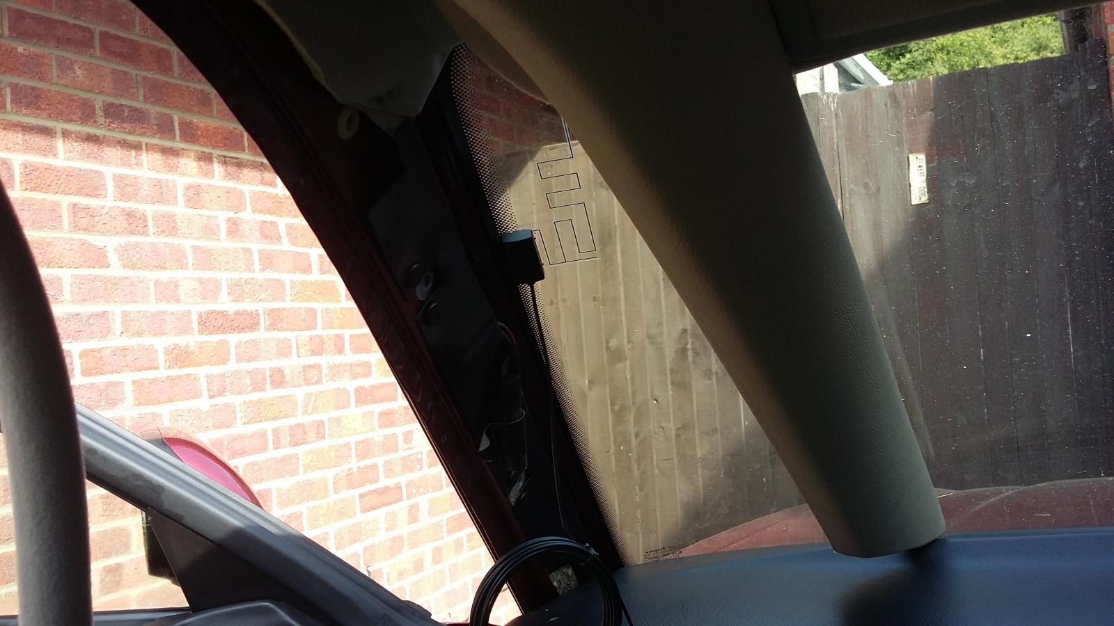

A stick-on DAB radio antenna thing was provided, but without instructions.  After watching some YouTube vids it became clear the windscreen was the only suitable place for it - the rear screen has too many heater elements, the rear quarterlights are too small.  There are converters available that can split a DAB signal off from the factory antenna, but reviews suggest it's a bit hit and miss. This seems to work fine so far.

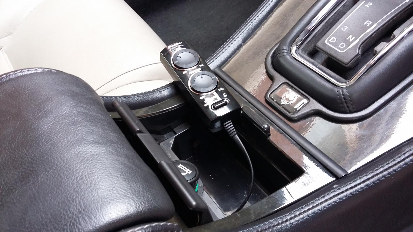

The sub comes with a wired remote control, which lives where the ashtray used to.

Nice work, the one thing (apart from aircon) I wanted in my XJ40 was mooooar ICE.

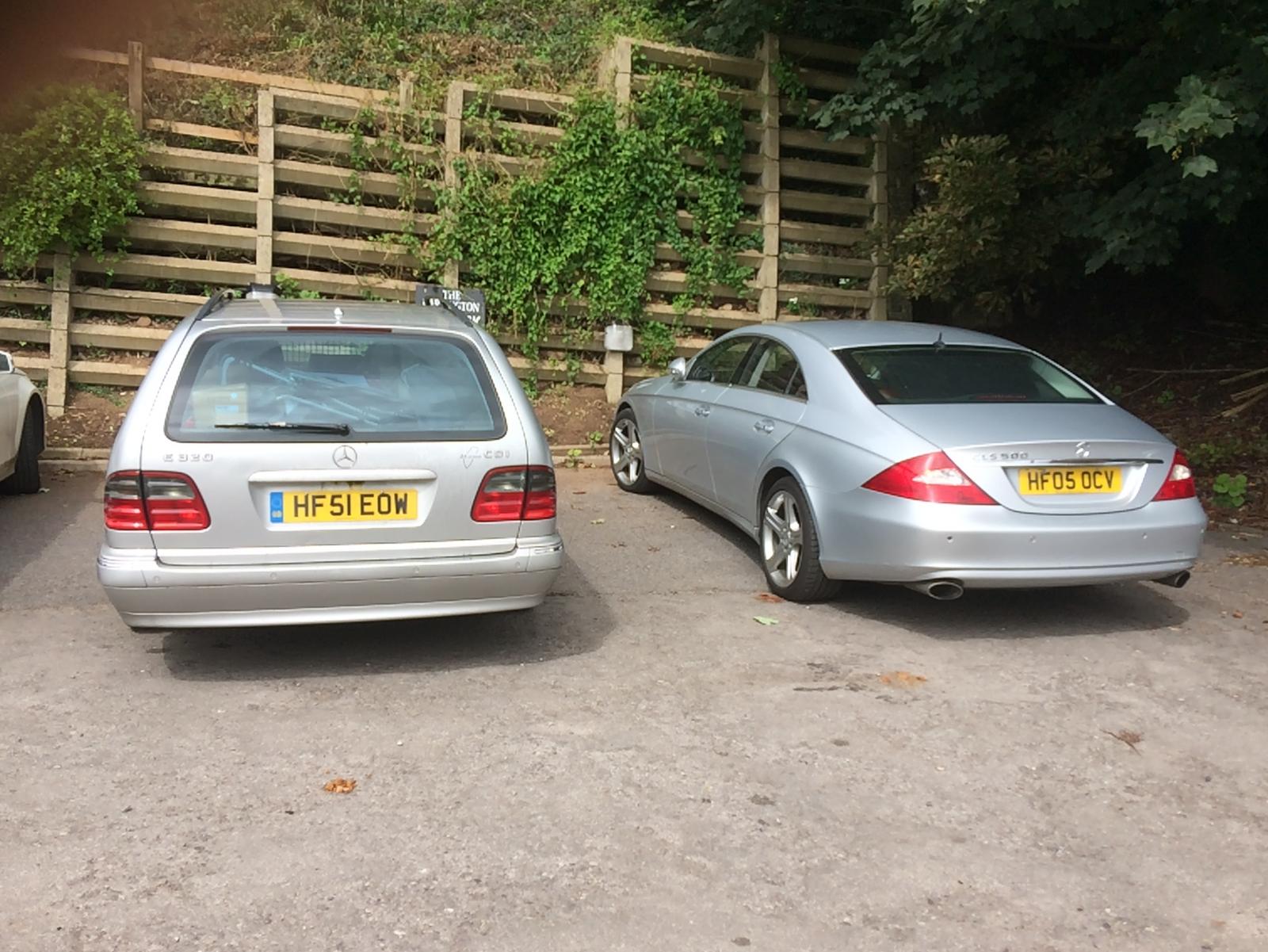

Got the w210 estate booked into my local merc indie to look at the leaking fuel injector problem that's diluting the sump oil so the other merc is now doing daily duties....post-4673-0-80826700-1504003376_thumb.jpg
