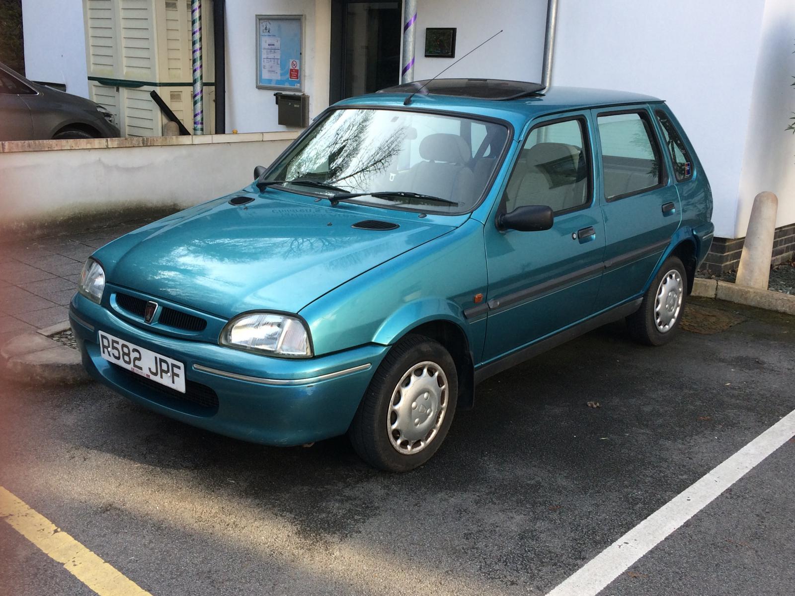

Well the Rover of Doom now has a working rear screen wash, for the first time in over five years in my ownership.  I'd taken the tailgate trim off to fiddle with the boot lock, and thought I'd investigate the screen wash while I was in there.  Pulling the pipe off and twisting the relevant section of the wiper stalk produced a strong flow of fluid, so the system back as far as the tailgate was obviously OK.  The rear washers are a bit of a weird setup on this - the fluid goes into the wiper unit itself, then up through the centre of the (hollow) wiper spindle, and out through two jets at the base of the wiper arm, one pointing to each side of the sweep.  This was blocked solid, and no amount of poking with various objects would unblock it.
So I had a look at the red 200, which also has a non-functioning rear washer (it seems to be a common issue with R3s).  However, it turned out that the system on the red one had a blockage further back in the pipe, and the passage through the wiper mechanism itself was free.  So I just swapped the entire units over, and now I have a sparkly clean rear screen (at least within the sweep of the rear wiper - the rest of the screen, like the rest of the car, is filthy).
I also had a poke round under the bonnet to see if I could find what was causing the tuning box not to be doing owt.  I redid a couple of dodgy-looking connections and plugged the MAF sensor back in (!) and it's now miles better.  It's amazing how much more responsive that little box makes the car - it seems to almost eliminate turbo lag.
