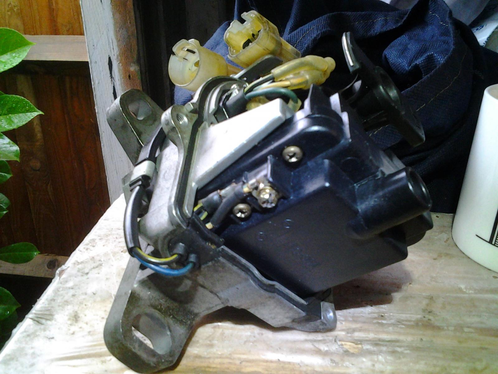

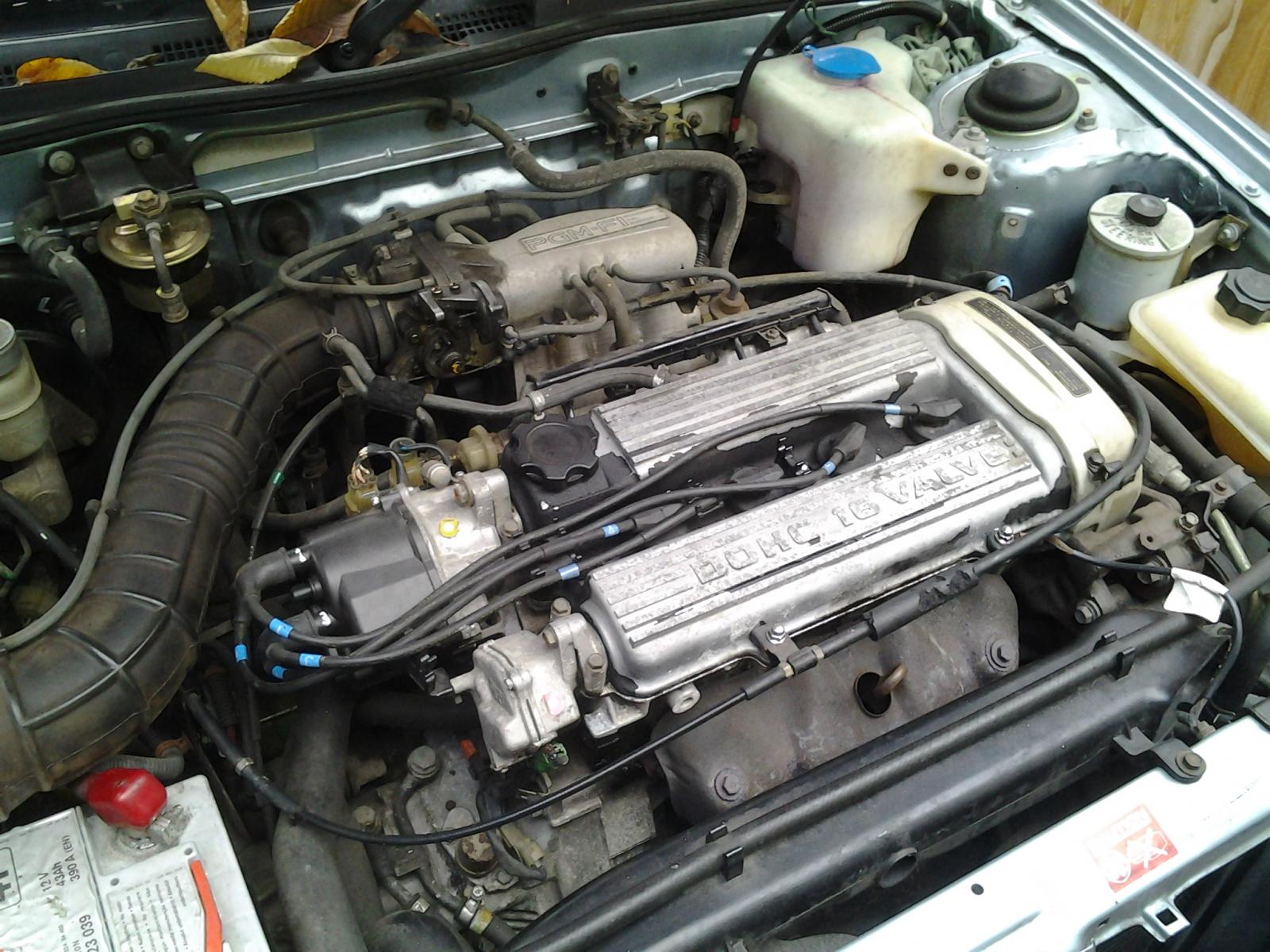

I've been fettling Rovers today. My Dad's 416 cut out on him a few weeks ago and refused to start. I suspected the ignition module was finally knackered as it had been a reluctant cold starter when I had it. So bonnet up and I removed the distributor.
In situ
On the bench. The module is the square thing and the replacement was 15 quid. It was all a straightforward job, even for me.
Popped the dizzy back on and it fired up! Fatha T is happy, especially considering he's just spent £300 getting it through the MoT and a service (another R8 that needed trailing arm bushes and the rear brakes sorting).
