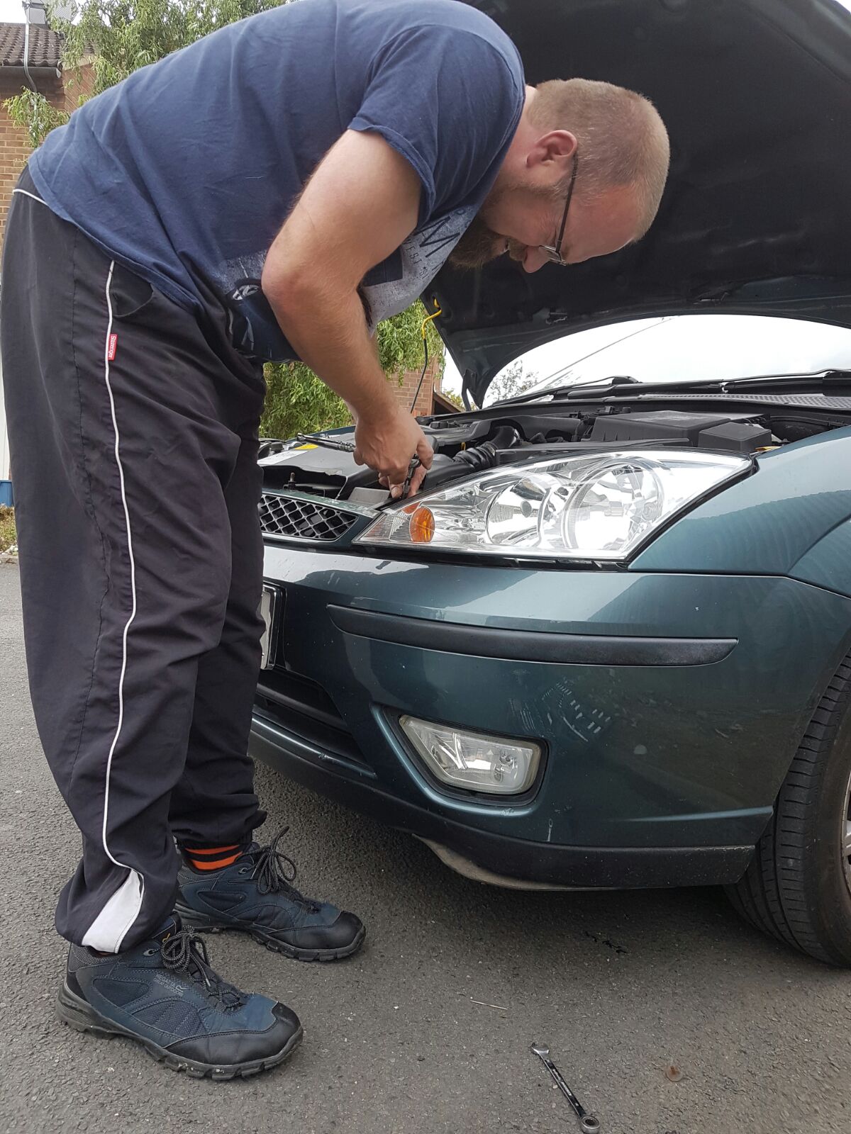

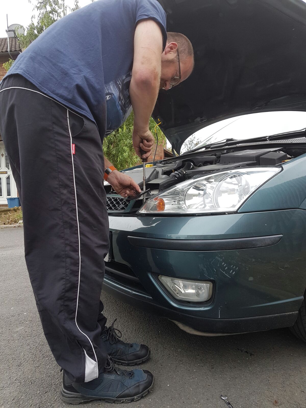

What are you doing? Looks quite involved, spark plugs on a modern? Sidelight bulbs?
Hahaha. Engine swap on the Panda is still less work than changing a sidelight on a Megane II
