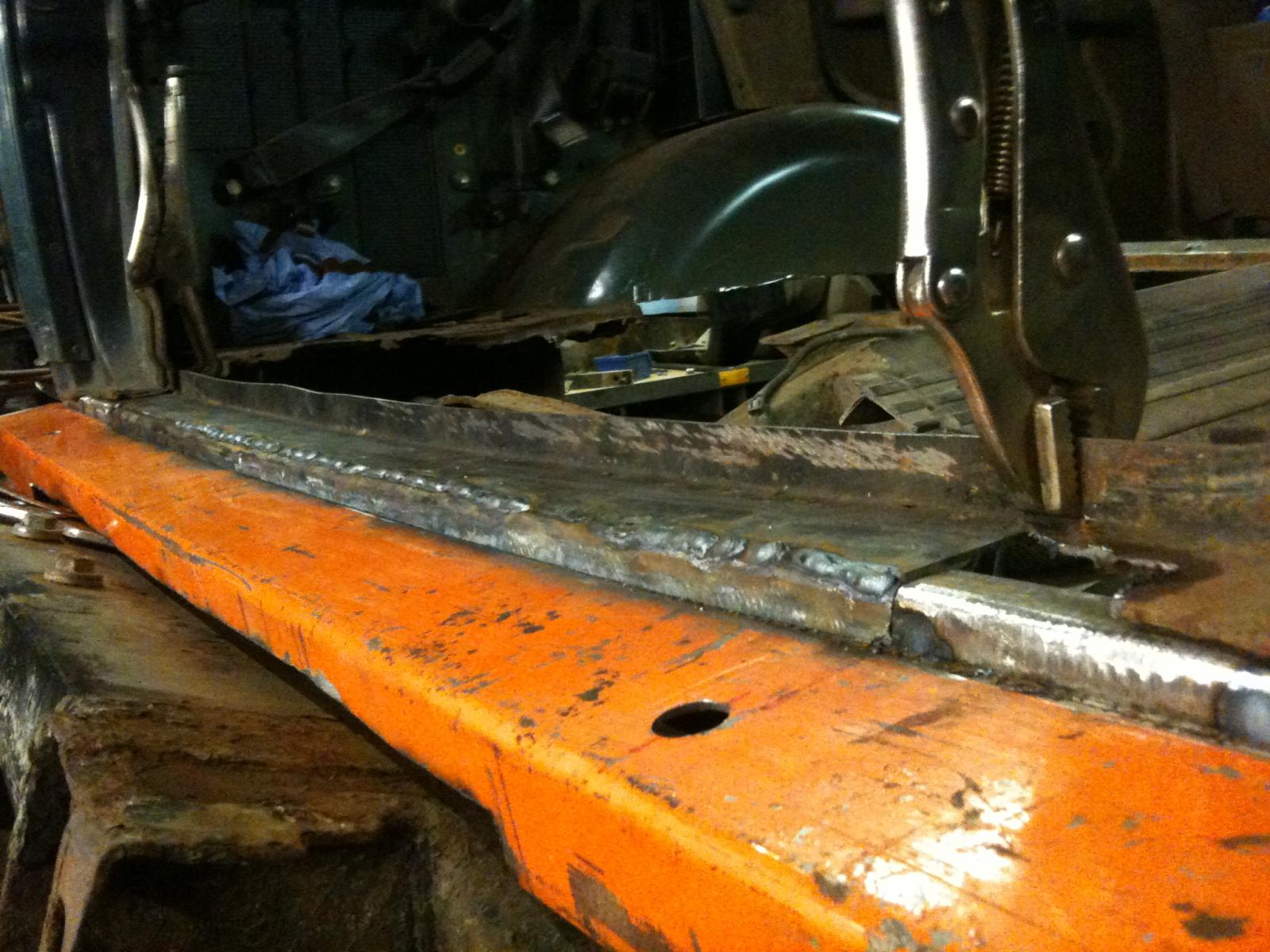

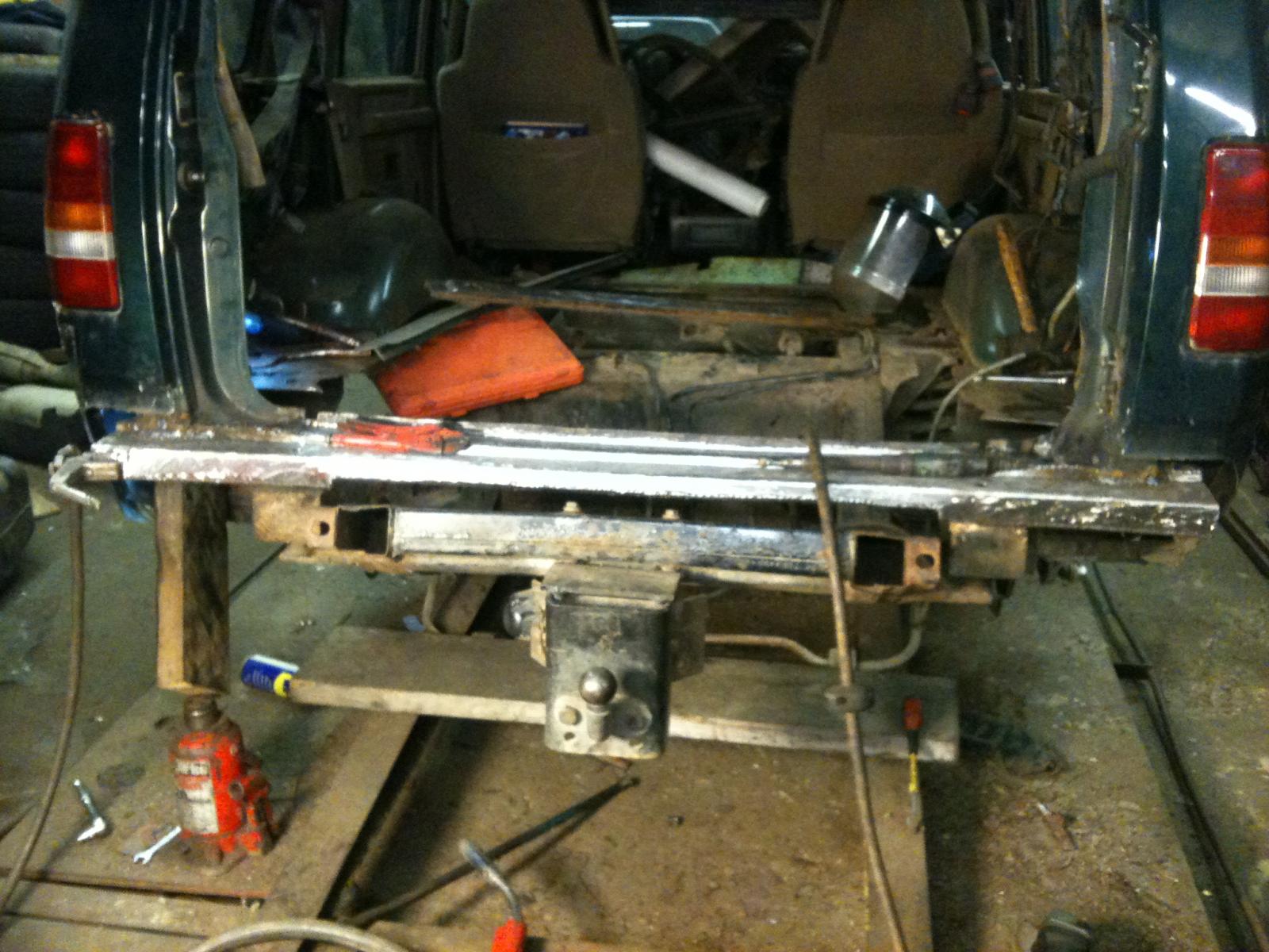

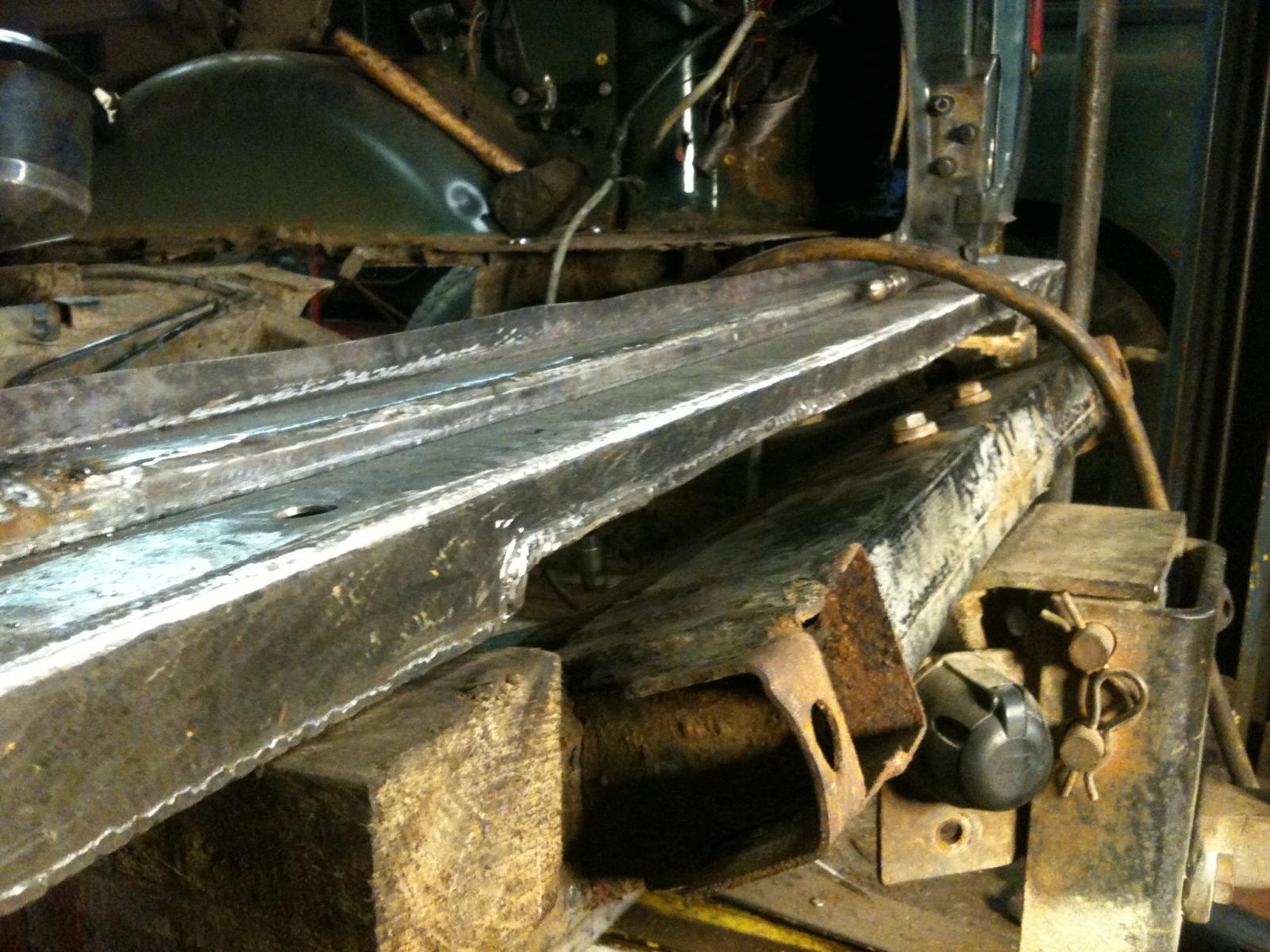

I did a shed load of welding on our early Disco for the last MOT it had.  It was all really easy though as the bits that rust are all flat and hidden away so the ugly welds last seen on hidden bits of Vulg's 1100 can be left to show the tester that it is a continuous weld.
Just need to find out if the rear crossmember is going to be within my limited abilities.
I did the crossmember on my 300 TDi
It's a tricky part to reverse-engineer out of scrap (as I discovered), it took 25 different pieces of metal to fabricate, but entire repair sections are apparently available.
