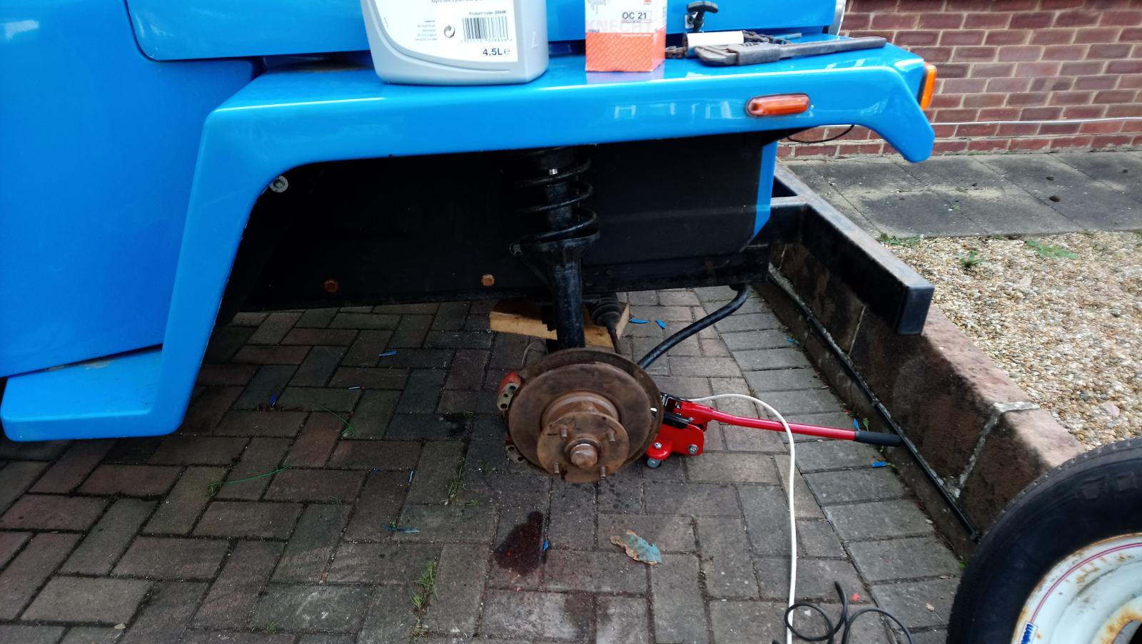

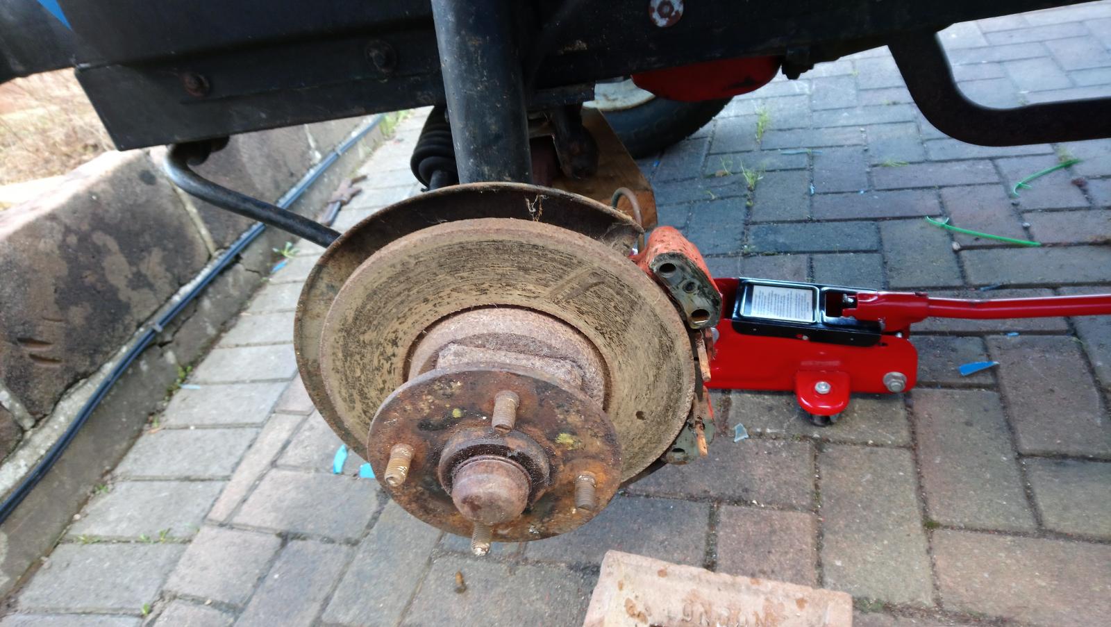

While it warmed up we had a look at brakes. The handbrake only worked on one wheel, but more pressing was the fact the front brakes were seized on. Those who helped push it - I'm now fairly sure it wasn't our imagination, it really did get a lot harder to push the further we went from the previous owner's house.
I whipped a wheel off to have a look at the discs and calipers.
Crusty,
Cobwebby.

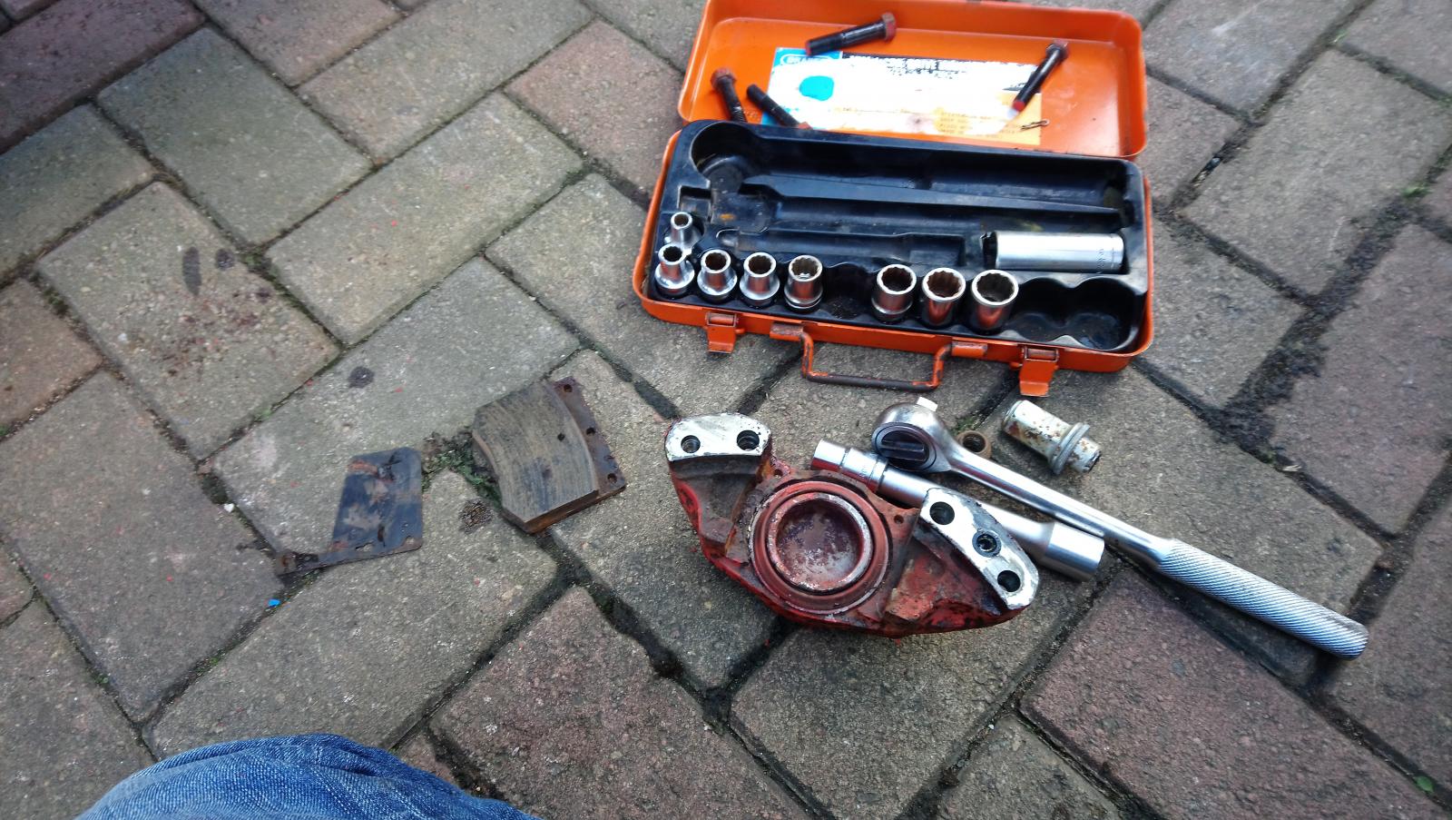

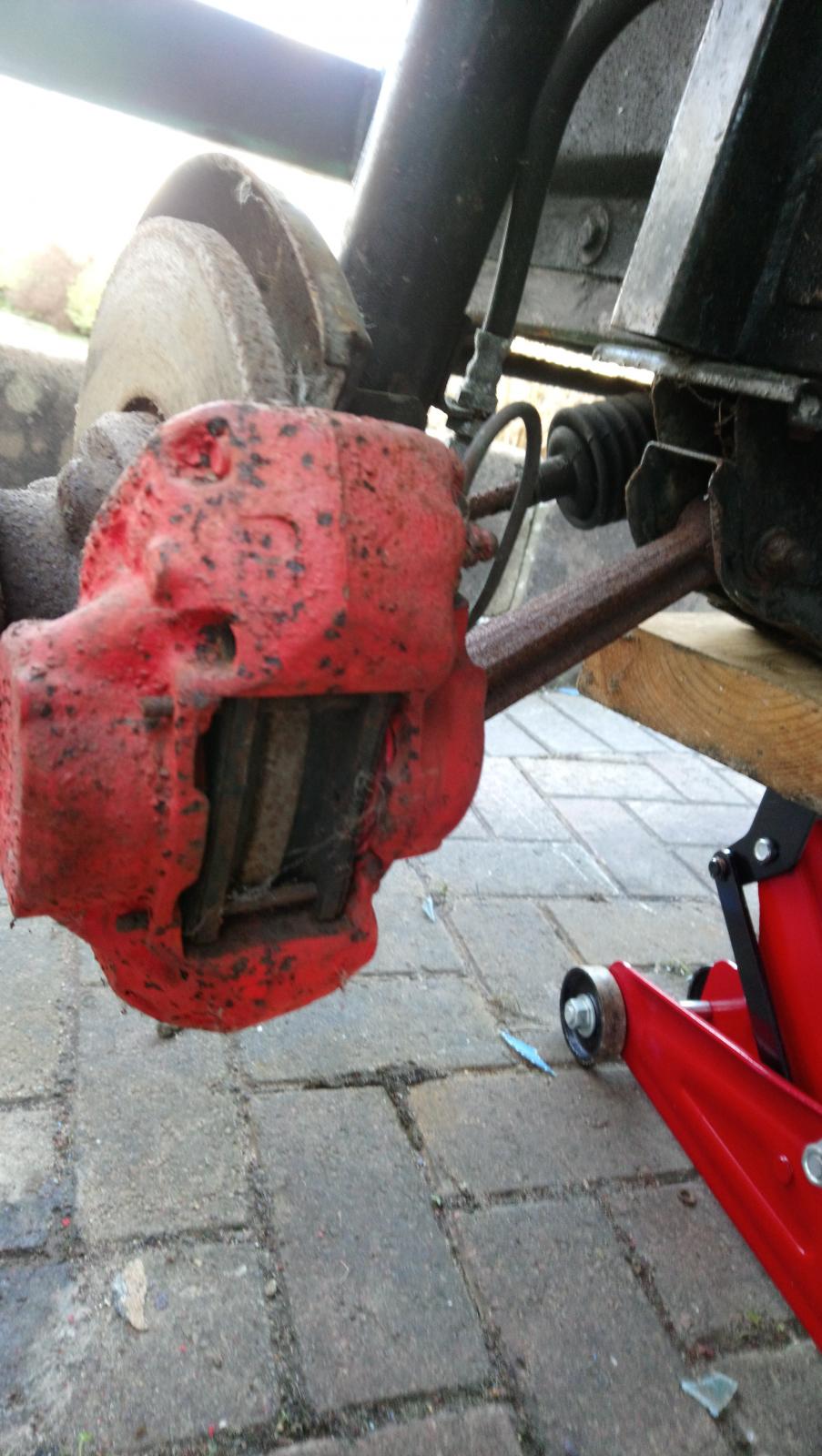

I wasn;t sure where to begin, as I've shyed away from brake stuff in the past. I found some bolts on the back of the caliper and undid them. The caliper fell in half.
Brake fluid dribbled out into the brick.
fallen off bit. With this removed, I could spin the hub with a screwdriver beteen the studs, which was progress. Obviously half a caliper is pretty much useless, but it did confirm the brakes were stuck on. I set to on the disc face with a wire brush in the drill and improved it a bit. its still manky and probably wants replacing (and I know I'm only doing half the job) but it looked better

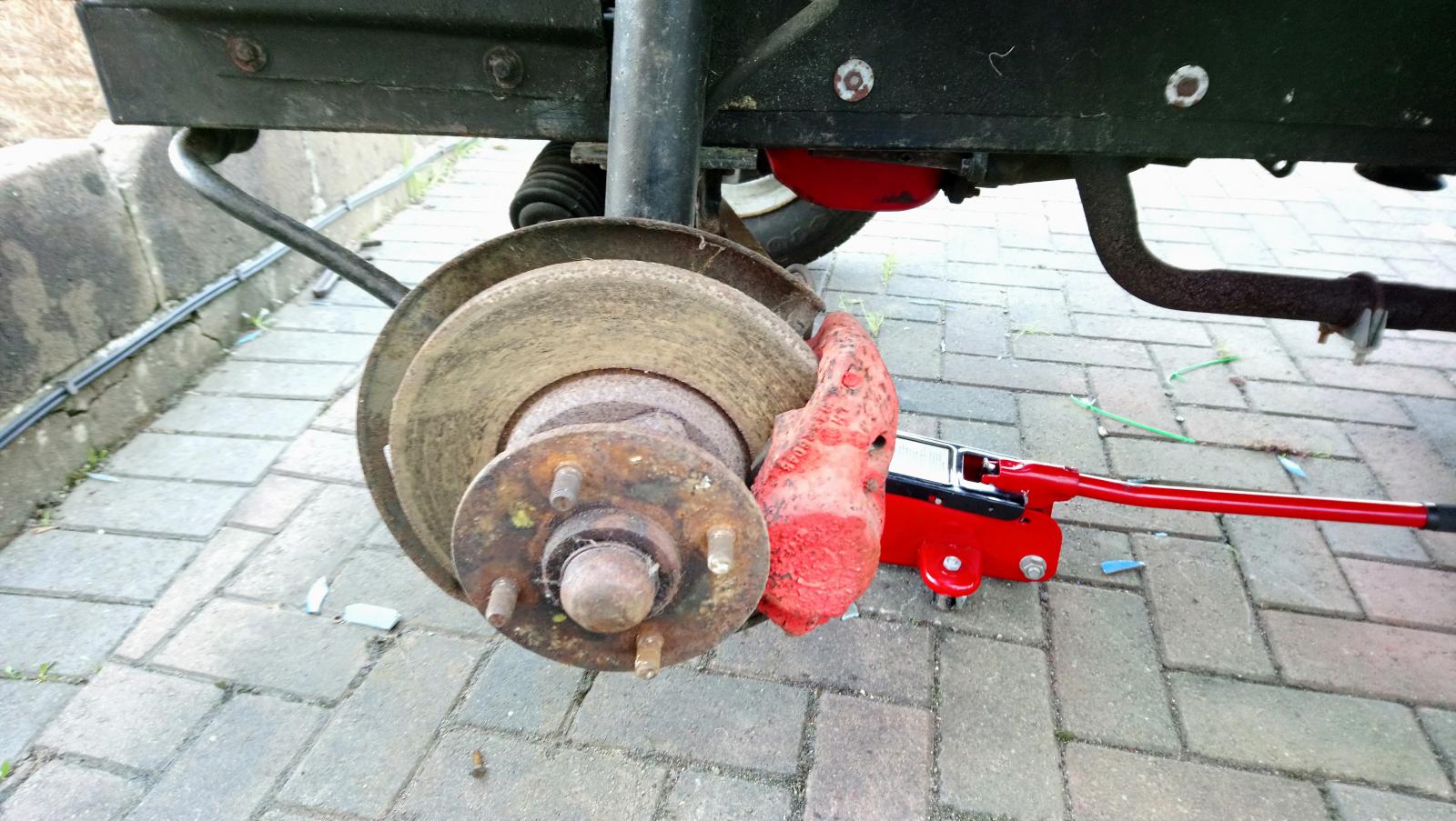

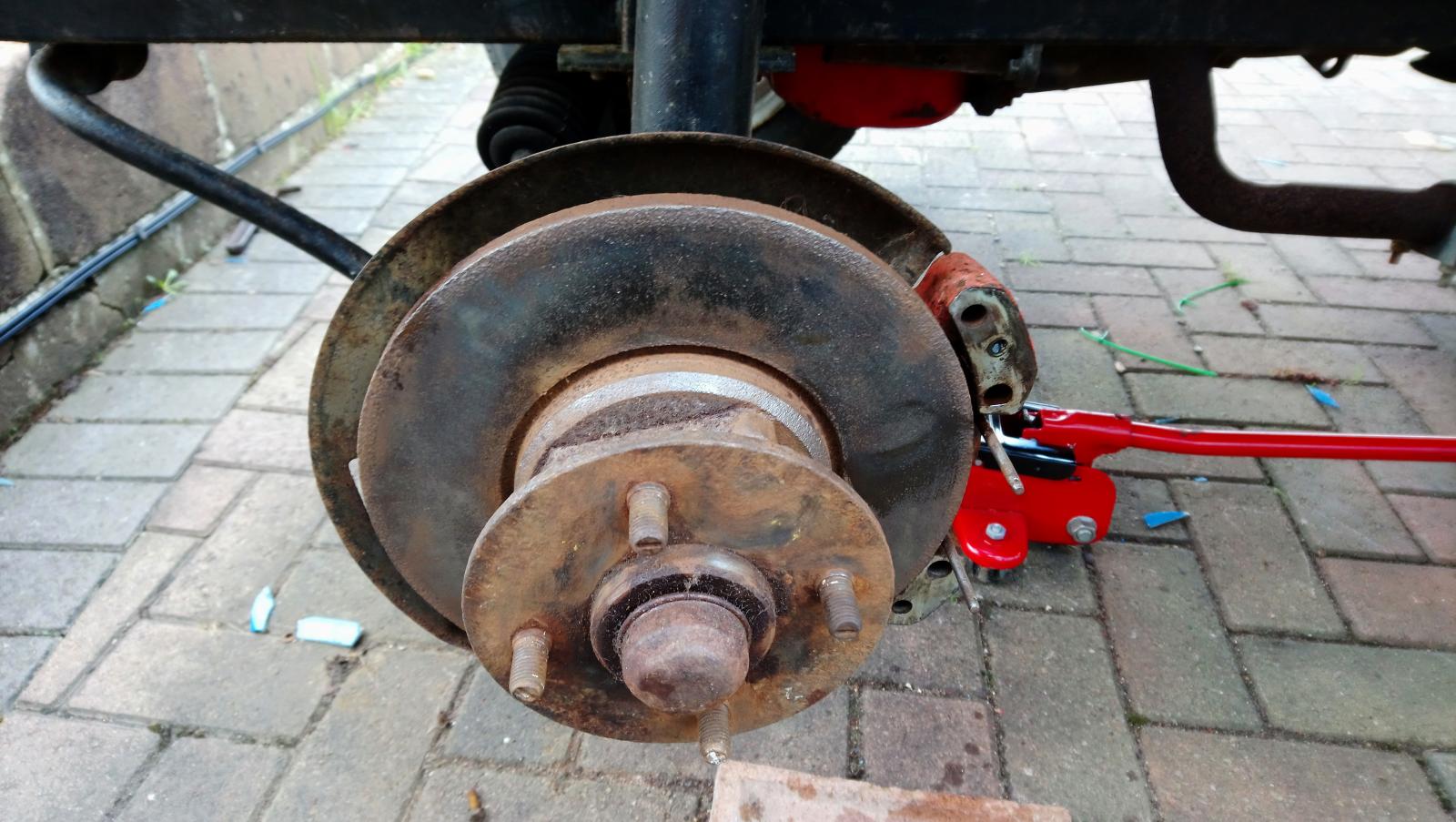

Then I went around the other side
Same story.
After my friend showed me how locking tabs work, and how to un-lock them we removed both calipers entirely. There was a tiny amount of movement after we lubracated them with brake fluid so we decided to give them a bath for a bit.
With all the bits removed, including outer seals and springs and whatnot they went into a bucket with 3 litres of shell 'fuelsave' diesel. they can have a think about the consequences of their actions and we'll have another chat next weekend. This will determine if they a just a 'bit sticky' or kippered and needing replacement.

Not really the way to take a caliper off, but since they were seized it won't really matter.
Unless you are certain you can register it I'd be careful about purchasing brake components which it may never need.
Those discs actually do not look bad at all. As soon as you have some movement in the pistons, just shove it all back together, and as soon as you actually need to use the brakes, it will clear off all the corrosion on the disc and be fine.

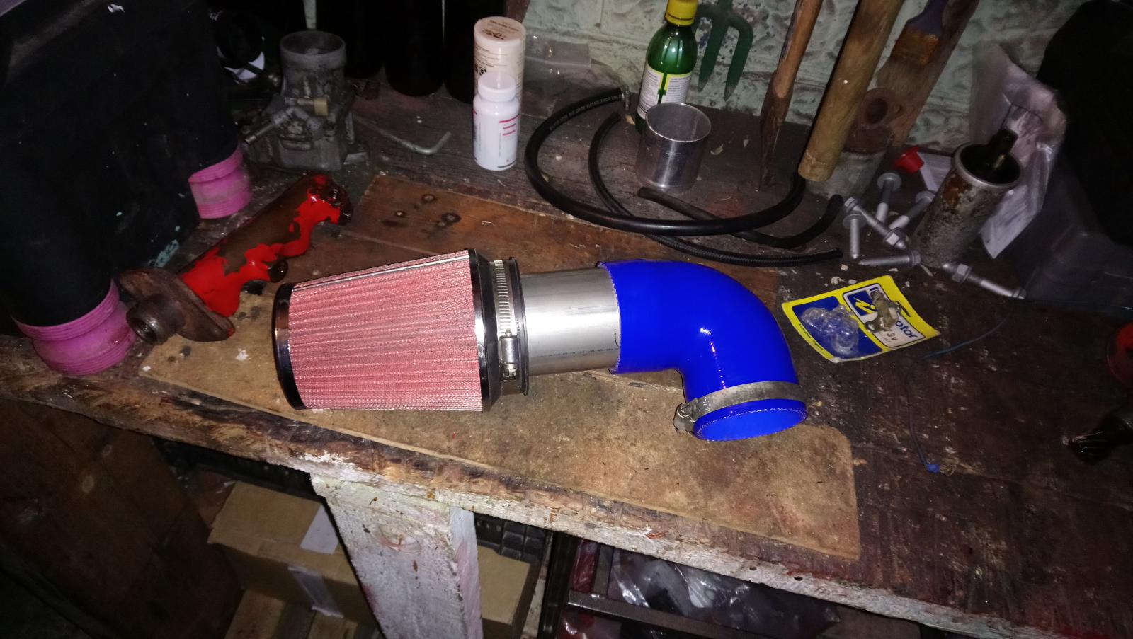

The air intake of awesomeness is finally assembled from some odds & ends from Chinese ebay

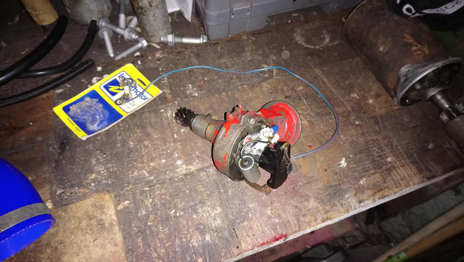

And the dizzy has been fitted with a proper NOS set of points which have quite a bit more meat on the contacts, and the replacement condenser from DTCM
And wants putting back in and the engine timing up. I shall need assistance with this!

Get yourself a large G clamp to press the calliper pistons in then you will need some sort of set up to push them back out again.
BTW that's not the way to take calipers off and would normally only be a last resort or if you were completely stripping them, look carefully for any seals between the 2 halves before reassembly.
