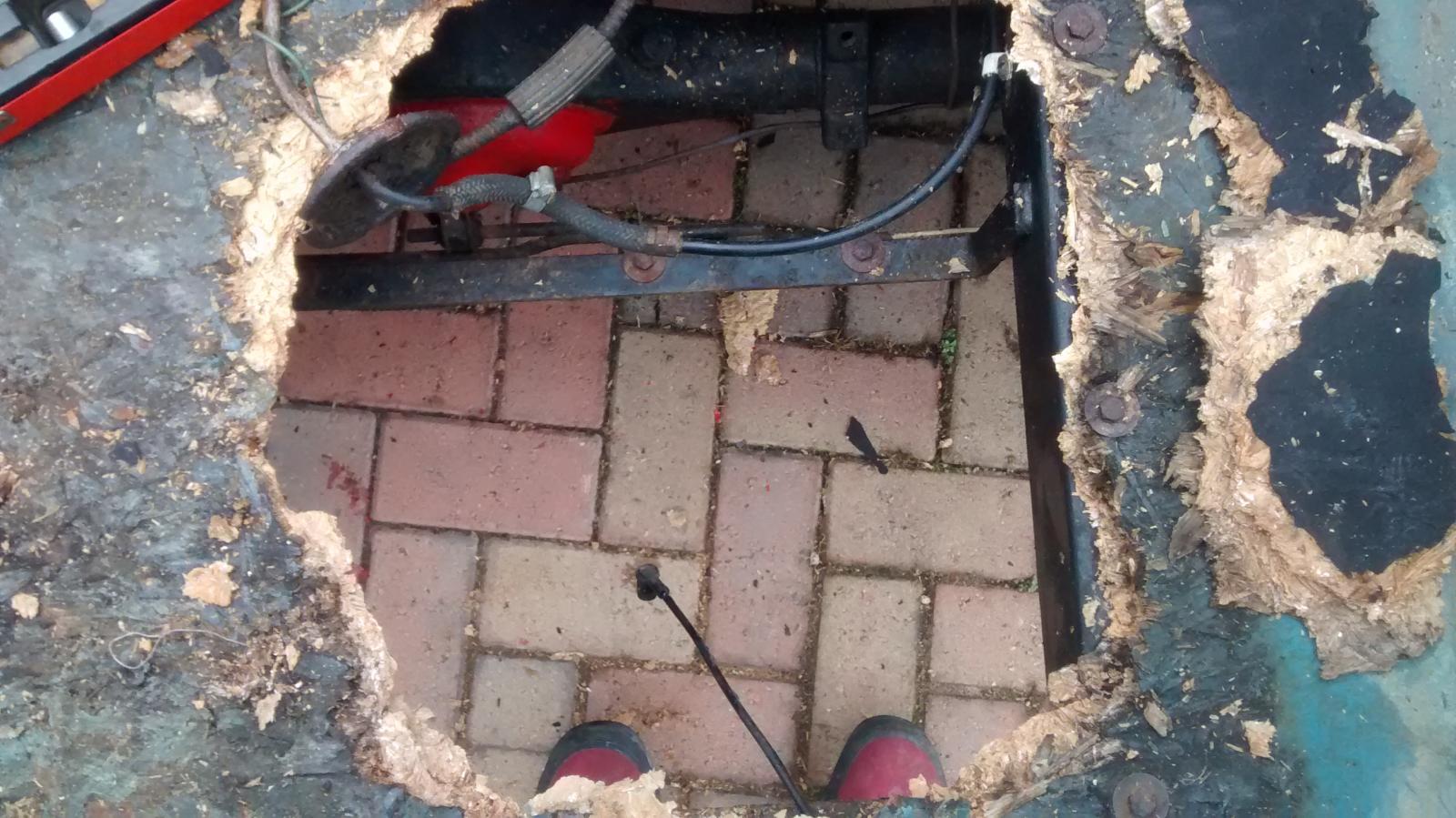

The rubber bung by your left foot is what is missing, which when pulling force is applied along the pipe what happens is the entire pipe/sleeve moves, rahter than the intended idea of the cable within the sleeve moving in isolation.

As you can clearly* see, there should be a bung/bush in this void between the clip and the pipe/sleeve (yes I know its well manky) - at present what happens is the sleeve moves over to the right hand side of the picture when the handbrake is applied. This should stay put (I think that this bush thing provides friction stopping the sleeve from moving) when the handbrake is applied.

Mally, can you get a cose-up pic of the rubber bung in that axle so i can see what sort of thing I need? (not immediately obvs), and possibly how it looks like it should locate? That pic makes it look like it should have a lip one end?

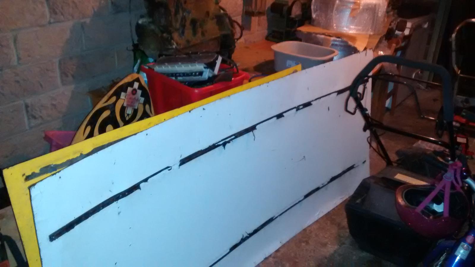

Bit of a win on local freecycle tonight, 2 sheets of 8' x 4' Aluminium di-bond sheet which is sort of two sheets of thin ally with a 'core' in between. The stuff they made a big fuss about in Grenfell tower? Yeah, that basically.
Its about 4mm thick and will become the new floor of the Geep, laid on top of the existing plywood. It used to be part of a 8' high sign for a local carpet warehouse, they re-branded and were getting rid, as they couldn't take it to either the tip, or the local metal merchant. It should be ideal for the floor as its light, strong and easy to cut to shape.

I'm going to see if I can put a very gentle set of folds in it to make it slightly concave to let accumulated water out yes!
Use a bit of heat when doing so, as dibond can have a tendency to shatter, depending on how thick the aluminium sheets are!
Pull the rear floor up and you might be able to see the handbrake junction from inside the car.
