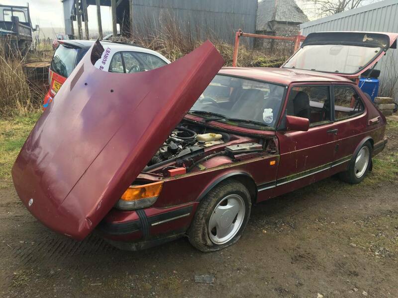

Whilst the oil filter for the P5b arrived today, as it was sunny and dry I decided to tackle an outside project. A bit of background, about 20 years ago I bought a Saab 9000 for spares from a guy a couple of villages away, Over the years, we occasionally met up at local events but we lost touch. Just over 2 years ago I received an email from him via the Saab Owners Club (he remembered I was their Sonett Registrar) and contact was re-established, and he was stuck as he was about to lose his storage and his project cars were about to be scrapped. I offered to collect them and store them short term until he could make alternative arrangements. The two vehicles were a VW camper and a Saab 900, both of which had been stored outside at a farm until the farmer passed away. The VW he had started work on, but ill health stopped progress, the Saab had failed an MOT and was just driven the 5 miles to the farm to await repair. The VW which features earlier in this thread I sold for him and I bought the Saab for parts as it was a Ruby edition, the run out model of the 900 and only 150 were made and have a lot of desireable extras. The Saab was parked outside my shed to await its turn, and can be seen in the background of a lot of my photos.

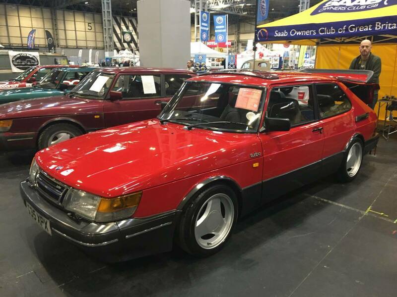

For the upcoming Practical Classics Restoration Show we have an immaculate T16 900 amongst others on the stand, and due to one of the exhibitors having to pull out due to personal reasons, we had a space and decided it would be nice to have a barn find (or more accurately field find) example to put next to it, so the ruby needed to be used. I thought it would be nice if it could drive onto the trailer so yesterday I stuck a battery on it as the original was very dead and it turned over on the key. Today I fetched some petrol and added 10 litres and was surprised that the low fuel light went out so something still worked.
Next was to try and air up the tyres. Two took air, but two have rotted the sidewalls out, so a patial success.  As it was tucked away, I thought I would try and move it to be more accessible so put it in first and tried winding it over and to my surprise it drove out with no stuck brakes, but no clutch at all, and indeed the joint reservoir for brake and clutch was dry.
Once I was able to get in the drivers door rather than climb over, I decided to see if there was any life to be found. After a fair bit of churning, it started to fire on one cylinder, which gave some hope. Cracked open the fuel rail to check the fuel supply and narrowly avoided an unleaded shower so that was good. Checked my shelf but it appears I have run out of easy start, but fortunately I had recently stocked up on brake cleaner so that was used. A squirt down the air intake and it fired up but promptly stopped. Several repeat performances and eventually it continued to run, but only on 3 cylinders. I switched it off to add some coolant as the expansion tank (and indeed the radiator) was empty and tried to restart it and was surprised when it easily started, but still on 3 cylinders. I let it warm up then switched it off whilst I went for a cup of tea. The missing cylinder was obviously either a stuck injector, a dodgy lead or most likely a dead spark plug, and decided I would look into it after my cup of tea.
Whilst drinking my tea, I decided to check the MOT history to see if it really had been parked up for 7 years, as I thought it had been resting at the farm for about 5 years before I collected it. I was stunned to see the last MOT test was a failure, mainly for rear brake pipes on October 31st 2007 with the mileage at test 5 less than now! That means it is in its 17th year of sitting around, outside, in the north east of Scotland!
Post tea, I went back out to it and pulled a hose off to drain some water off then added half a gallon of anti freeze. Started it up to circulate and mix the coolant and the missing cylinder had returned, so obviously it was a stuck injector. There you go, positive proof that tea fixes cars! Whilst it was warming up, for laughs I tried to fit the face off the stereo. Not only did it fit and fire up, the electric aerial went up and the radio worked, to sounds of the 70s on radio 2, almost appropriate!
Proof it was running, and not a stuck tacho :-)
It sounds glorious, so all in all a very good day. Tomorrow, if it is nice I will fit some replacement tyres and investigate the clutch, if not it will be back to the P5b.

Love a Ruby, and definitely agree with @Zelandeth, that distinctive Saab burble is infectious. How rotten has it become over the last 17 years?
Mine is the opposite, a non turbo but still pleasant to drive and used daily---
No idea yet! Hope to get it on the ramp soon to find out. Bottom of the doors have gone but the arches are still good. It is the drive shaft tunnels that is the main concern.

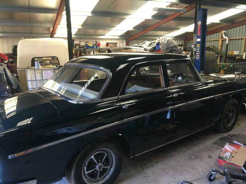

Monday was wet and windy so was a paperwork day. Yesterday  was lovely so back onto the P5b in between phone calls and more work related shite. Onto the lift and lifted up. Oil drained, what was left in it
Old filter came off, and I was delighted to find a rusty, damp patch on it so looks like that is where the oil escaped from. My friend sent me a new filter (his spare for an early classic Range Rover he has to save me waiting on a new one, so oiled the seal and went to fit it. After 20 minutes and many repeated checks between the old and new filter (both looked identical, same size, same TPI thread etc) and carefully checking the thread on the filter housing, I began to question my ability and sanity. It would not go on.
Using the tea fixes everything principle I went inside and made tea. Whilst drinking it, I did some internet sleuthing and eventually I found the problem. The original filter was a Fram PH25 with a 15/16" 16 TPI thread. The replacement was a Mahle OC261 which has a 3/4" x 16TPI thread. That extra 1/16" would explain it! Phoned my parts people and asked for a PH25 and the response was what the hell is that off! :-) Eventually he tracked down a Mahle equivalent and it should be here Friday. As back up I also ordered a Fram off the bay of evil which should be here Saturday.  That ended Rover progress so I am just going to put this here as it makes me happy!

Mind unless you're unlucky you might have to prime the Rover's oil pump after leaving it dry.

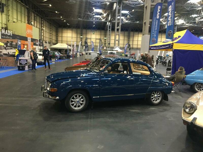

Once there, we set up the stand with the "barn find" between two superb examples, a set up that worked well and generated a lot of interest. Over the weekend we made many jokes about the possibility of a stowaway mouse as there were several obvious mouseholes in the sound deadening under the bonnet but as the car had travelled over 400 miles on a bouncy trailer, including an overnight stop we were confident we had no passengers. So, to the exhibits:
and in detail - first the other roadworthy two stroke sonett in the UK
This late 96 V4 is the owners daily driver and was driven down from Fife for the show
In contrast, this fully restored 96 V4 has been in the same family for 2 generations and won best in show at this show the last time it was held in 2019
This lovely 99 is original and has not been restored
This 900 T16 had been booked into the 2020 show as a cruffy example but had become the owners lockdown project and was restored in a single garage, looks not bad for 243k miles!
In contrast was mine

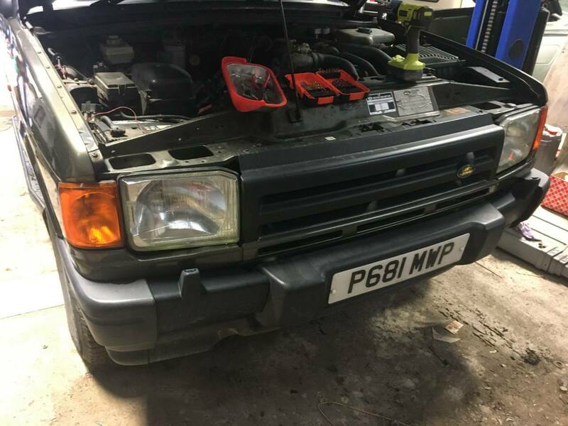

So today it was move stuff around in the shed and get the Disco in

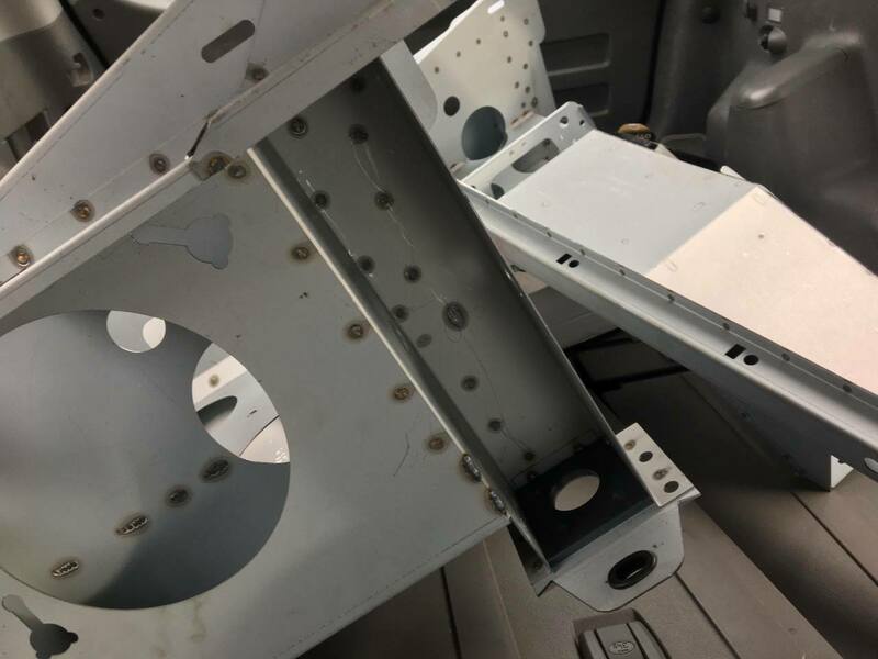

Headlights out, indicators off and the screws out of the top and the bolts from inside the door, which according to all the references just left two bolts at the front. One came out but the other was seized, so some chiselling failed to remove it and the angry grinder came out to remove the corner of the inner wing
This revealed that the references were wrong and there is another bolt at the end of the sill.  Removing this requires either lieing on the floor of lifting the Disco on the lift. I decided the latter, but also decided I could not be bothered as it was now 1930 so it cam wait until tomorrow. This is how I left it

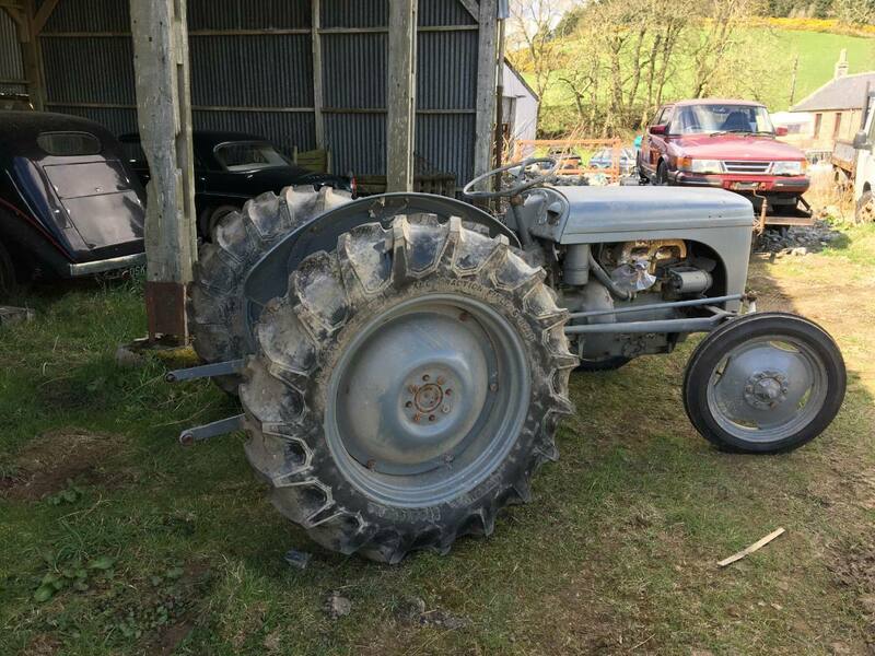

Back home to unload it, it is a 1951 Ferguson TED20 petrol/TVO example

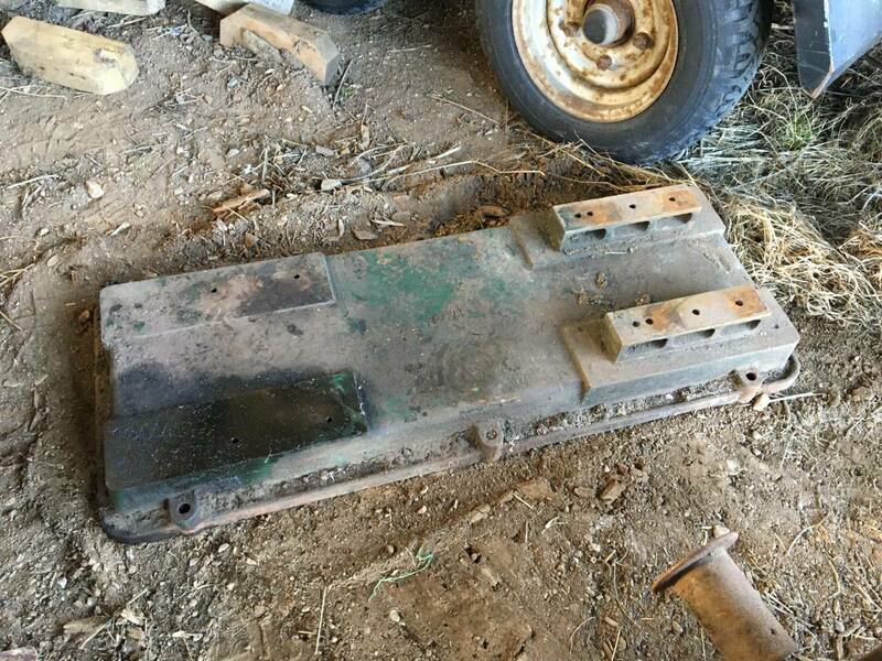

First a Petter A1

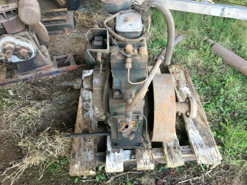

And finally a Petter AV6 (I think) water cooled diesel complete with a home lighting plant consisting of bed plate
Bloody heavy generator
Fuel tank and switchgear
and of course the engine

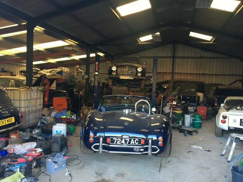

With the Fergie out of the way, time to move the Cobra so I could get the Discovery of Doom onto the ramp as I think 2 years in the naughty corner is enough. Cobra fired up first time but whilst building  oil pressure, it stopped. Repeated attempts to restart, including adding more fuel, failed to produce results. Eventually proved there was no spark and as it has a Mallory electronic distributor fitted more research was needed. Put the battery on charge and called it a day.
