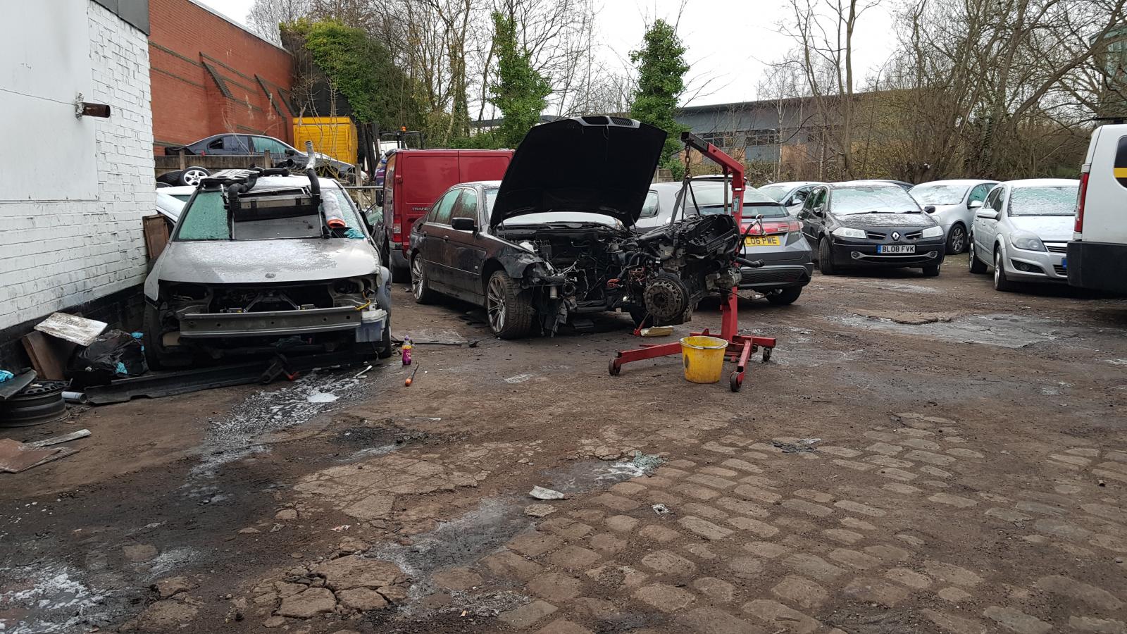

Arrrghh FFS, we have borked Rangie and before we get to a picture of it, we get to see a borked 3 series.
Was looking for some piccys of two engines 'side by side' on the deck mid swoppage. GLWSAGE so we get to see the finished article.

Engine collected from suitably shite location
