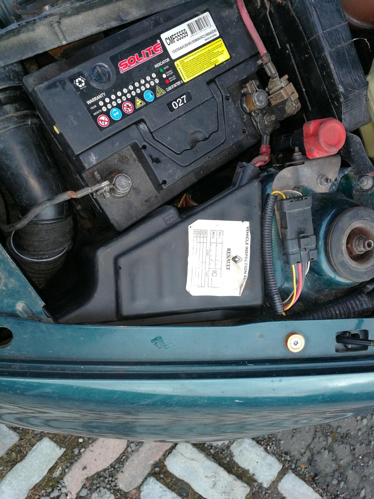

Symptoms as follows:
Car gives full dash lights, and relay clocks but starter doesn't engage.
Blower and heated rear screen not working.
Have checked all Fuses, tried lead engine to chassis, no dice.
It will cough if bumped (can't get up enough speed in 3 car lengths).
Suspect an issue at starter.
I hope you don't need to change the starter cos it's a bit of an arse to get to. Mine didn't have the heat shield that goes between the starter and exhaust manifold as they are very close together, wonder if yours has lost it sometime in it's life, that would shorten the life of the starter considerably.
If it's anything like the smaller engine'd Clio's theres a rats nest of small earth wires down under the battery around the relay box.,which rot out. Cause all sorts of weirdness. -Blower and HRW relays are here, as well as he main relay.

RAC arrived and checked it all out. Starter motor not playing ball even when contacts powered directly.

"We've got the motor off, it's burned out - looks as if it has stuck on. We're finding the correct motor for you now, as yours is a 9tooth, not the usual 11tooth. We'll also check the ignition wiring to make sure nothing is shorting out."

Go intae the shop, boy says "ahh, the auld heid came in useful err, ah says Tae them, if it's a 9 tooth, it's a Bosch motor, they walloped wan in and away she goes"
