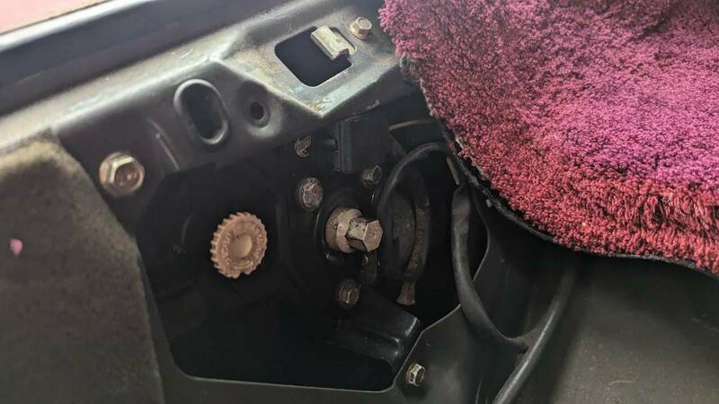

Fixed the door trim by watching a YouTube video
Then tested the most important part of the car.  The sunroof.
Bastard switch does fuck all.   Bastard cunting thing.
  • Sad 1
Dunno, Mrs L1 hasn't driven it yet.
Many, many thanks to @doug for the manuals.  What a hero!
Just had a quick test of the sunroof in the quiet, the motor is running but presumably the cable isn't connected.  Who puts an electric sunroof motor in the boot?!
  • Confused 1
