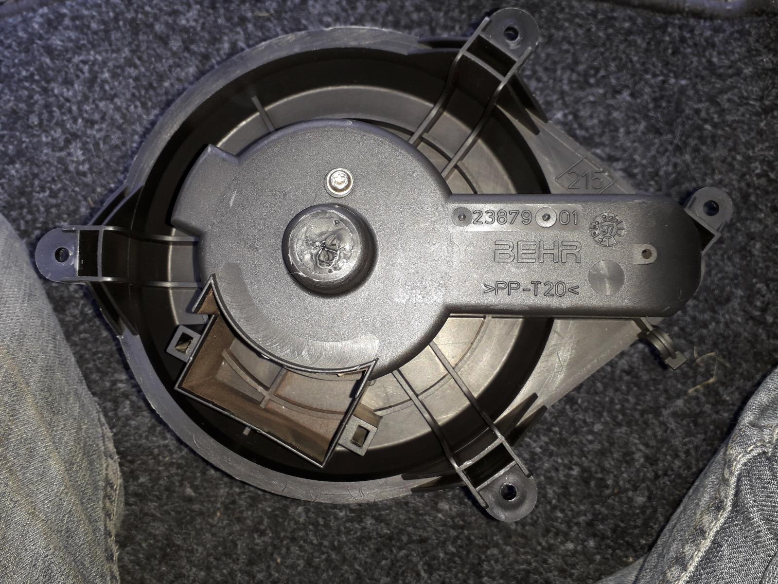

The one thing the Safrane needs is a heater resistor which is why the blower don't work. Renault are no use they have told me it could take 6 months to get one as no one has one in stock :(
Problem is the resistor is unique to the lower spec model and the V6 ones are different. Not that i can find one of those anywhere either.

Got 4 in stock but all from a V6 so it has clmate control,yours doesn,t but the part number is 77 01 035 893,might be tricky to find in the UK as most Safranes had A/C as standard and all V6s had Climate control.
I will do some searching for you...
Mine's supposedly a Valeo unit (three Torx screws holding it on) but is manufactured by Behr, and with a Bosch motor inside... seems that those fitted with PCB resistor units can be repaired using a new thermal fuse (99p from Maplin etc) to bring the blower back to life, but others can't. Renault Forums has a step-by-step guide for some types of Laguna 1 blower, so a slight chance the Safrane may be similar-ish? Any pics of your unit?
P.S. - ^^ this type can't be repaired, seemingly. Replacement scrappy-sourced part for mine currently keeping the shelf warm in Yodel's depot.
No the motor is fine in mine its just the resistor pack. I have made a small wiring amendment so i have spliced into one of the feeds to the motor and used a relay and a cable that i plug into my cigarette lighter with a fused plug. This gives me full motor speed just so i can demist it in the mornings but it is not ideal.

But yes, it's likely you can find one roughly the same size and retrofit it. Does the fan not work on speed 4? If so, it's not likely resistor pack as that isn't used on speed 4 - it's a direct connection.

Blower motor does not work on any speed with the resistor fitted. But the blower works if connected direct to power source.
I will post up some pics of the one i have i did try buying one for a renault master van as it looked the same but its wiring was different soon as i plugged it in the motor ran regardless of switch setting also ran without the keys in the ignition.
