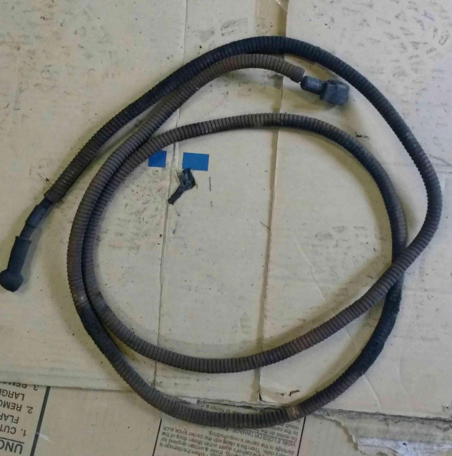

This is the cable from a rover 100 P4 which had a 2.6l engine. Insulation is OK and it has steel outer sheath to enable it to withstand the apocalypse. There is a ring terminal on one end (rubber cover still intact) and a negative battery terminal on the other which unless your Lupo is very odd will need changing. I most likely have a decent + one so if you want it PayPal me 6 quid and I'll bung the lot in a jiffy bag and that will be one less thing cluttering up my workshop.
