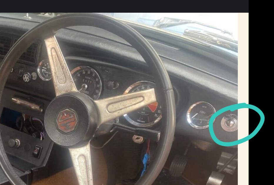

This one has one stalk (indicators and main / dipped beam) and a space on the dash far right with 2 wires behind it? hmmm.

Looks like the switch is AWOL, the earlier photos do show a switch.
Looks like the usual random selection of spaghetti wiring fun and games in there which seems to be standard on these cars!

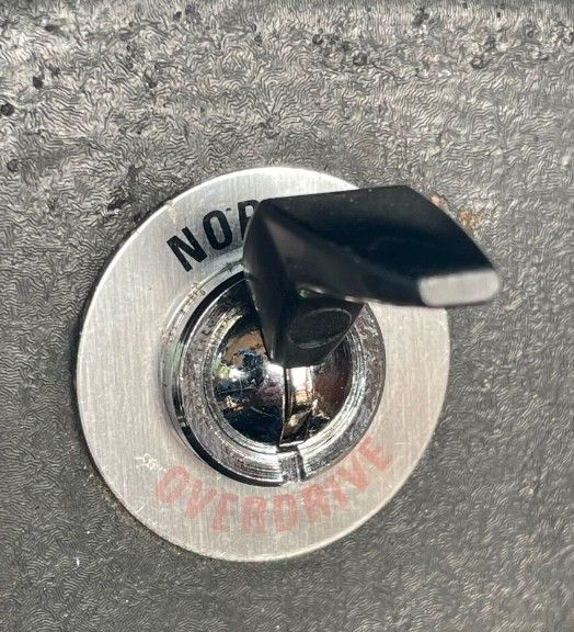

Regarding the missing overdrive switch if there are 2 wires there it implies that it is fitted as there'd be no point if not, it'd just have a blanking plate.
It may be that the inhibitor switch that stops it being engaged when reverse is selected has failed and the switch was removed because of this. I understand that if you reverse with OD engaged you will see a big bill.
My OD plays up if it's not used on a regular basis so it might all be OK, you just need to check the inhibitor switch which if I remember correctly is on the transmission.
(And obviously get a new switch, they're about £15 or so)
There are indeed 2 wires behind the hole in the dash. Ill need to do some more investigating.

Remember the blank space where the overdrive switch would have been? I messaged the vendor- who speciallises more in 9-15k fully restored tartan red/ chrome wire wheel jobs; to see if he knew anything about the overdrive. He borrowed the switch for another, more glamorous ‘b but it was working fine before it donated the switch.
So one switch later…
And we have a fully functional overdrive on 3rd and 4th

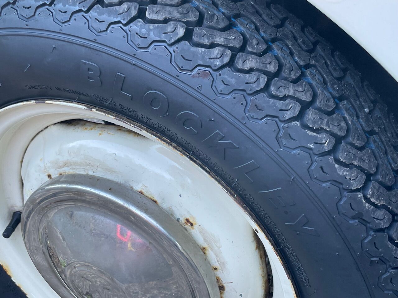

And the white one (which had very old tyres- as in the above pic- dated 1997 according to the tyre fitter) now has a new set of blockley 145r14s - a radial but pretty much the closest modern match dimensionally for an original set of hoops…..
