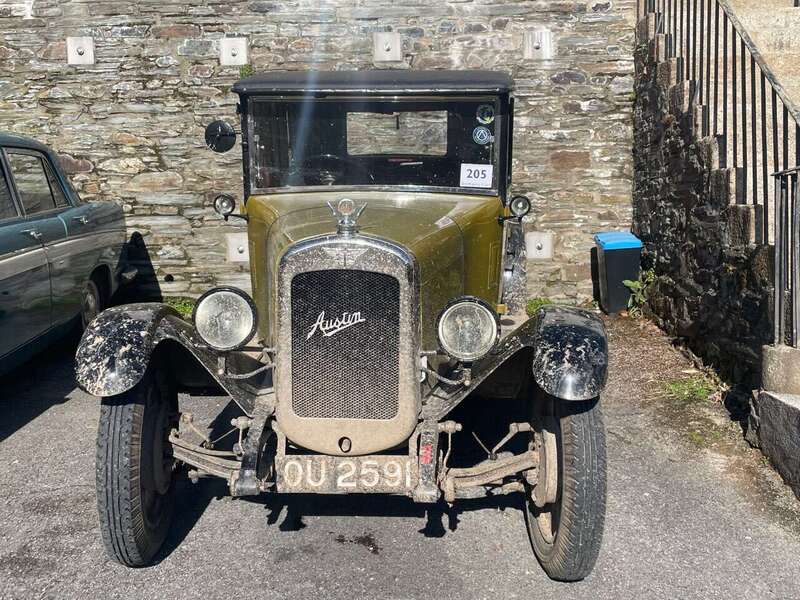

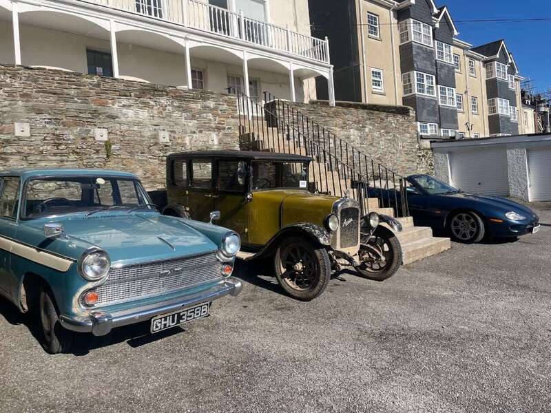

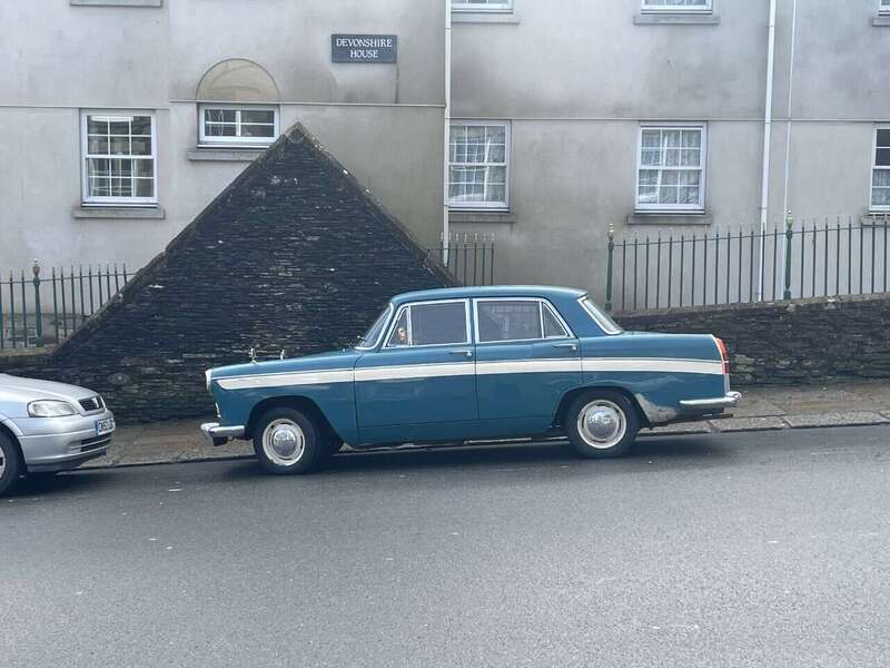

Been pottering in a different blue 4 door this morning. During the commute on tuesday I thought it had developed a low load missfire but that wasnt there today. Electrical or fuel related? Dunno.
Vaper or Vapour? An onlooker takes a drag beside an austin with a (now resolved?) possible fuelling issue.
