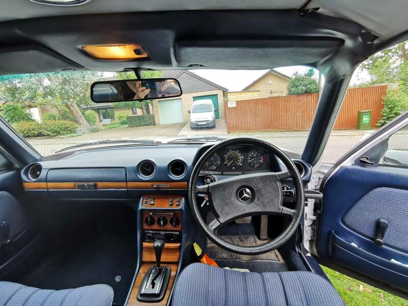

Gave the interior plastics a really quick wipe down this afternoon with some vinyl & rubber care solution.  Never ceases to amaze me how much life that alone can bring back to the interior of a car.
The interior really is a pleasant place to be.

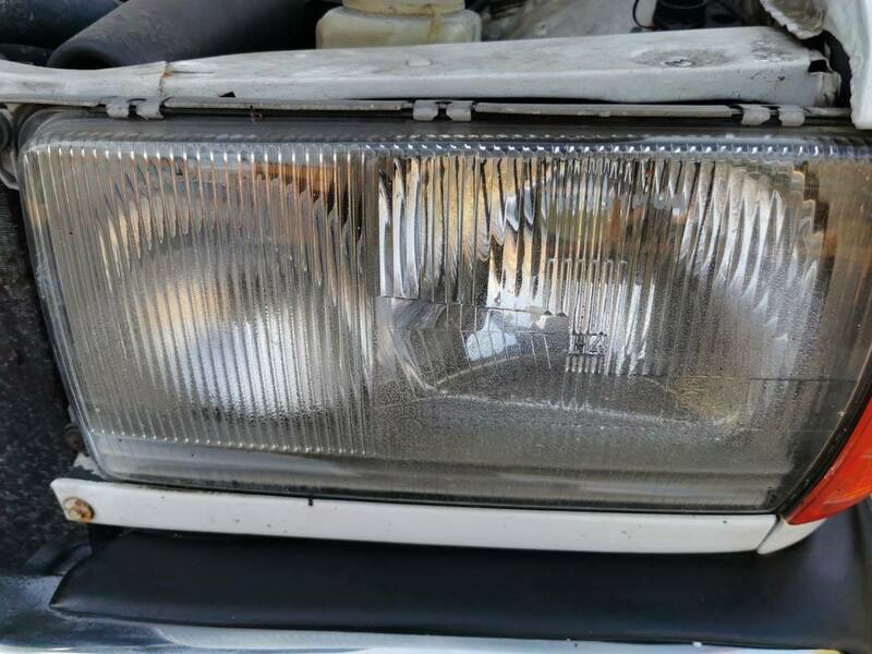

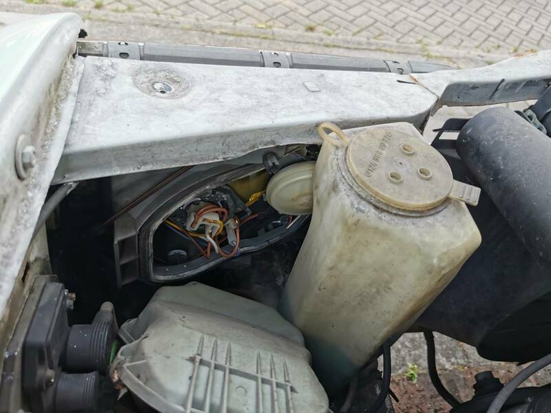

Noticed while doing this that there's quite a bit of condensation in the nearside headlight.
So given how warm it currently is have just popped the rear cover off it, hoping the weather will dry it out for me.  I'll have a closer look to see if I can see any evidence of where water may have got in at a later date.
May just renew the foam seal around the lens as a precaution if I can't find anything.  Looks easy enough to do at least.

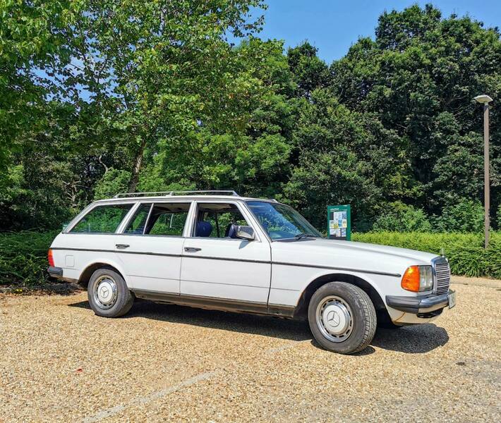

Edit: Forgot to include a couple of photos from earlier in the day.  Really do feel that there aren't many cars which can match the sheer presence the W123 has on the road, not until you start getting into Rolls territory anyway.
Really does suit the estate shape I think too, quite a few estate variants can look quite clunky next to their saloon or hatch counterparts but this one just works.

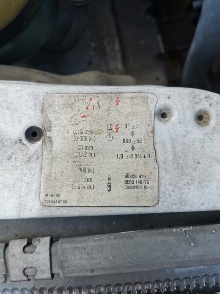

Did notice one nice detail in the engine bay that I'll need to try to remake...you know all that technical info for servicing you're likely to need?  Spark plug type and gap, timing details, valve clearances...all right here on the slam panel.
Nice little detail to find.  Just a shame it's so faded...wonder if someone sells reproduction engine bay sticker sets for the W123..

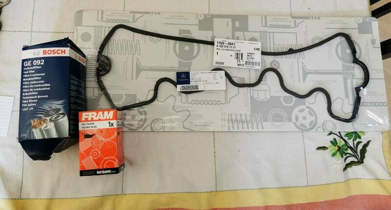

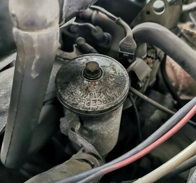

Rocker cover gasket arrived this morning so should be able to look at getting the valve clearances set and the top end at least something resembling oil tight soon.  Then will get an oil and filter change done.
Not doing that beforehand as I'll probably want to clean things up after removing the petrified remains of the old seal etc so don't want to end up washing crud down into the sump if it's full of fresh oil.
You know you need to have the correct stickers.
It's German. Having stickers is important.

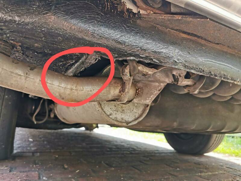

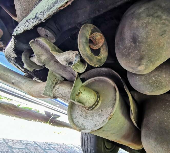

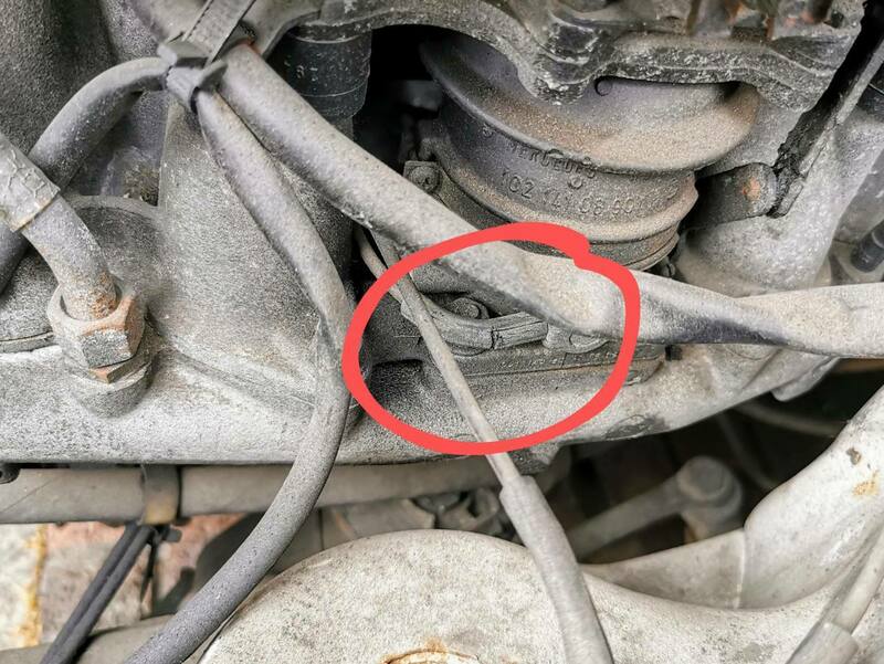

Noticed the other day that one of the rear exhaust hangers weren't attached.
Upon reattaching this it became immediately apparent why - because the exhaust hits the bodywork with them both on because they're too short.
Cue horrible buzzing rattling noise as soon as the engine was started.
Solution?  Fit two new hangers which are slightly longer.  Problem solved.

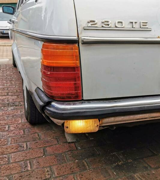

While in that corner I investigated the non functional reversing light.  Just a case of dirty contacts, after a quick clean it was back in action - though it needs a good clean and ideally a new lens.

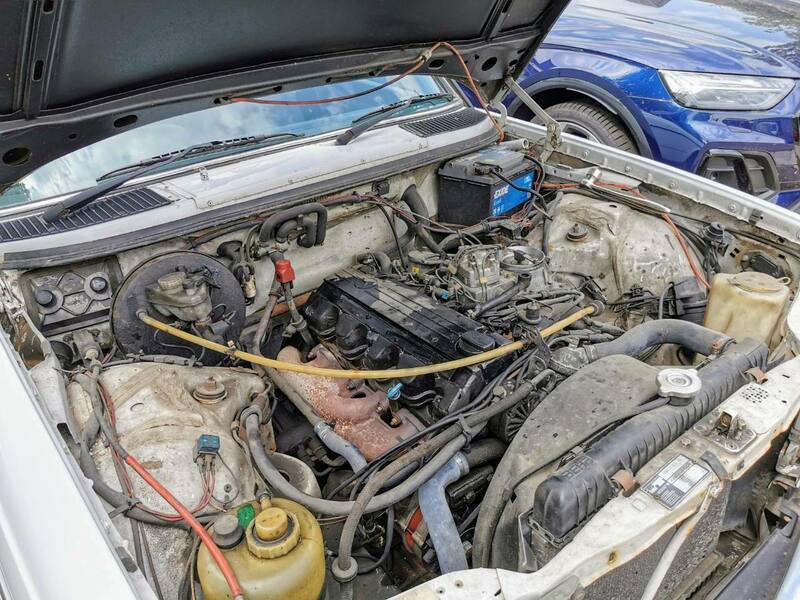

Had a nose around under the bonnet with a view to seeing what I need to move to get the rocker cover off.  Doesn't look like it should be too bad.

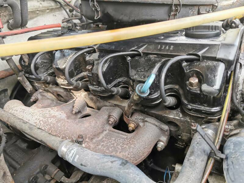

Found a nut and a few washers so have replaced the missing nut on the exhaust manifold.
You can see pretty well how much oil is everywhere.
I am seriously looking forward to cleaning this engine bay.  Not only will it be immensely satisfying, but it will be really nice to not get covered in black grime every time I so much as walk within ten feet of it.

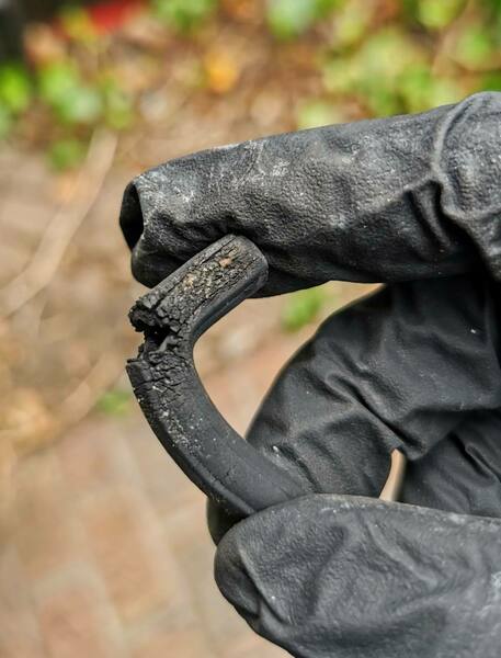

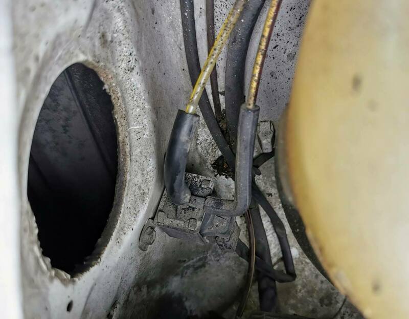

Spotted something that needed immediate attention today...this looks like it might be a vacuum leak.
Yep...

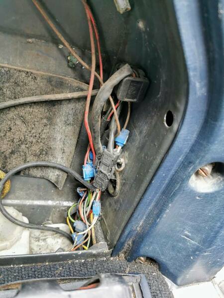

Found another one of these in a similar state over on the offside inner wing.  I don't have a diagram of the vacuum system yet so not actually sure what this does just now...
I'll probably go around and change all of these boot connectors at some point as they're all a bit soft.

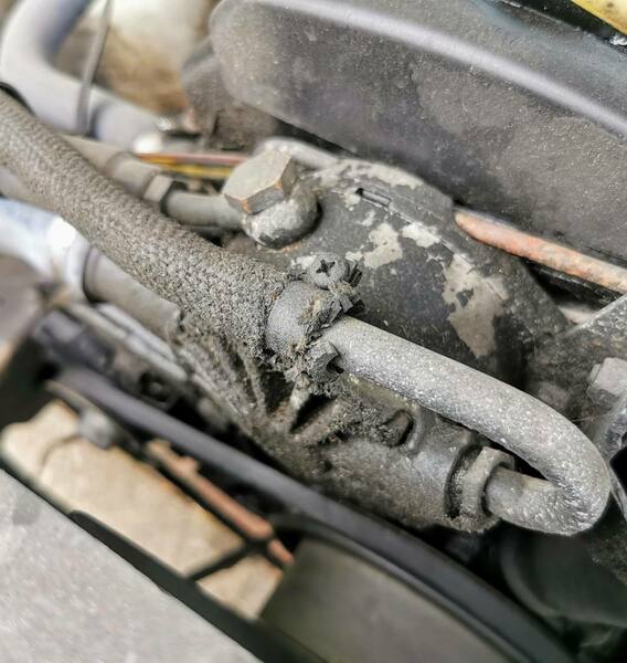

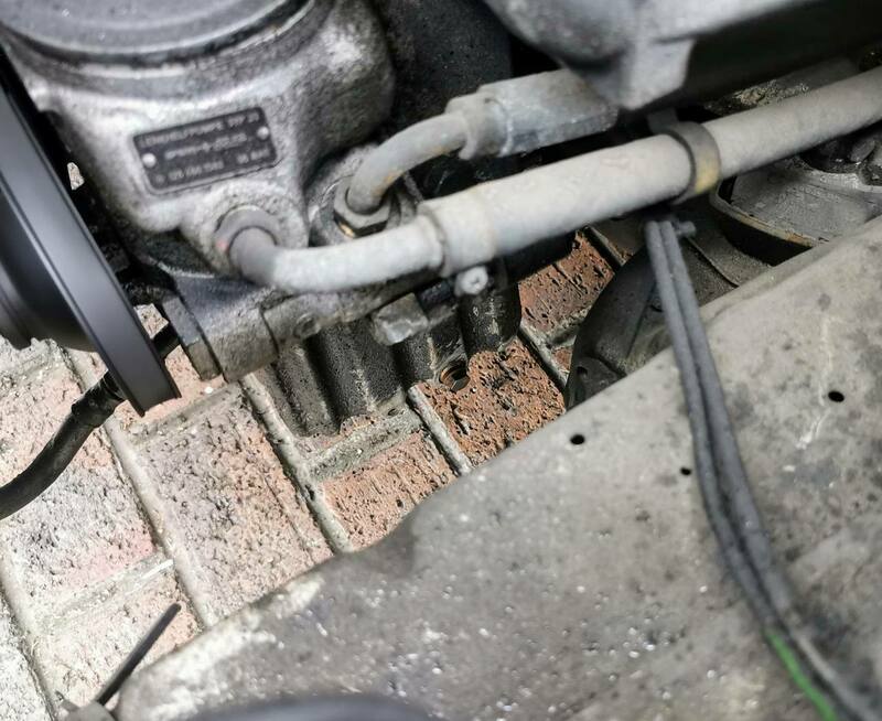

Speaking of rubber that needs changing, the supply line for the self leveling suspension is looking rather sorry for itself.
Will look to get that changed soon.  I do need to confirm what type of fluid this uses - though the initial glance at Google seems to suggest that it's basically LHM with a Merc logo on.  Which would be nice as I've a load of that in stock.

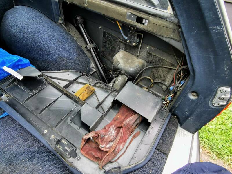

Realised this afternoon that I'm going to need to spend more money before the proper cleaning can start though as my pressure washer died a couple of months ago.  This shows that she really needs a good clean...
I think one of the first  on mechanical issues will be seeing what I can do to straighten this out.
This panel needs to come out anyway for two reasons.  One is to replace the tailgate gas struts, the other is to fit rear speakers as there currently aren't any.
The moulding is basically fibreboard and I imagine has got wet at some point.  Hoping that with a bit of persuasion I might be able to get it to sit flat again.  Apparently getting this hooked back in place is a pig of a job so hopefully I'll only need to do it once.
Regarding that suspension hose - have a read around 1st before you touch it if it’s not actually leaking. I have a hazy memory of one being NLA but I can’t remember if it’s the one from the reservoir to the pump or the one from the pump.
I think it is LHM that it uses. That was about the only fluid that I didn’t change so god knows how long it’s been in there.
As an aside, it was also never particularly water tight in terms of cabin leaks,  so I’d recommend covering it if keeping it outside and not using it that often, when the weather changes.
Thanks for the heads up.  She's going to be in regular use so hopefully any water ingress issues will be tracked down reasonably quickly.
The hose is the intake from the tank to the pump.  Not too worried if the factory one is NLA as it's just a bit of generic hydraulic line at the end of the day - it's just a jubilee clip and barb connection at both ends so doesn't need to be anything special (beyond being resistant to mineral oil obviously).  The fluid does look pretty manky - it's definitely not the colour of LHM, but that doesn't mean anything.  It definitely *smells* like LHM.

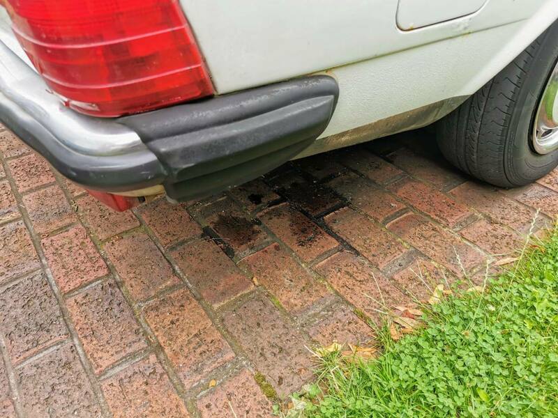

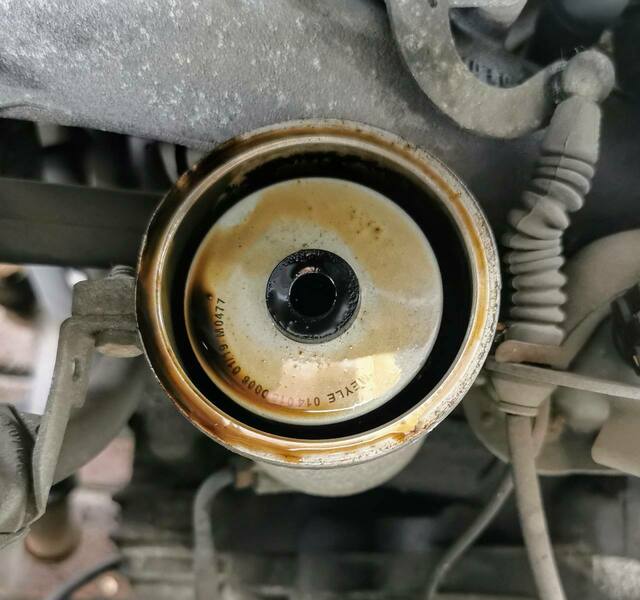

Yep...we do have a fuel leak when the tank is fullish and the car is moving.
It's not on the supply/return circuit, it's definitely just caused by fuel sloshing about.  I'll need to pull the floor out of the boot and see if we can see the gauge sender.  Hoping it's just the seal on that having failed as replacing that sounds way less hassle than dealing with a hole in the tank.

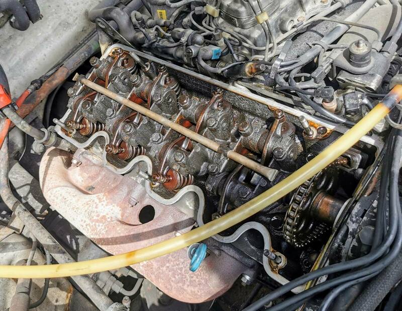

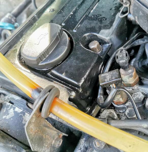

What you need to do to pull the rocker cover on a W123 with this engine:
Remove air cleaner housing (4 10mm nuts and pop two PCV hoses off).  Remove HT leads from the little plastic channel they sit in.
Detach the throttle cable at the engine end (little ball and socket setup, just pops off) and feed it back through the cable bracket.
Remove the nuts (noting that one is a bolt and post arrangement to hold the ATF dipstick in place).
Lift off rocker cover.  Time taken?  10 mins tops.
It's almost like someone actually put some thought into maintenance access.

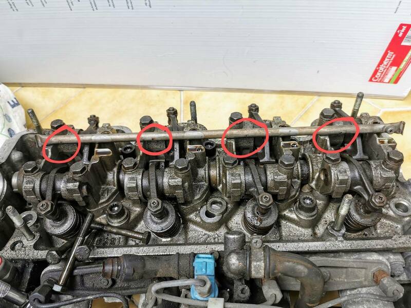

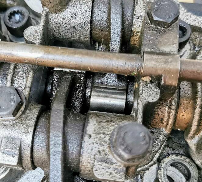

As expected given the previous threads on this vehicle there's definite evidence of this poor engine having been quite neglected earlier in its life.  Grubby is the word that springs to mind.
The camshaft has definitely suffered - the lobes on the exhaust cams for cylinders 2 and 3 in particular have some impressive scoring.
This folks is why you should change your oil & filter regularly.
Valve clearances were a mixture of slightly loose, perfect and slightly tight.

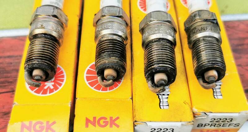

The plugs which came out look okay to me, albeit with number three showing slightly more by way of deposits than the other three (1 is to the left, 4 is right).
I think the engine is slightly quieter now, though she's still quite tappety.  I reckon I'm probably on a doomed quest to try to quiet it down much given the state of that camshaft.
Does anyone know if the camshaft can be swapped easily on this engine?  I know it's not the case on the XUD because the camshaft and head are line bored as a pair...no idea if that's true here.  If not I've probably got a solution on hand.
With the car came an entire spare cylinder head...on which the camshaft lobes look like this.
Nice and shiny.
So my thought would be at some point to transfer the camshaft and rocker assemblies over to the head in the car.
One thing I will be trying first though is to pull that spray bar off and making sure it's fully clear...given the amount of gunk present it wouldn't surprise me if several of the holes (particularly over 2/3) were clogged.  I didn't just do that on sight today as I've not checked if there are single use seals under it or anything like that.
After a quick test run it looks at least like the rocker cover may now be oil tight.
Let's see if it's still looking that way after a few miles have been covered.

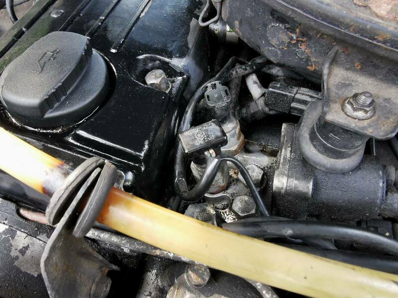

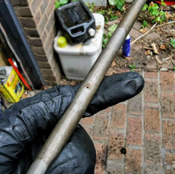

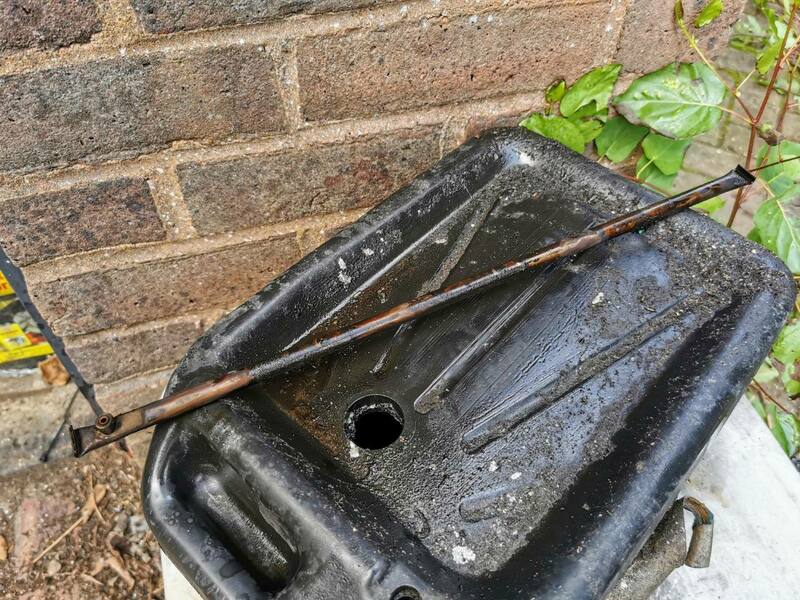

Decided given we had obvious signs of poor lubrication on the camshaft that at least verifying that we had clear holes in the spray bar made sense.  Especially as I had a spare present on the spare head.
Here's it having just been removed - it has four pretty small holes in it which provide a drip feed of lubricant to the cam lobes, one for each pair.
They are pretty small.
Despite this head being about 93% cleaner than the one on the car, only two of the holes in this were clear... doesn't bode well for the one on the car.  I gave the "clean" one a thorough clean and got it flowing nicely.
Ten minutes later, had them swapped over.
Having clean metal to contrast it against really highlights how grubby that top end is.
All back together.
Has it made any audible difference?  Not really.  Though at least I know there's a good chance of lubrication getting to where it should now.
The old one was pretty manky indeed.
Only one of the holes was clear, one other was about 50% clogged and two were completely missing in action - and you couldn't even see them for the gunk...so I think this was worth doing, even if most of the damage is already done.  I feel better for knowing it has been checked out and cleaned at least.
Having got to a point where I think I'm done messing about under the rocker cover for a bit it was now time to change the oil and filter.  Went out for a run first to get everything nice and warm and to ensure as much of the gunk was stirred up in solution as possible.
Sump plug unsurprisingly is really easy to get to and came off without excessive effort.  What came out was really dark but I've definitely seen worse.  It was dark brown rather than black ink like you tend to find in diesels.
Oil filter has some crud immediately visible on top of the filter even before it was pulled out.
This definitely looks to have done its time...the fact that part of the filter has collapsed tends to suggest to me it's a bit plugged.
It has actually pulled the element away from the top cap there.
Out of curiosity I will dissect this filter to see if there's any evidence of issues visible.
New filter in, new O-ring and copper washer fitted to the filter housing...
The old O-ring had (like the rocker cover gasket) pretty much turned to plastic.
Double checked I'd refitted the sump plug... possible to do easily from next to the car as you have line of sight of it.
Then refilled with some fresh oil, started up and checked for leaks.  None present.
I'm not used to seeing this sort of thing actually making any visible difference...but this has where hot idle oil pressure is concerned.  When at full temperature, in gear at idle I used to see 1 bar or fractionally above of oil pressure (it jumps off scale as soon as any revs are really used).
So it looks like I've gained somewhere in the region of 15psi of oil pressure at a hot idle.  Not going to complain at that.  I may try 15W 40 for the next change (10W 40 or 15W 40 are recommended) and see if that makes a difference.
Think my oil change program on this car is basically going to be "Change it as soon as it starts to look dirty" for a while.

After 30 or so miles today the rocker cover still looks to be oil tight...except for the oil cap which looks to be weeping.
I did check that the PCV was clear when I had the cover off and it seems to be.  The problem I think is actually that the paint is flaking off the rocker cover meaning that the sealing surface isn't flat.
My solution is pretty simple...scrape the remaining paint around the cap sealing surface (having stuffed a rag in there to catch the flakes).  Yes I did spot I'd missed a bit after taking this photo.
We'll find out next time I have the car out probably tomorrow.

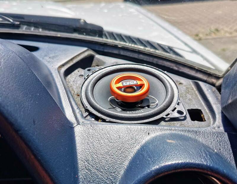

Only other thing I did today was to get the new front speakers fitted.  These had been upgraded at some point in the past, I'd say somewhere around 2000 based on the speakers found.  Discovered why they rattled so badly... because they weren't screwed in.  Just sitting on top of the dash.  Turns out this has also has resolved one of the main rattles in the dash in general.
The new ones are just cheap units (all of £16 from Halfords) but that really does show how far speaker technology has come over the years in that they're far better than the Sony ones that came out.
The dash moulding here is actually metal under the surface so now these are screwed down they are very securely anchored.  The grill just fits over the tweeter thankfully.  Equally thankfully the neon orange is completely hidden behind the grill.
The passenger side one sadly has one broken clip on it so the grill doesn't clip down securely at the front edge, I'll need to see what I can do about that - as I'm certainly not paying the £50 someone is asking for one of the covers on eBay at the moment.
I need to take some measurements to confirm if I have enough depth to play with, but if so I'll probably just throw a set of the same speakers in the rear.  As you've only got little 4" enclosures to play with (though the front ones do have proper acoustic foam in the enclosure behind them) I don't really think there's a huge point in paying big bucks for speakers.  What I'll probably do is look into getting one of those little self contained under-seat combined sub and amplifier boxes to just help things sound a bit more rounded out.  Should be easy to just run the wiring through the centre console as well without needing to dismantle too much.
Speaking of wiring...I really do hope that Mercedes included wiring for the rear speakers as part of the loom as routing wiring all the way back there will be a major faff.  Especially with the speakers being mounted in the head lining.  Not holding my breath there though!
I know audio is really low priority compared to a lot of things, but it's one of those things which make the car nicer to live with so I'd like to get it properly sorted sooner than later.

Huzzah.  Congratulations on the s123 purchase.  I've mused many a time that I would absolutely bloody love one of these, especially with a petrol engine and the matching wheel decorators.
The problem I now have, is what I'd sell to make room for one.  The Escort Kombi proved that it is helpful having an estate on fleet, but 90% of the time the hatchback (Sierra) will deal with the task at hand admirably.
The other problem is most of the nice ones are pushing £10k with dealers who can afford to sit on them indefinitely.
This was, no doubt, a decent buy.  Looking forward to you steadily improving it over the coming months.  It looks ace in front of your Motorhome (is it a 207D? - i had a 307 briefly!)
Hmm...can you tell which panel I experimentally gave a wipe clean then hit with the polish and wax?
Looks like the paint might actually come up better than I expected.  The actual colour change was a surprise!
Tyres have now been ordered, garage have said they'll just give me a call when they're in and I can just drop by then.  Will be nice to have that done as the current set vary in age from 2017 at the newest to 2010 at the oldest and all have pretty significant perishing.  Front two look superficially fine as the sidewalls are OK, but they're cracking up inside the tread area instead.
I always like to have a matched set of tyres on a car anyway so this would probably have happened anyway...as it is though these have had it.  While being able to provoke a drift at just about any speed on a damp road is occasionally fun it's less than ideal in the real world when you're just trying to pull away from a set of traffic lights on a busy signalised roundabout.
I'd stopped even looking at these a few years ago because of the way prices had gone.  It's a car which had always been on my bucket list, but never thought I'd get hold of one.
When this one popped up though I figured I had to go for it.  It's pretty much exactly the car I would have specced from new to be honest even down to interior and exterior colours.  Only thing which would have made it better would have been air con - though it probably wouldn't work even if it was fitted!  The huge sunroof and bloody effective blower fan do at least make a good effort at balancing it out too.  The blower set to 1 pushes through about as much air as the Xantias one did at about 85%.
Does prove though that if you keep your eyes and ears open there are still examples out there that change hands for not insane money, even if they are inevitably going to need a bit of TLC.
Van is indeed a 207D, in normally aspirated 2.3D flavour.  With a far too ridiculous exhaust that I really need to figure out a reasonable way to tame a bit...and just stop procrastinating about it and buy a new bonnet.
If I had even half a brain I'd polish it up and sell it now with how the prices of campers have gone...but I know full well that I'd never be able to get another one.  I'd wanted an old Merc van since I was about 5 when we hired one to move house with.  The life size Tonka toy looks and bus-like dash immediately hooked me...but I could never justify just buying a van for the hell of it.  We had discussed possibly getting a family camper though...so when this popped up on here a few years back it ticked *both* of those boxes so I immediately grabbed it.  Always puts a smile on my face driving it too.
Even though I reckon the van and car both having the same single multifunction stalk but on opposite sides of the steering column is going to mess with my head.
Prior experience with the Cappuccino has shown that getting my brain to switch to the indicators being on the right is easy.  It's switching back that messes with my head.  Much to the amusement of my parents when I used to visit them in the weekends back then.
