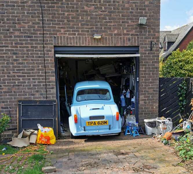

Had a couple of hours today where I was actually feeling vaguely human and the weather was looking decent.  So I said screw it to the stuff around the house that needed doing and instead pulled TPA out of winter hibernation.
Started first try, didn't even smoke.  Think she was out briefly once in February, but hasn't had a decent run since December.  It was February when I fitted the new voltage regulator, and I've never done a test run since then.
Charging system looks to be behaving so much better now.  Jumps up to 13-14V pretty much as soon as you're above 1500rpm or thereabouts, and stays there rock steady.  To get really meaningful charging before I basically had to be going fast enough to have the CVT maxed out.  Now if I'm moving I have good system voltage.
Hard to say as I wasn't out for a massively long run and it's been a while since I had the car out, but it honestly felt like she was pulling better at high revs, just felt as though she was holding 60 easier than usual.  I guess it's possible that the generator was bleeding off some power at the top end (I was seeing nearly 16V on the voltmeter at that sort of speed), which isn't now happening as it's being properly regulated.
Only thing I noted that wasn't too happy after the hibernation was the handbrake felt really gummy.  It's definitely at the front end of things rather than rear of the cantilever mechanism under the floor.  I can't quite tell if it's the cable itself that's sticking or the lever itself.  I've lubed both up and it seems better, hoping it will free off fully with a bit more use.  While I had the grease out I also gave the door runners a thorough greasing...I hadn't realised how bad it had got.  First time I opened it afterwards I just about threw the door off the front of the car!  You can slide it with one finger now.  I really do need to properly sort the rollers on the door at some point...that's not massively high on the priority list though to be honest.  Priority one right now of course is getting the lovely newly repaired hub fitted.
We've got a guest staying for the new couple of weeks though, so not expecting to get a chance to do much of anything for a while.  I know they're going to want to see TPA though, so seemed all the more reason to pull her out of hibernation.
I always forget how much this little car makes me smile.  I'd had a pretty crap morning and in the last hour before I wandered into the garage was quite shaken up by a run in with a very aggressive driver in a BMW threatening me.  Felt a lot better after getting TPA out for a run on a nice sunny afternoon when the roads were actually pretty quiet.

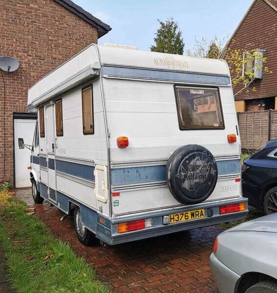

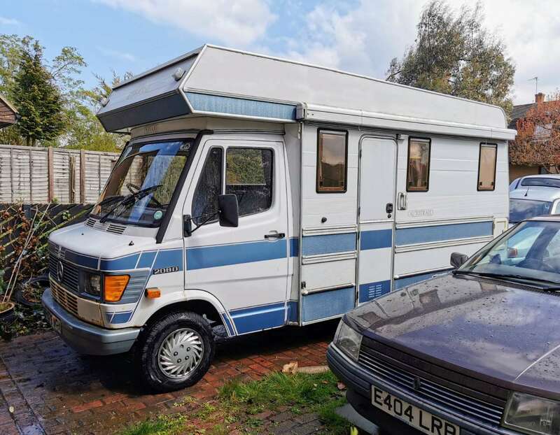

Which left me needing to abruptly bring the van fully back out of the winter lay up as I needed to provide transport for a trip out for our guest which took us about an hour away.  I'm not going to cram someone in the back seats of the Caddy for a run that long (especially as both of my passengers are quite tall!), so it was up.  Main job that was needed was the first wash of the year...It had turned rather green over the winter!
Three hours later it looked slightly more presentable.  I'm not going to go so far as to say clean, but a good deal cleanER.
I always forget when it's been a while precisely how much of a mission cleaning that thing is.

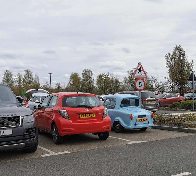

Later in the day I also took the van out to the supermarket, because I've paid my road tax just the same as everyone else, and because I can.

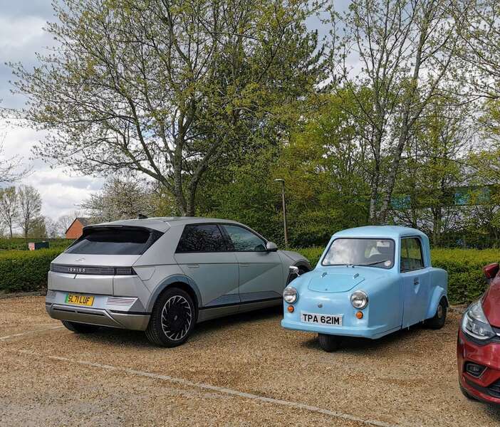

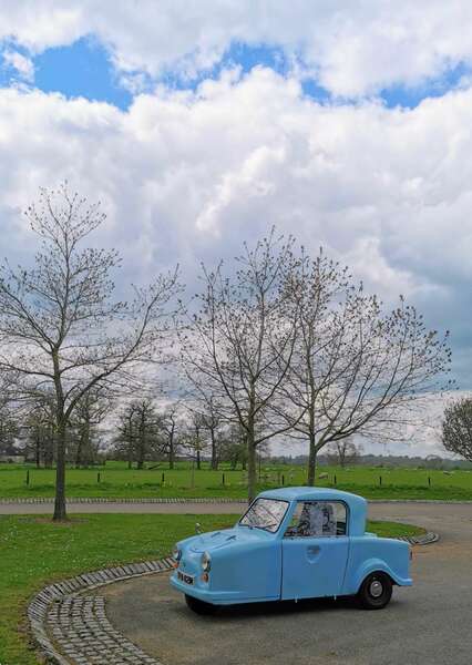

I have a long history of forgetting that Drive It Day is actually a thing, but this year actually remembered so made a point as the weather was lovely to pull TPA out and go for a wander around.  Can't actually remember the last time I went out without a destination in mind.
Something very modern looking and something very much not...
Then about as close to a scenic photo as you can get in Milton Keynes I reckon.
I was out for about an hour and a half and covered about 30 miles.  Sadly the only car of any note I spotted at all the whole time was a sole white MGB - which I spotted about 1/2 a second too late to wave the the driver as I was concentrating on dodging a couple of meteor craters masquerading as potholes at the time.
Did give me the opportunity to actually get out on the main road though, and I can definitely report that she's cruising more easily than she used to at around 60.  So looks like the generator being properly regulated rather than just trying to pump more and more power into the battery actually does make a difference.  Nothing else has been touched mechanically so that should be the only variable to change.  To touch the coil feels to be running cooler as well, though that's hard to say for certain - though with the whole vehicle system sitting at ~16V when running at speed beforehand it would make sense for electrical things to be running cooler.

as a side note, is it me or does it look like its got the Grill off an AEC something or other? maybe its a bit squished, but its even got the Triangle for it!
