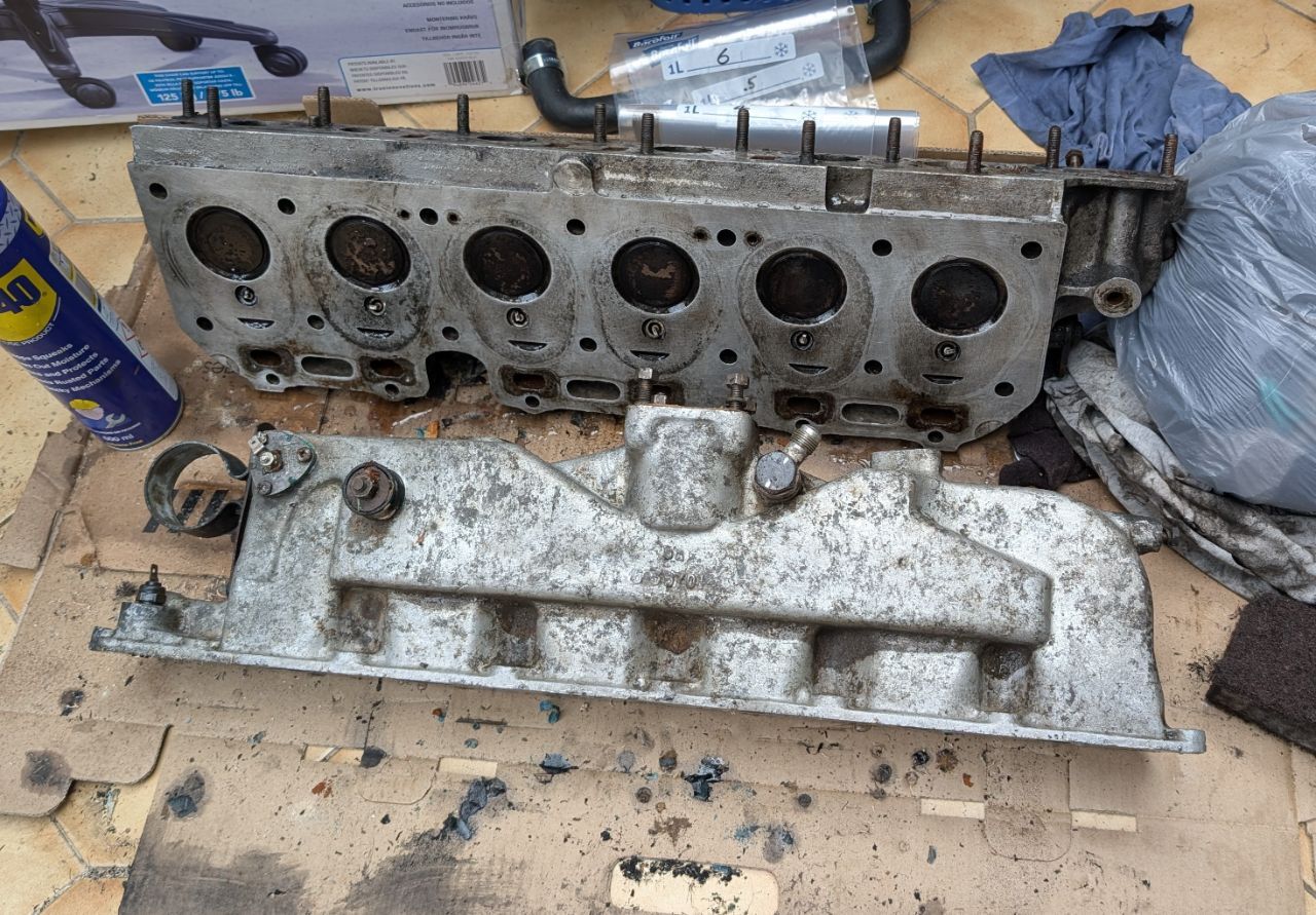

Did finally kick myself into actually doing something with this today.

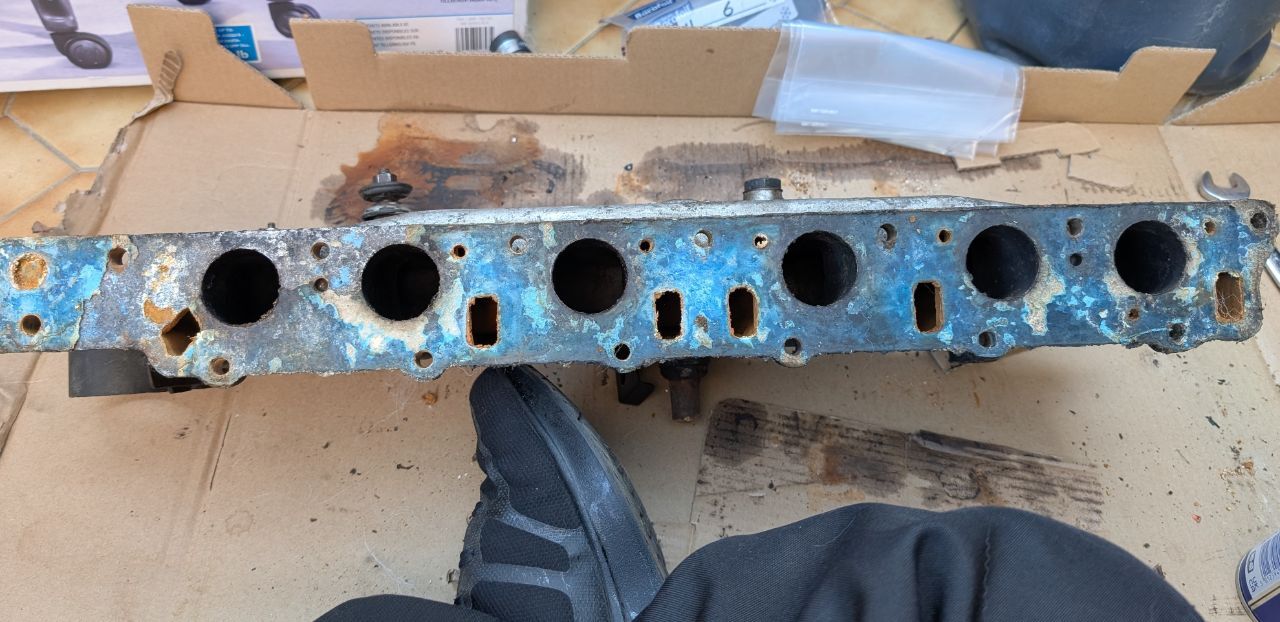

Whoever last had the inlet manifold off apparently decided that rather than replacing the gasket that they'd just use about five tubes of blue Hylomar and smoosh it together.
After what felt like an eternity I got most of this crap off.
It still needs a last going over, but it's getting there and the vast bulk of the crap is off.
There were two small coolant passages that were totally covered by the goop.
There is some pretty gnarly pitting in one area, but it's just in between two coolant passages so I don't think will cause any real issues.
Then need to do the same on the head and clean the underside of it as well.

53 minutes ago, High Jetter said:
If they did that to the inlet, what's the head like?
Thankfully (aside from where the inlet manifold attaches) it's just a grubby head.  Being a plain metal gasket a lot of the usual scrubbing is actually dodged as the gasket doesn't disintegrate as the head is removed like composite gaskets tend to.  So it's basically just scale around the waterways and carbon that needs scraping off.

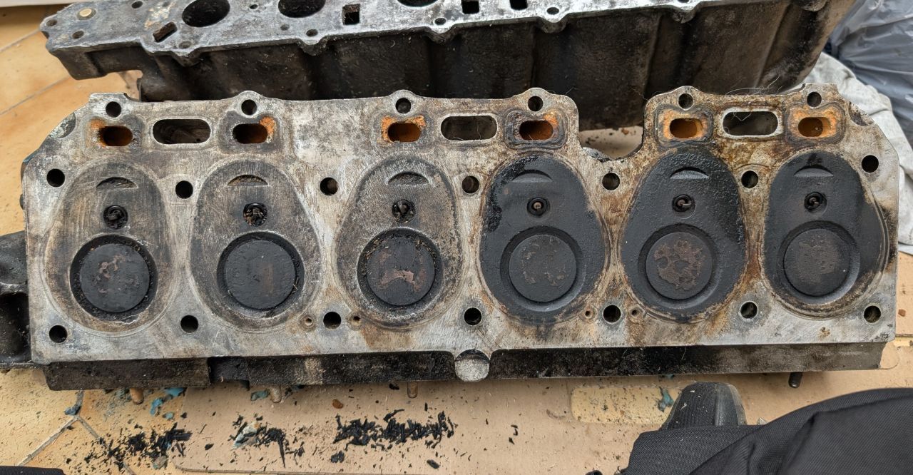

Okay, I think this lot is as clean as it's going to get.
In progress shot.
Head seems perfectly straight as best I can tell with the equipment I have.
All of the coolant passages in both the head and manifold were blasted out with the pressure washer as the manifold in particular was quite full of crap.
There's still some staining around the edges of the combustion chambers but it feels perfectly smooth and uniform, so I think will be fine.

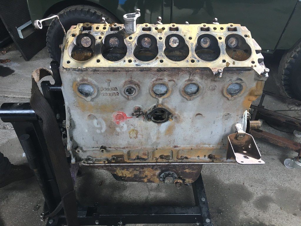

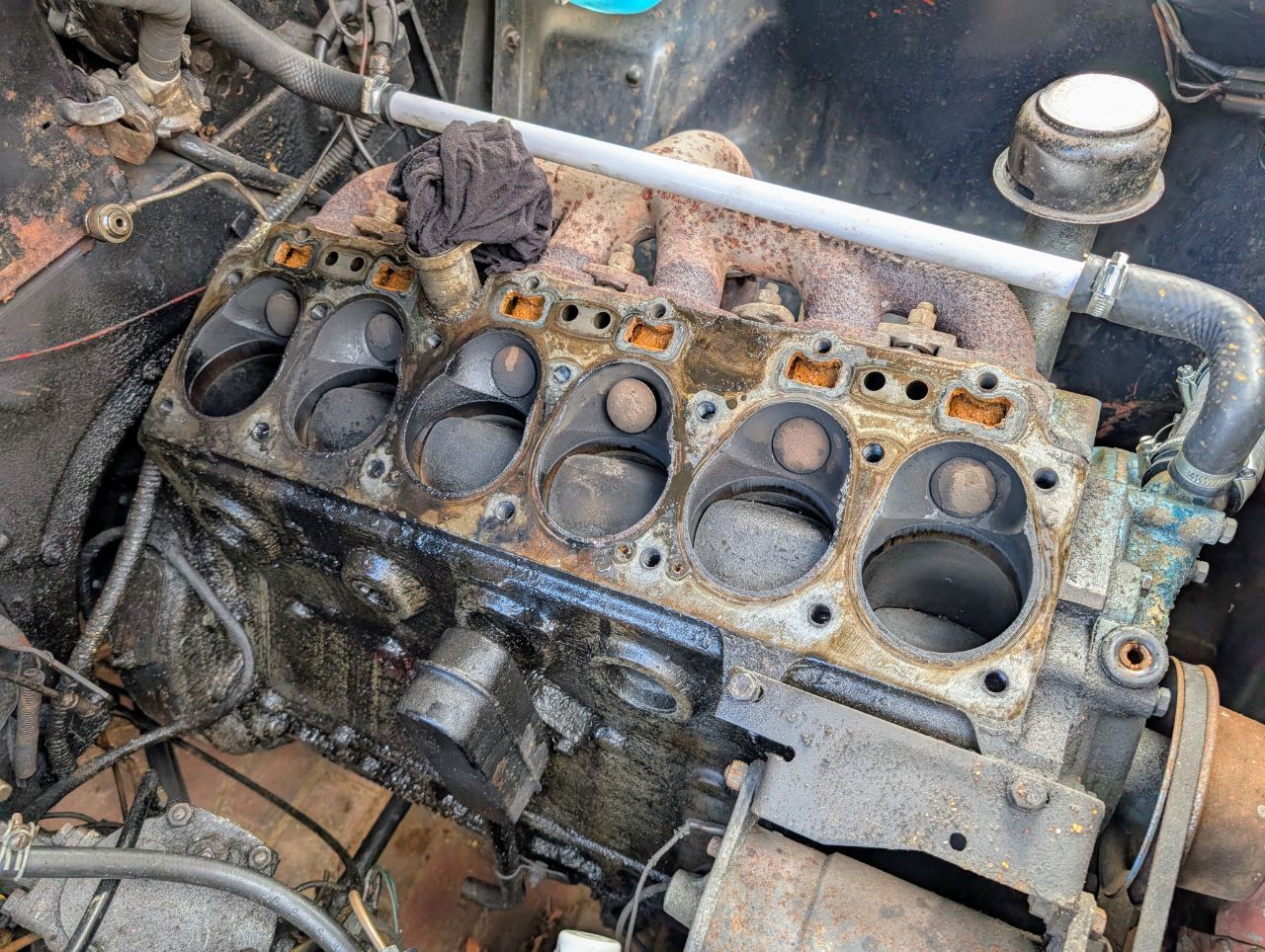

The block was a disgusting, slimy mess.
Not going to win any prizes, but it looks a lot better after I unloaded a few cans of degreaser at it and then attacked it with the pressure washer.
There was a tiny bit of buildup around the water passages, but this was far cleaner than the head, and I think is basically just discolouration rather than there being anything of substance left there.

Biggest holdup is that given there are a few areas on the inlet manifold which are pitted, I do want to put a bit of sealant on there to help the gasket out (a *sensible* amount rather than the several tubes worth that went on last time around apparently).  Discovered that my previous tube has turned to a rock at some point in the last year.
Figured it would be something Halfords would have...nope!  Maybe I can grab antifreeze while I'm there at least.  Not a chance, any modern flavour I like, but not a single bottle of the old blue stuff...Well that was a waste of my time, and some twat has scraped the passenger side mirror on the Volvo while I was parked.  Great.  I'll go grab both things from elsewhere tomorrow - an hour and a half round trip I could have done without.

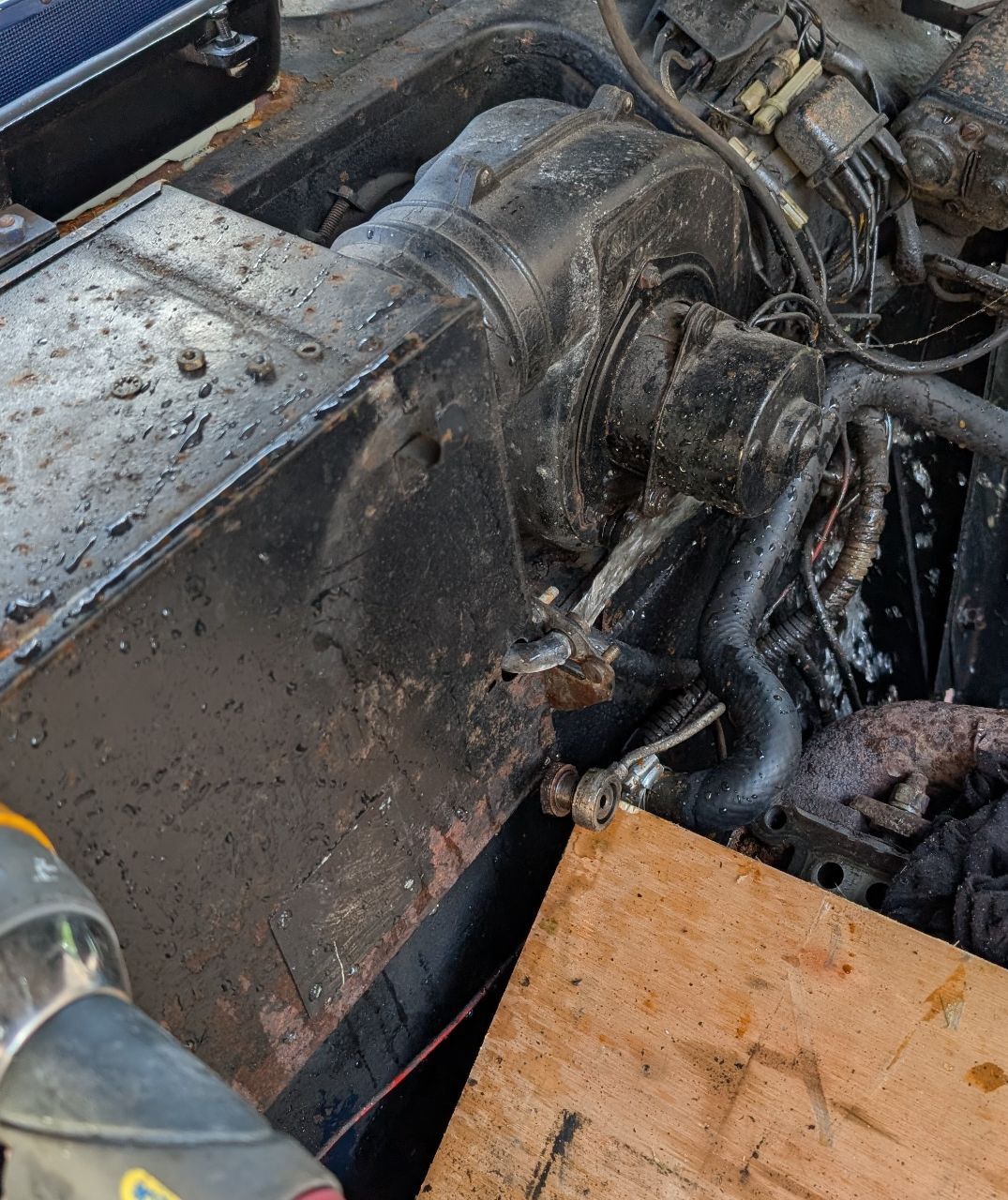

In better news, with the jammed valve removed, turns out we do have perfectly decent flow through the heater core itself.
Not even all that much crap came out.
The valve however is a block of aluminium oxide and rust and is beyond saving.  They're not expensive so I've got a new one ordered.  There should have been an O-ring between the two parts of the connection which was completely missing...so I'm guessing it was purely sealed by scale and rust!

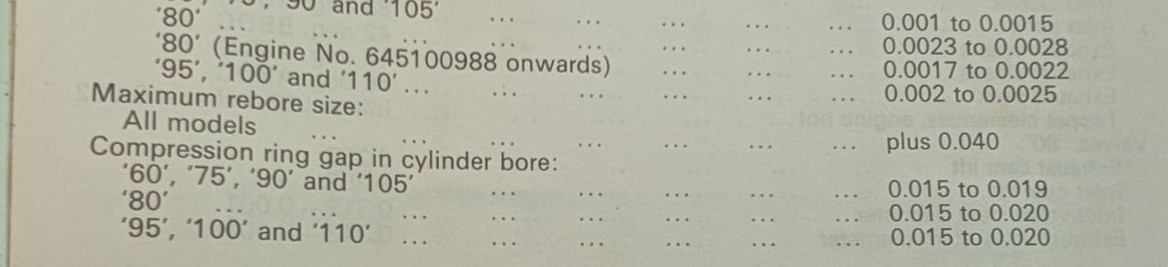

I hadn't noticed the "40" stencilled into the side of the block before.  Anyone know if that means anything?
Elsewhere someone had asked what state the bores are in.
This camera really doesn't enjoy stuff like this.
Looks good to me, no wear lip I can feel, and you can just about still see cross hatching in the right light in person .  Nothing ringing any alarm bells for me anyway.  Not that I really expected there to be.  The engine seemed to be running okay and didn't have excessive amounts of blowby or smoke, so really wasn't looking for any issues there.
  • Zelandeth changed the title to Zel's Motoring Adventures...Volvo, Renault, Rover, Trabant, Invacar & A Sinclair C5 - Updated 28/09.
Dunno..  Our old Sony Handycam  video camera had  'nightshot '  , i guess infrared . Lights out aim it at the hob, you could see the elements like an x ray.. Then , i had an old fusee wall clock to fix ,. On the door was some faint pencilled marks.. Lights out , under the video camera , now plain as day , it was a name and date of a previous repairer from 1910...  Try looking under IR or UV?
I did wonder about a rebore marker - maximum allowed is indeed 40 thou according to the manual I have.
Though the photo above does kinda raise more questions than it answers in that case.
Probably something totally random to anyone outside the factory like a date code or similar.
Going by the picture from @Christine above with 93 on the block, it's possibly something put on during production? Cast/production line/etc number maybe?

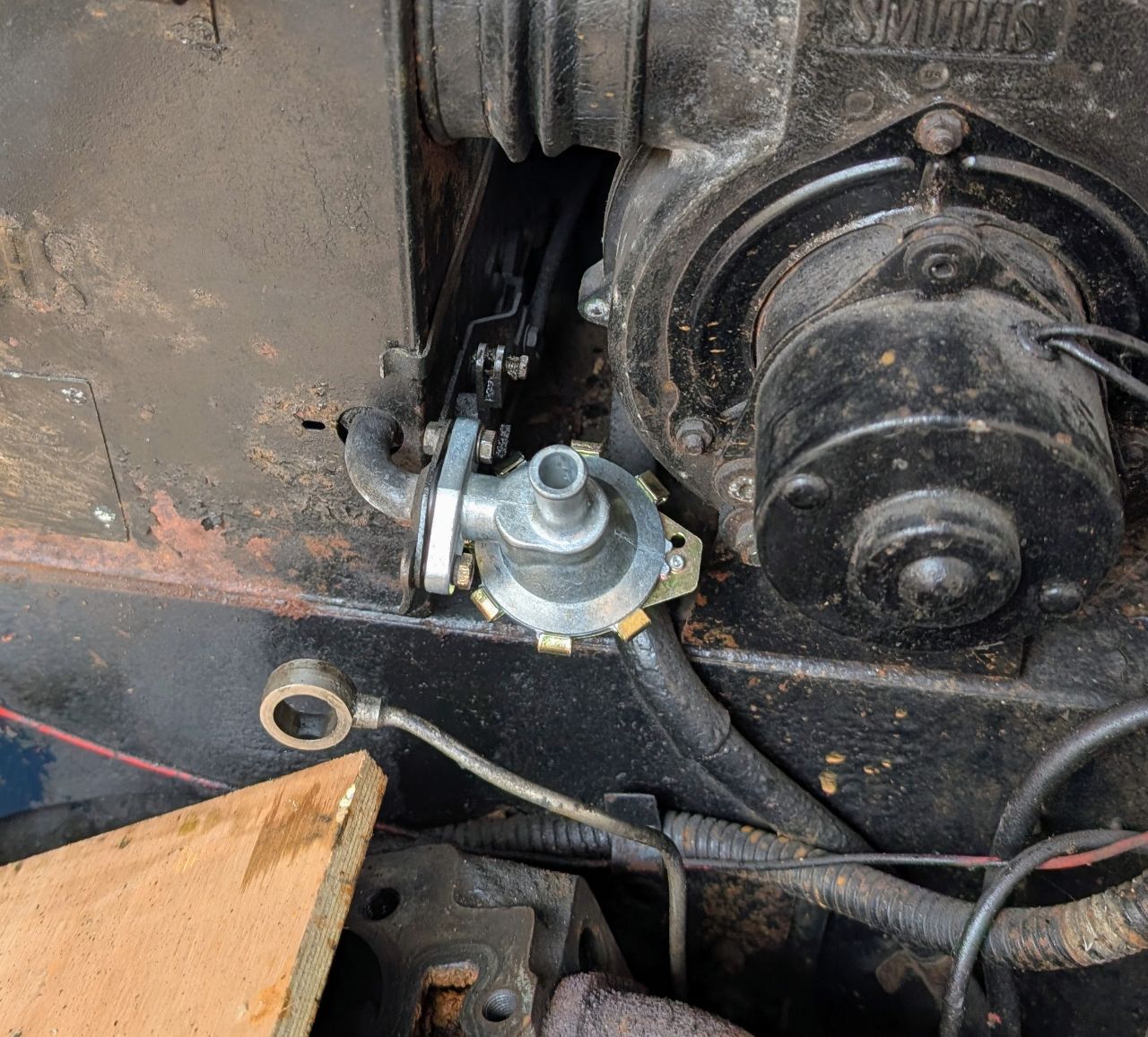

On the plus side I did get the new heater valve installed.
Old one had definitely seen better days.

Finally had a little bit of spare time this afternoon when I both had a bit of energy and it wasn't hissing it down with rain.
Before:
After:
I only had half an hour so still a bunch to do, but the head is on and properly torqued down.  At least it's not open to the elements now (rocker cover was sat in place before I tidied up).  Hopefully one more session I'll have the engine running again with a bit of luck.
Just glad I've actually done *something* with it for a change.

Eventually got this all back together.
I think we have a pretty clear answer to the question "did the head need to be worked on?"
The fact it's running on four cylinders and you can actively see gases being discharged between the head and gasket suggests that the head was Indeed not flat enough.  Or there's a bit of crud in there I failed to clean off properly.  Note it's not boiling off in that video, the engine is stone cold there and has been running for less than 30 seconds.
I did go back today and double check all the boot torque values and they are all fine.  So something is amiss with either the head, block or both.  I did check to see if it was flat, and best I could tell with my equipment it was.  However a couple of folks have told me that this style of gasket really isn't forgiving of any imperfections.
I'm guessing soot must have partially sealed some of the leakage from the previous one.
Yay I get to take it all apart again.  What fun.

Have found one possible cause for at least some of our issues - both the gasket that came out (and subsequently the one I put in) were apparently both upside down.  Stumbled across a NOS gasket photo when looking to grab the couple of bits I'll need when doing this again and it's clearly stamped "this side up" the opposite way around to mine.
Without any other reference to hand at the time I put the new one in the same way around as the old one came out - which I now know is wrong!  Not sure how much difference this would actually make in the real world, but I'm guessing it can't help!
Also immediately obvious in the photos how much better quality the stamping of the NOS gasket is than of the modern part.  I guess no surprise there.  Two NOS Unipart Corgasyl gaskets ordered - one to use, one to keep in the spares stash as insurance against ever needing to remove the head again.
Will still be getting the head checked over obviously.  Would make me laugh if this was the root cause though.
