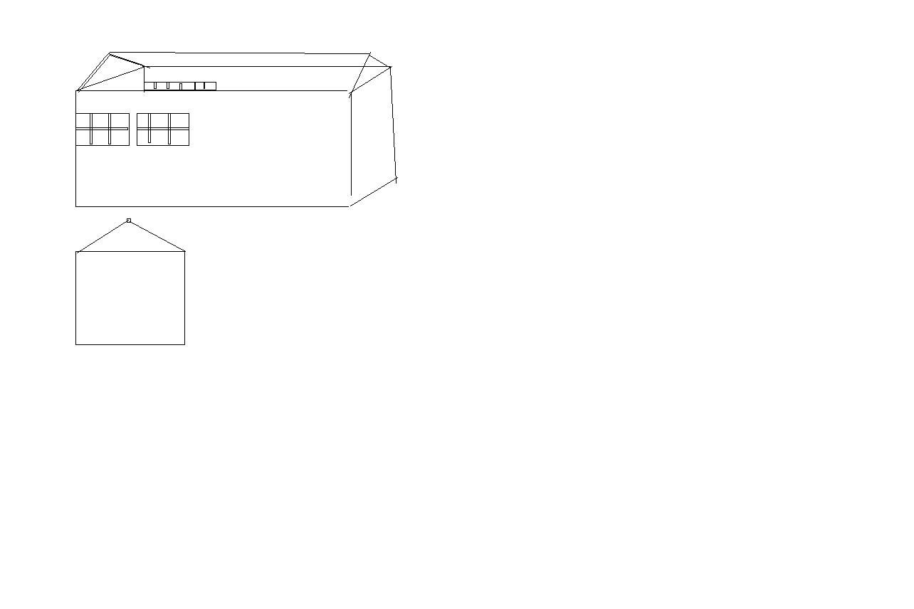

I want to build FiL a small garage .. 16ft x 8ft  i assume a mk3 astra hatch will go in, just ?
I've got 323 linear ft of 3 1/2 " t&g  and
            401 linear ft  of 4 1/2   t&g..
I have 4 off  windows in frames   37" long  x 31" high
and a side door 29" x 77"  that could be used too..
Assuming i can use existing double doors on one end ...I want 2 sides and one end,  and the end   is pointed for a pitched roof...
I have tons of 4x2  an 6x2  and 1" ply for the roof..
Have i got enough cladding?
Doesn't matter if the cladding is vertical or horizontal..
Sat here for 4 hours now and i'm no further ahead... :angry:
Not good at drawing either :-(
what i thought it would be like sort of..
Whats the height of the sides and apex?
Whats the width of the T+G not including the tongue?
if we know the height then it's easy to work the rest out, would be even easier if you would use modern measurements instead of ancient arcane measurements. (also known as what is it in mm please)
Is that why I'm stuck? :-(    Hang on I'll find a modern ruler ... :-(   31/2 " is 90mm  4  1/ 2  " is 115mm  that's what it'll cover without the tongue.  8ft is  2440mm  16ft is double that.. ah 4880mm?  Say 1800mm to the eaves
got 98m of 90mm
122m of 115mm  t&G
4 windows 790mm x 940mm
a door 750mm x 1960mm
Apex shallow ,I could probably find some wood for that if not enough t&g
Quick maths for
3 walls with no apex
16 foots by 6.6 foots  is  4.9 x 2 metres so about 10 squ metres
8 foots by 6.6 foots  is  2.5  x 2 metres so about 5 squ metres
apex, one at each end so    2 times         45 degree 45 degree 90 degree
Totals about 30 squ metres
Woods
0.09  (3 and a half)  x  70m  (232 foots)  =  about 7 squ metres
0,115  (4 and a half) x 120m (400 foots) = about 13 squ  metres
total about 20 squ metres
so wood alone not enough .

3.5"
6 x 12" = 72"
72"/3.5 = 20.5 round up to 21 - 21 x 3.5" high
21 x 16ft = 336 ft of 3.5" per side
4.5"
6 x 12" = 72"
72"/4.5 = 16 - 16 x 4.5" high
16 x16ft = 256 linear ft of 4.5" per side
Rear of shed Assuming 7ft apex
7 x 12" = 84"
84/4.5 = 18.6 Round up to 19
19 x 8ft = 152 linear ft 4.5"
I'd put windows and doors on the 4.5" cladding side to save more for the back, you might still be short though.
If your not sure take some timber and make some story sticks, mark 6ft then mark off 3.5" down the length to see how many pieces you need to get the height you want, then times it by the length of your shed in ft.
We have all done it differently, mine doesn't allow for a peaked roof and personally 1.8m is a bit low but your not far off. *My maths may be slightly off*
Very roughly:
Length of walls needed:
2.4m + 4.8m + 4.8m = 12m
Height 1.8m to eaves leads to 12 x 1.8 = 21.6 meters squared.
you have 4 windows which are an area of 2.93 meters squared
1 door which is 1.42 meters squared.
the 3 1/2 inch cladding is 8.85 meters squared
the 4 1/2 inch cladding is 14.03 meters squared
Cladding you have 22.88 meters squared and with the door and windows you have 27.23 meter squared
Edit also no wastage allowed for!
Aye you will have a bit of wastage as well, i usually allow 10% for timber faults/inability to cut straight.
I haven't accounted for windows and doors either in my calculations so you will save a bit there. 6ft is a bit short though unless your a family of midgets.

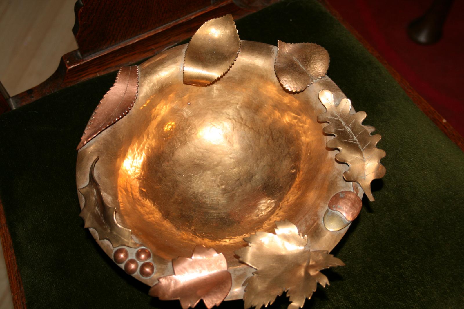

Mum made this bowl. She had to leave school at 14 and work in grandads shop.  First attempt at metalwork evening class 1978.
you can see who i got my so called talent from ?
That's an excellent bowl for the hundredth attempt let alone the first!
