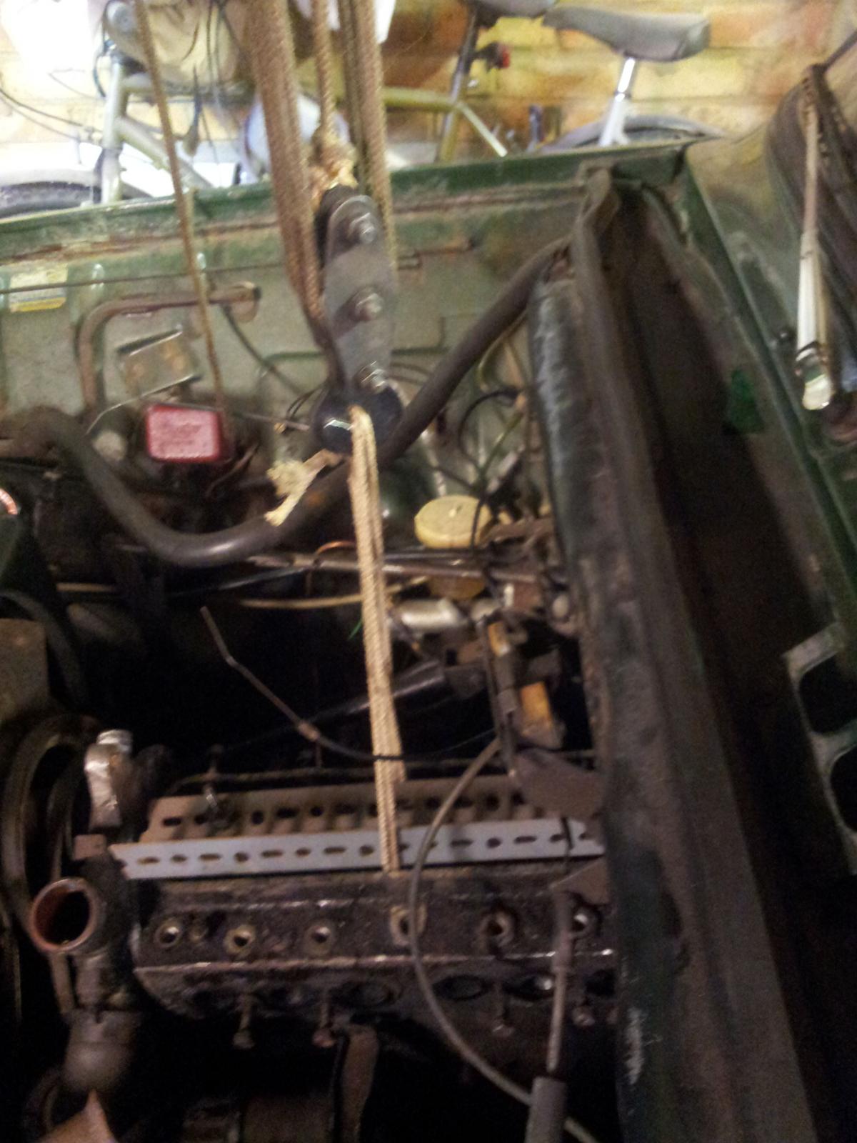

Attach piece of dexion angle to rocker cover bolts, apply engine hoist and raise front of car about 6 inches. One good clout with the copper hammer and the head parts company with the block. Cannot remove pushrods without removing seized rockers but after much fiddling managed to lift them enough to rotate the head clear of the bulkhead and lift it off.
What horrors lie beneath. Place your bets ladies and gentlemen.
In the words of that there Cilla Black: "Surprise, surprise".

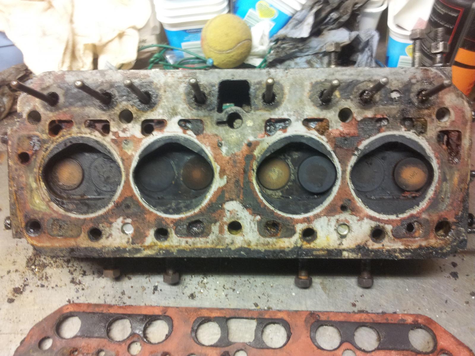

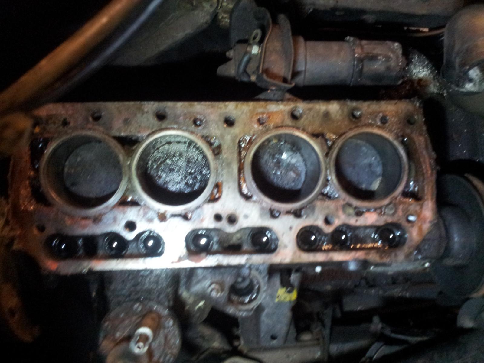

All the nay-sayers that predicted it would only be fit for scrap turn out to be wrong.
Pistons and bores look in good conditon with no sign of water ingress.
Tops of pistons a bit coked up as expected but bores not scored and only a very slight ridge at the top of each liner, just about detectable with a fingernail.
Valves all look reasonable and head gasket looks intact and shows no obvious signs of OMGHGF.
Tappets look suitably well-oiled.
Lots of crap in all the waterways though.

I guess I now need to try turning the engine over again with the head off.
Now the water pump is also out of the way I can hopefully remove the camshaft pulley and maybe bolt on a piece of bar to give some leverage.
But first I need to try and concoct a way of clamping the cylinder liners down.
If it still won't turn then maybe the next thing will be to drop the sump and check the bottom end.
What you need is Liner Retaining Clamps part no. Mot 12. :)
If only you had a thing that's like a cylinder head... :D
Available off the shelf from your local Renault dealer. NO CHANCE ! Or anywhere else in the known universe for that matter.
Only after I've (not) managed to remove the rocker arms, shaft and valves. Even then I'd really like to be able to still access the pistons to smack them with a hammer if necessary.
Big washers and lots of nuts on the head studs could be used to clamp the liners down.

Looking back at the photos of the rockers, they don't look that bad. Now you have the head off, could you now upend it and immerse the whole rocker mechanism in a container of diesel for a week, to get everything lubricated, then work at the rocker parts with a brass wire brush, flat bladed screwdriver etc. to get them cleaned up and persuade them to start moving again? IIR Joloke has had success with soaking rusty parts in vinegar and I'm advised that strong tea (with no milk nor sugar!) is also a good cleaning fluid for corroded metal...
On the basis that you have nothing to lose, you might be able to get it all working again.
Some sort of steel bar bolted across the top of the engine to stop the liners moving would work.
Otherwise, lubricate the heck out of everything, remove the pushrods, and bolt the head back on as that should stop the liners moving while you turn the bottom end over. Don’t be tempted to turn the engine over without something holding those liners in place as that would pretty much mean game over for the engine.
Mrs6c is right about the vinegar - https://sciencebob.com/clean-pennies-with-vinegar/ so it might work with larger components. Apparently molasses and water work well too but only if you have a couple of weeks or more

I'd honestly say leave the liners well alone. Clamp them down, lube up the bores and see if it'll turn over.
That is certainly going to be plan A.

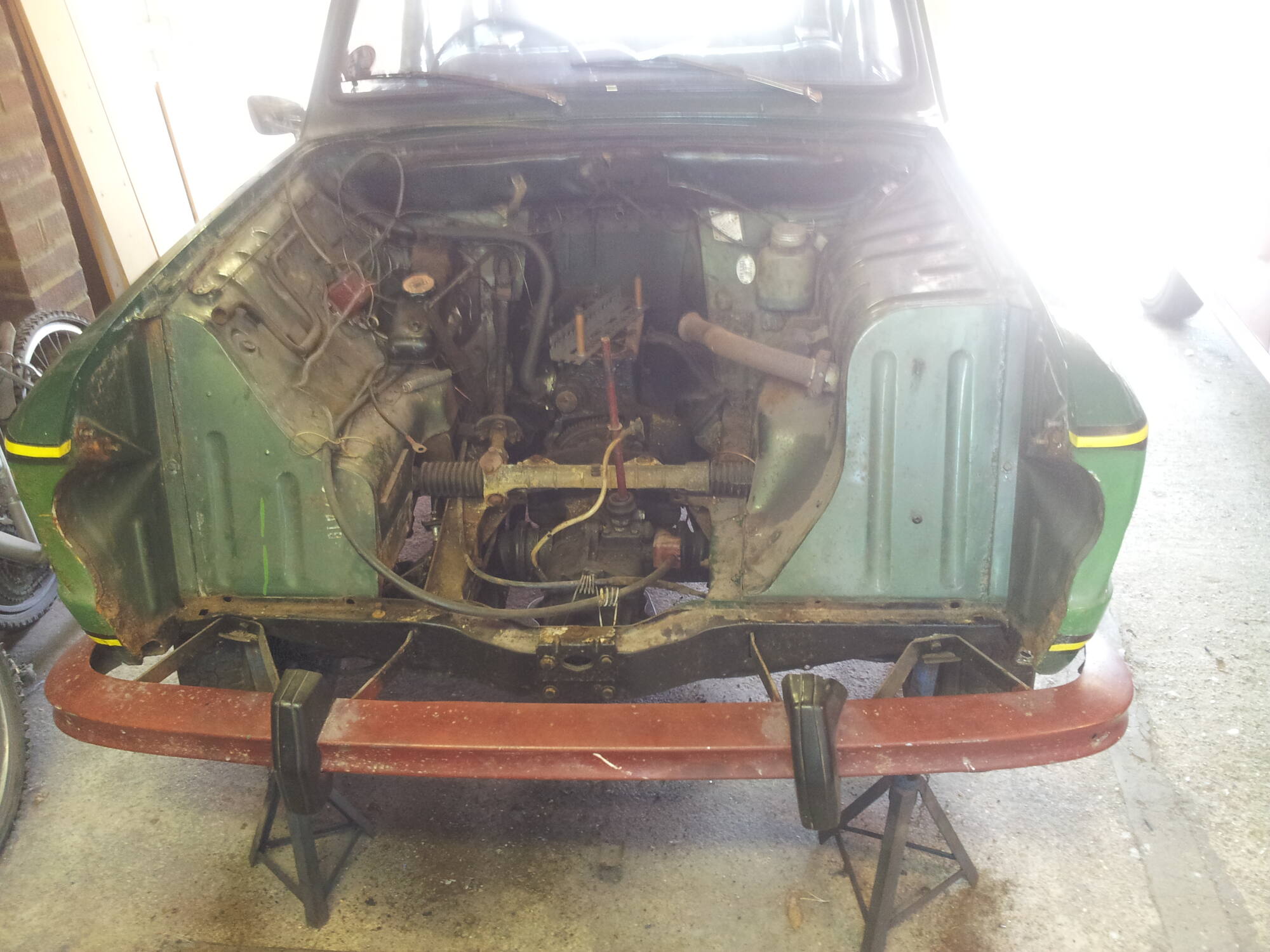

Neither the HBOL nor the Autobo11oks manuals mention removing the front panel to make engine removal easier, but explain how later on in the bodywork section.
Due to the terrible accessibility of some stuff I decided to give this a try.
8 nuts and bolts - 3 came undone eventually, 4 snapped, 1 rounded off and had to be drilled out.
8 captive nuts - 5 came undone under protest, 1 broke, 3 became suddenly uncaptive and had to be drilled out.
But after much faffing the front of the car now looks like this:
There is now more of the front of the car in the back of the car than on the front.
Accessibilty is massively improved and the radiator and clutch cable were removed in short order.
Note the length of dexion angle, two lengths of copper pipe and two head bolts acting as a (very) makeshift clamp for the cylinder liners.

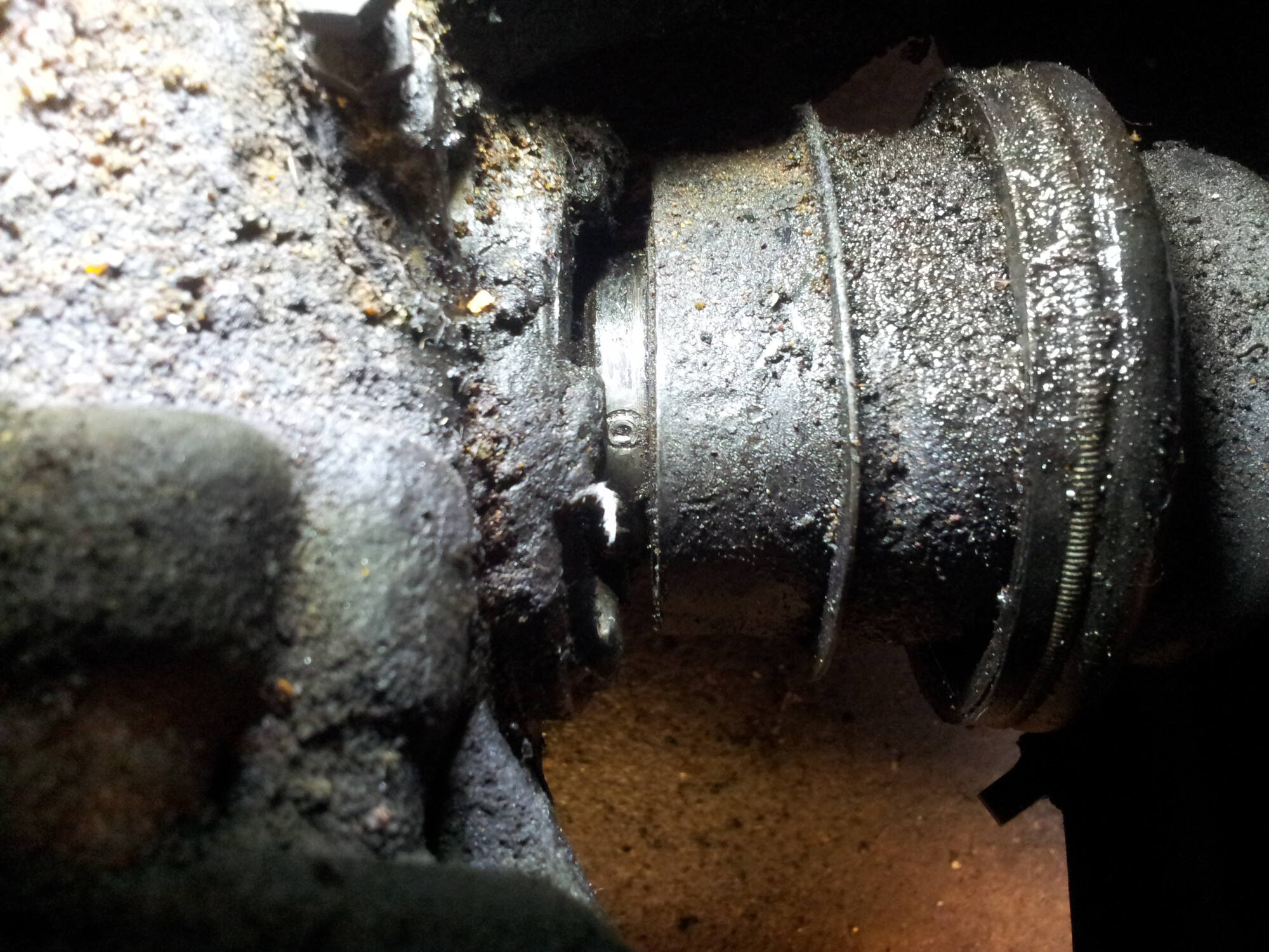

Now on to driveshaft removal. On these early Renaults the driveshafts are fixed to the diff output shafts by two concentric roll pins, a 5mm diameter one with a 3mm diameter one inside it. There used to be a Renault special tool to remove these, which I think is basically a stepped parallel punch, starting at 3mm for half the roll pin length then 5mm for the full length, but of course these are unobtanium.
You can hopefully see how accessible* these are here:
I have a 3mm and a 5mm parallel punch in my set, so set to with these. After much swearing and bashing with a large hammer the driver's side ones relented and came out. Flushed with success I moved on to the passenger side. The same procedure simply resulted in a bent 3mm punch. Frustrated by this I ordered a shorter, supposedly hardened and tempered one. It broke!
I am now at a loss as to what to do next. Normally if I fail I can come up with a plan B, but not in this case.
I suppose ideally I should try and get the end of a 5mm punch turned down to 3mm, but since they are (hopefully) hardened this would need to be done on a lathe using a grinding wheel. I don't know of anyone who could do this.
I can't even drill them out, not even enough to locate the end of a punch properly, as they are hardened spring steel.
Due to the amount of metal and proximity to flammable stuff I think heat is not an answer.
I really feel now that this is time for a parting of the ways. After all the grief this thing has given me I am beginning to resent its prescence and think it may be time to move it on to someone with more skill, patience and determination than I have left. Unless someone can suggest an alternative way to remove these pins, that is.
