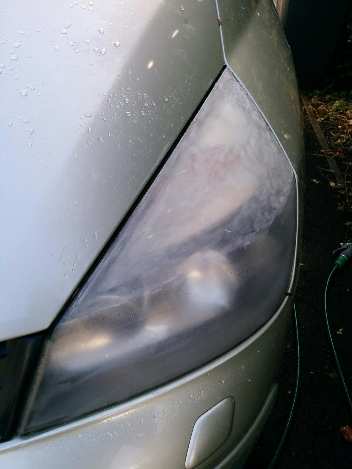

I had a go at sorting out the misty headlamps tonight. Started off sanding with 1200 paper, wet, then a polishing sponge, then a mop thing. My father-in-law has a polisher which he uses on his boat, which I have borrowed (the polisher, not the boat)...
To counteract the nice polisher, I'm using an old tube of Autosol which has a hole in the bottom, and I need to use it before it dries out.
Before:
After hand sanding with 1200 grit: (amazing the amount of cloudy water this produces)
After a go with the polisher:
As you can see, it was getting dark, so I'll take a look at it in the morning and do the other side. It's a lot better, certainly good enough for an MOT pass, but not 100%. I think I need to spend longer doing the initial sanding.

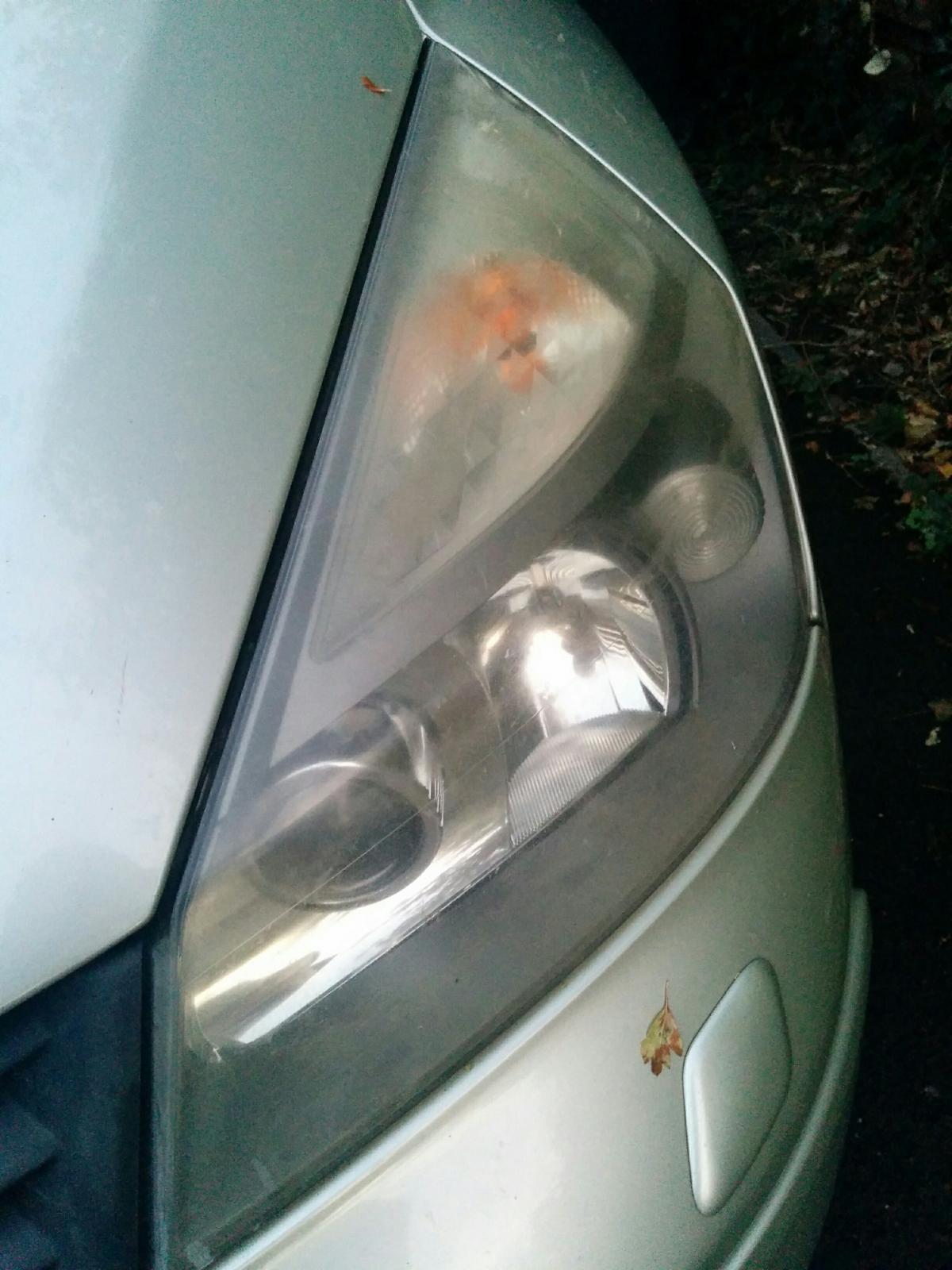

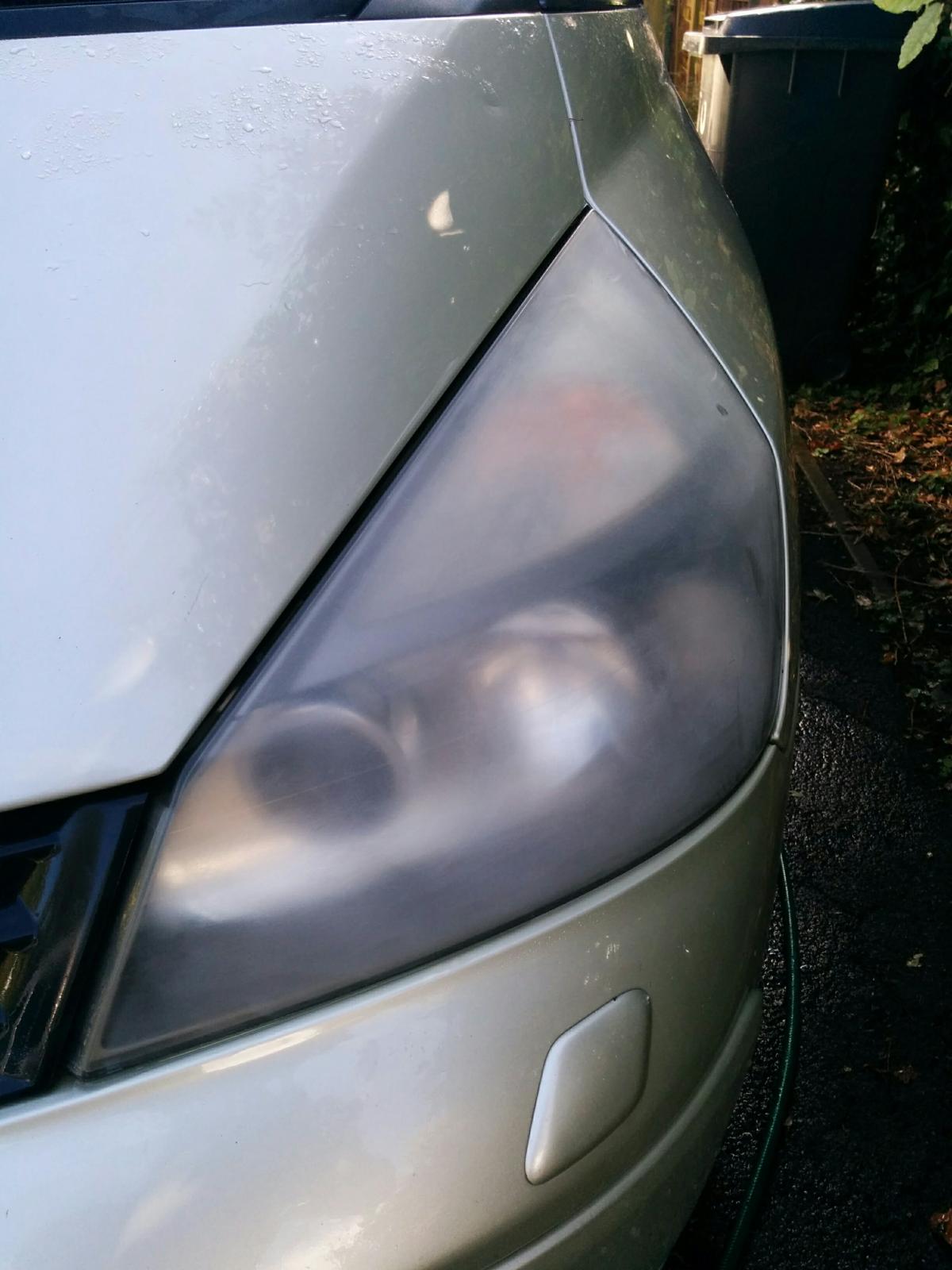

Well, this is turning into an incre-he-hedibly dull thread at the moment, but posting updates here gives me a bit of mojo, so please excuse another headlamp polishing update.
Annoyingly when I went back this morning to look at the one I'd done, it didn't look that great. I could still see patches of oxidisation on the outside, and the top half of the lens - where I hadn't really sanded at all - had a nasty yellowish cast to it compared to the bottom half.
I decided I needed to be more aggressive. I sanded the whole thing back with 180 paper on a block.
Then 1200 with my bare hands.
Then a go with the machine polisher - Autosol (which I figured is basically cutting paste) on a sponge, then (er) Tesco furniture polish with the bonnet thing. Mmm, lavender.

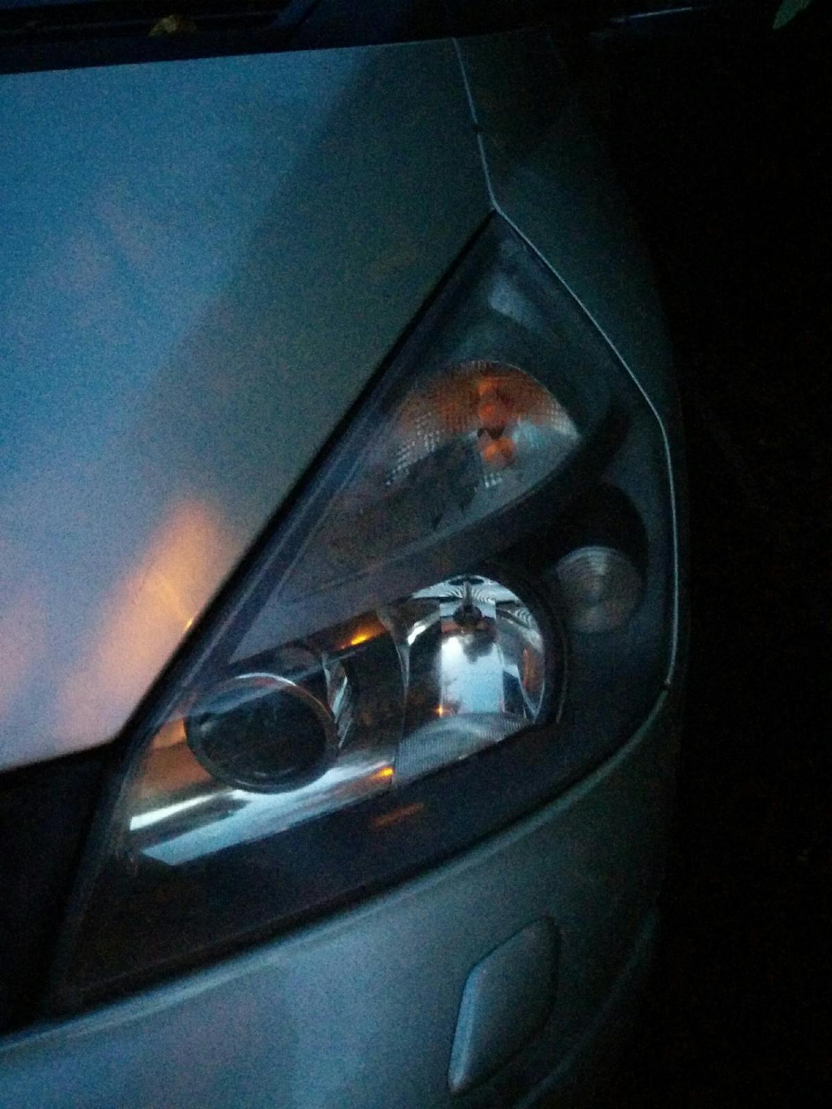

Having finished it there are still some bits that haven't come up that well.
Overall though, the difference with the one that I haven't done yet is obvious. Now I just need a break in the rain so I can do the other one.

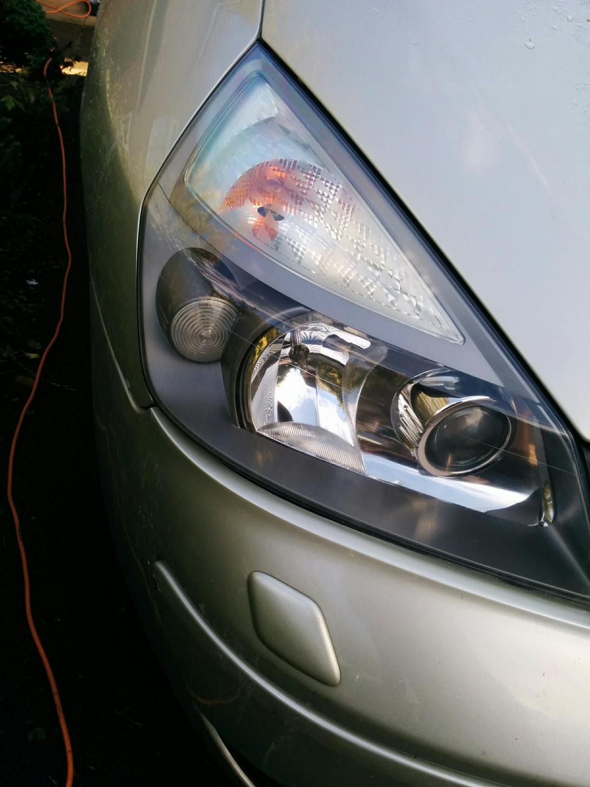

I done the other one. I was a bit more aggressive. I think it's come up better.
Just need to find some UV protection!
Those headlights look good.  I only went to 800grit on mine, they're OK but still marred in areas.  Good enough, though.
