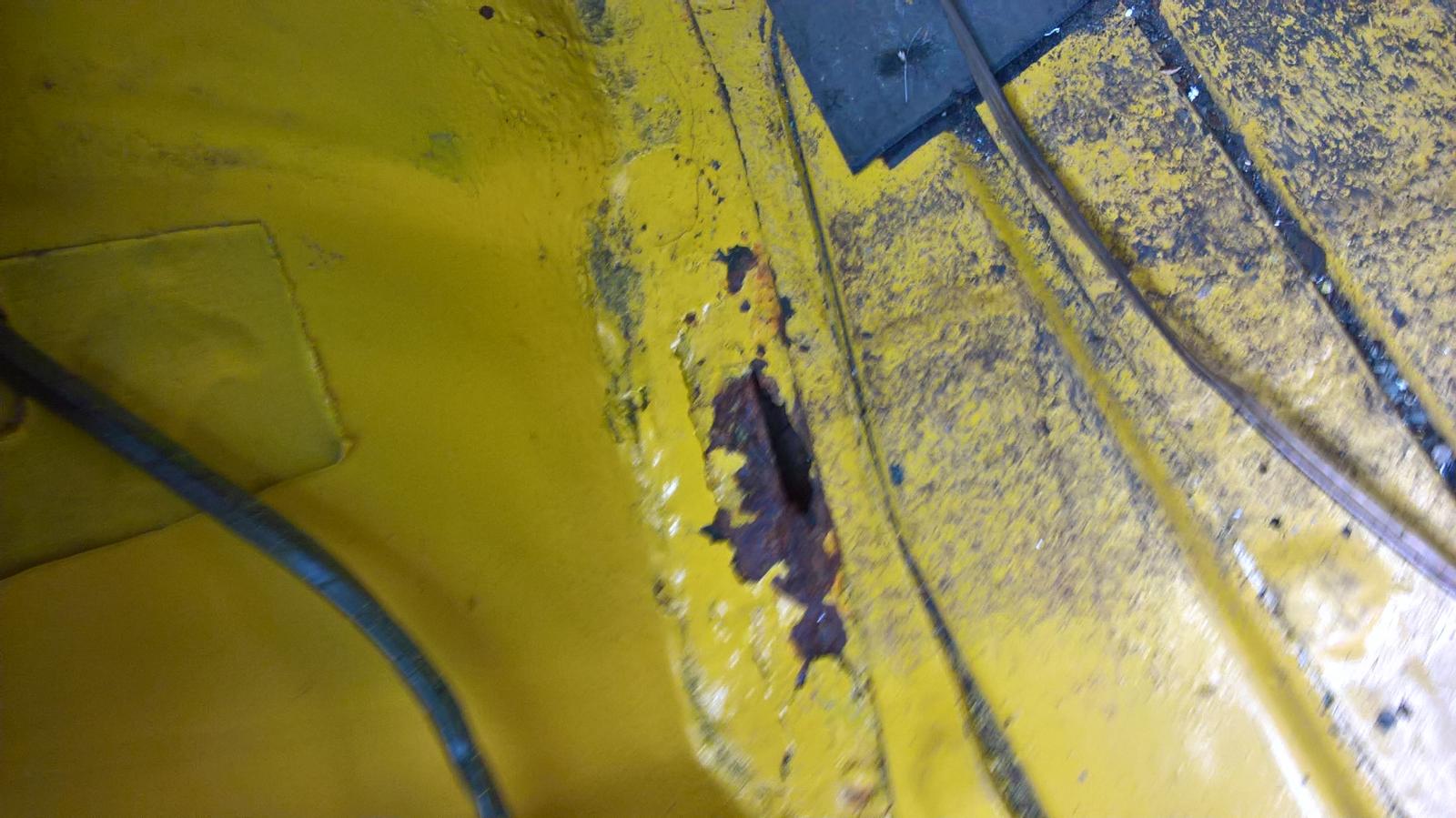

And I found this by the front foot well.
Eek! First proper bit of grot I've seen on here. My magnet stuck to it so at least it's metal.

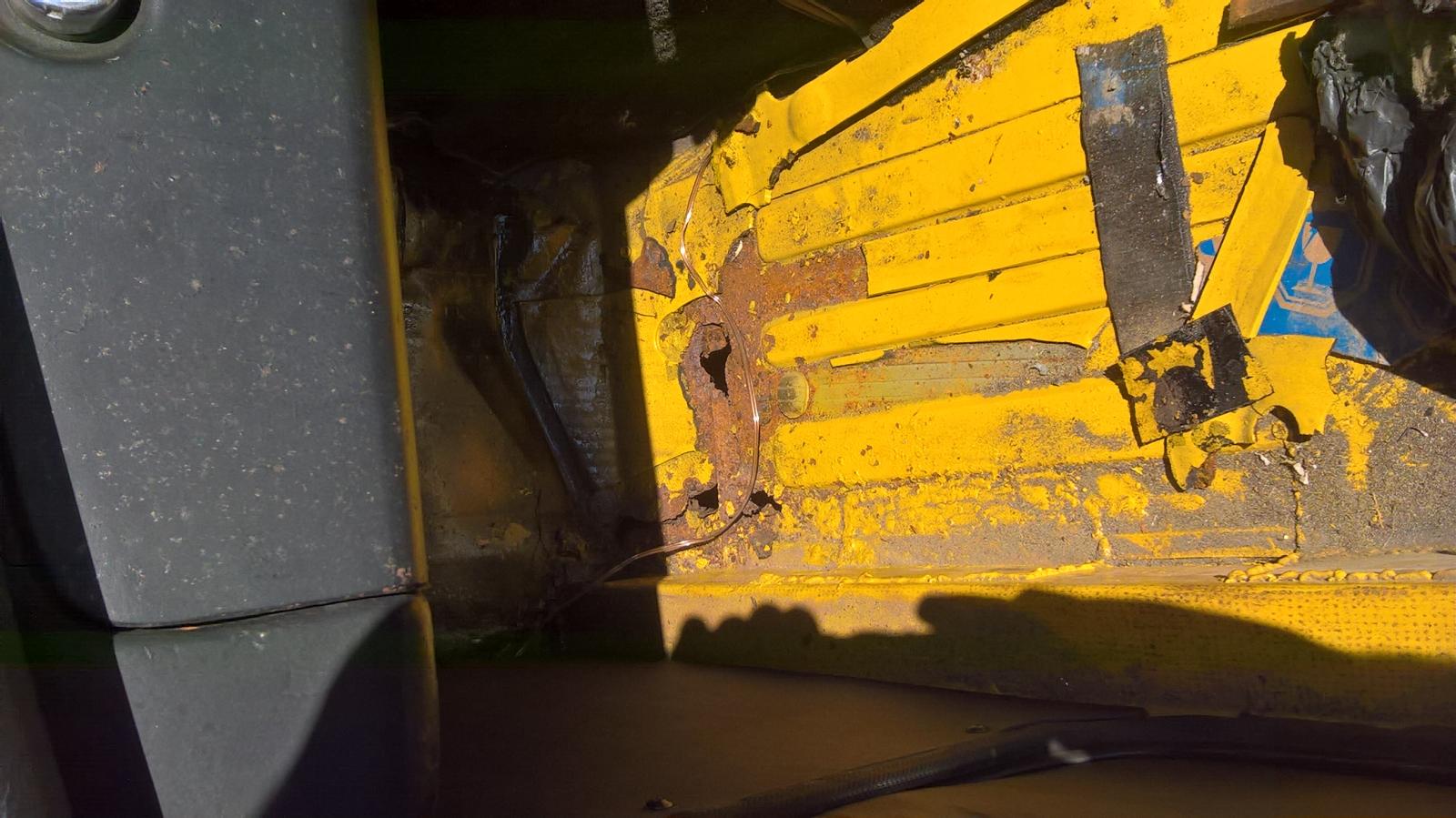

Got worried at this stage, so pulled more trim up to have a better look.
So looks like someone has been here before and done a welding job. I guess it's not too bad? Hitting it with the back end of a screwdriver seems to show it's fully solid.
Far, far better than mine looked but needs a bit of anti rust treatment sooner than later.
Picture 3 & 4 are interesting with that blue bit behind the hole. Looks like been welded externally but that's quite odd. Rest is roughly what I would have expected.
Back to pics 3 & 4, there's a rusty bit on the floor where the sound deadening material is missing. Don't want to worry you but I hope to fuck it's not like this below it.
I think it's fine*. This is the view from underneath that area.
I gave it a good poke with a screwdriver and it didn't go through. (Thankfully!)
