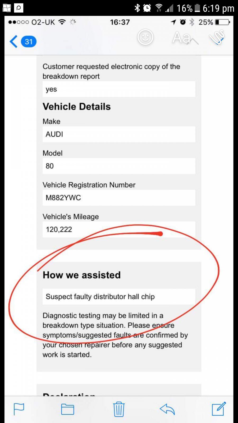

Any ideas on this diagnosis from tehAA?

Hall sensor is the modern equivalent of the rotor arm (or points) - it senses metal passing the sensor surface and generates a pulse for the coil pack(s). Same tech as an ABS wheel sensor I guess. Anyone confirm this?

Other way round - the gap in the disc is the 'trigger'  - ECU fires coil when waveform (voltage) is at 0.
Usually the centre wire is the switched one - relatively easy to check.
New distributor needed me thinks,had them fail on mk2 golf gti's ,nearly the same , ken.

However, if the AA reckon it's the hall sender, then I fixed that exact problem on my G40 with just a selection of crap screwdrivers and a hammer. A new dizzy would be the easiest bet, I bought just the part I needed for £cheaper but it took me twenty times as long to fix.
