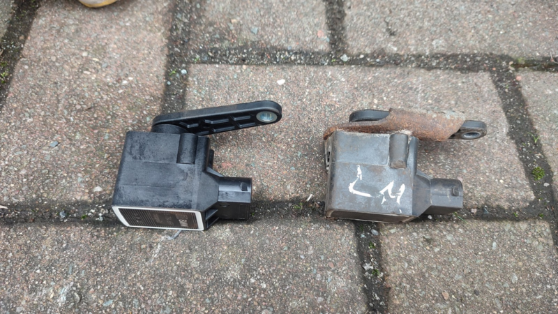

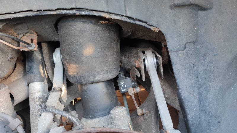

Lets have a look at the rear suspension first. Diagnosing it when I bought the car showed a rear right sensor error popping up immediately after clearing it.
Ah. The sensor wasn't unplugged but the writing on it clearly indicates that the new sensor is anything but new.
The fact that the casing around the mounting points is splitting probably doesn't help either.
The design of these is no different to most other height sensors, the control module sends 5V and moving the arm results in higher or lower resistance, the resulting output voltage indicates where the arm and therefore suspension is sitting. I tried to measure both resistance and voltage but couldn't really get any sensible readings out of it. Since I already ordered the sensor I just threw it in to see what happens.

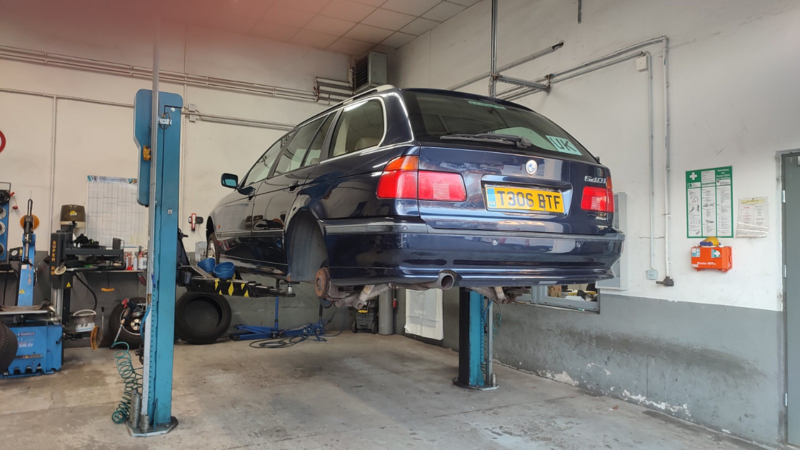

Today was also the first longer trip in the 523i since I got it, Berlin and back to pick up some '64 Thunderbird parts for a mate in Norfolk, 450km total. I now know that the cargo area is exactly the size of one Tbird trunklid! Seller was a decent bloke, originally from Spain but living in Germany for most of his life, obsessed with Fords. He had a late '82 Sierra he converted to a Cosworth (visually), among the Tbird thats getting a nuts and bolts resto and an E23 7-Series.
With the worst of two sets of wheels on the 523i the ride was actually much better than on the 540i on my way here, all we did on that warped wheel was removing the weights. Still hardly amazing but certainly tolerable.

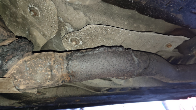

In the end it was a taillight bulb (now replaced), a bodged exhaust patch and some minor corrosion on two brake pipe fittings, just to fill up the MOT sheet of a car that has been off the road for 11 years. Now the bodge of the previous owner will need to get sorted as it got much worse on my way back. There's also now a leak of ATF coming from a pipe  we somehow missed, typically the bracket that holds it has trapped dirt inside and thats now caused a leak that hasn't been there before. However if thats all that needs immediate attention at this point I'm happy!
Naturally that doesn't mean that these are the only problems left, there's still a long list of minor electrical and cosmetic issues I will have to work through after sorting the above. For now I can legally drive the car and start tidying things up step by step however, considering the car looked like this before I got it things are definitely moving in the right direction though.

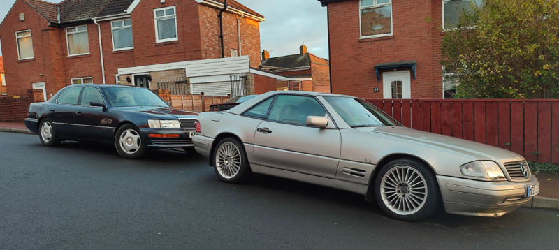

Bonus photo with the SL, another project waiting to return to the road after 10+ years. Ballin' like its 1995...
I'll see if I can get the pipe sorted as soon as I got time and then have it booked in for the exhaust work.

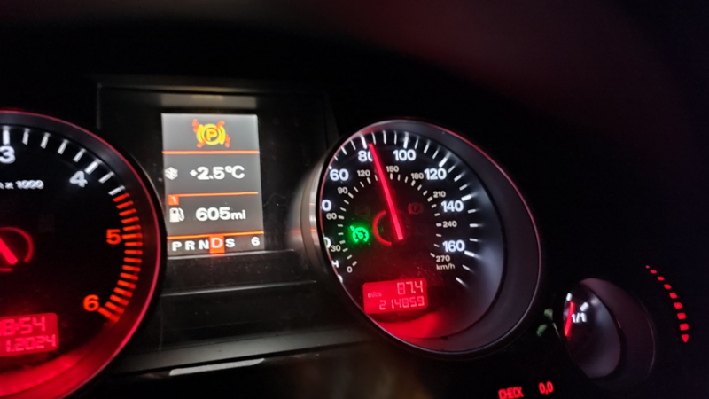

If the parking brake warning light is for the NS motor, it is probably fucked again.  I fitted a very cheap pattern part, badly.

May be more an adjustment issue. Both sides motor on and off, it only threw the warning for me if I hadn’t used it for a while.
Bugger, it'll need the front bumper off to fix that

Yeah, I'll have to see what it'll do after using it a few times. Shouldn't be too hard to sort if I ever can be bothered as the parking brake seems to work just fine.

Nice one, they're really great cars.  Mine is off for a much delayed visit with the MOT man tomorrow...
Looks to be a very similar colour, mines called Aqua Blue Pearl.  The parking brake light was on as part of my ABS module woes, but as you've nothing else lit up I'm sure it's actually just the parking brake itself 🤞.
Have you got VCDS?  Makes working on them so much easier, even required for back pad change, you have to tell the car how thick the pads are for it to re-calibrate?!  About £250 I think for the genuine RossTech cable.

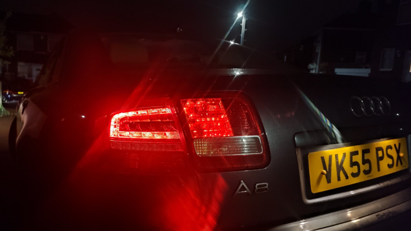

I see you also have a mix of post and pre facelift tail-lights, they're getting hard to come by, but there is a fella on the FB page supplying them reconditioned (if you're bothered).

I'm hoping it's just lack of use that's preventing it from functioning properly. I still got a free version of VCDS and a decent cable from doing work on the D2 S8, maybe this will finally be enough of a reason to invest into a better setup (descriptions of only the first code in the list displayed right now for example). And yes, it already has the much appreciated outer 2nd facelift taillights, not cheap at all either so a big bonus as that was on the to do list anyway. I definitely will need to get a pair of inners to complete the look (which really helps making it look a lot fresher), hopefully I'll find a breaker that has a reasonably priced pair. Since I'm thinking about replacing the whole bootlid with that of a later Sport/S8 (has a subtle integrated spoiler lip that improves the looks massively imo) I might get lucky and get it all for reasonable money in one go, chances are low I can find one in the right color though.
It had a single facelift outer light for a while 😂 the originals were completely knackered through water ingress. Was always on the lookout for inners to match but as you say, they’re not cheap.  I got lucky with the outers, they were reduced for some unknown reason at ECP

Yeah, I did read that in your thread. ECP would have been the last place for me to look for replacement taillights but they do indeed still sell them. Looks like they have them under the ULO brand, never heard of them before but looks like they are the aftermarket branch of the OEM which is useful to know for the future. I'll most likely end up getting a set from a breaker though if I can find a pair for cheap.

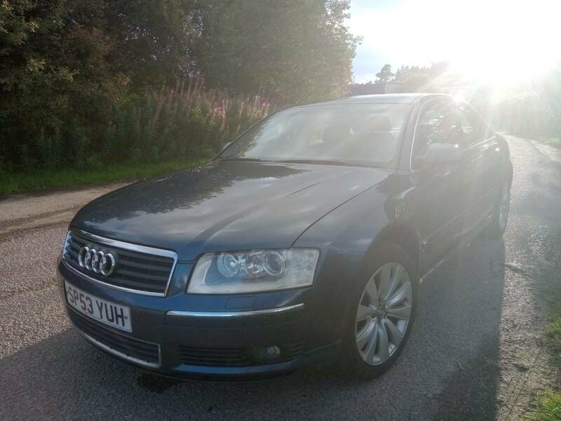

The A8 is now in daily duty and naturally proves to be an excellent grocery getter (just dont think about the DPF eventually clogging up from short distances). I need to figure out whether the power trunk lift needing some help can be an easy fix, its a great feature to have and just makes the car feel fancy and modern. Right now its not able to build up enough pressure to lift the lid the first 20cm or so, automatically closes just fine though! The towbar probably wont stick around for long either, I won't have space for a trailer anytime soon.
I refilled the washerfluid and noticed that the hood struts aren't doing their best anymore either so I'll probably order a new set before not too long. Here's the current taillight situation discussed above. I've contacted a few people breaking A8s and naturally all of the last facelift taillights were already gone or damaged. Fortunately something that doesnt need rectifying immediately, its purely cosmetic. Unlike when doing this kind of retrofit on a car like the BMW E39 (Celis angeleyes or taillights from the facelift) this year A8 already used LED tech properly for the rear lights, so should be a simple plug&play once I find a set.

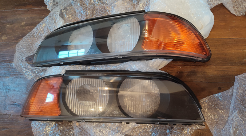

Speaking of E39s, I ordered everything needed to rebuild a set of pre-facelift amber headlights the 540i Touring was originally coming with when new, pretty much the opposite of what people would normally do. I found a set of almost brand new Hella headlight lenses on FB marketplace for an absolute steal, had I known that a lot of the trim comes with the new lenses I could have saved myself spending quite a bit of money on a rebuild kit. Fortunately stuff like this is easy to sell for the same money again.
Since I wanna stick with having Xenon like I have on the Touring right now (despite the car not coming with it originally it still has headlamp washers and the rear ride height control, should be safe to use) I probably will need to replace the dipped beam lenses with whatever used Xenon headlight set I end up working with. All of this stuff is still easily rebuildable/replaceable, naturally things got a lot harder with the facelifted E39 later. If all goes to plan I'll end up with a like-new set of headlights for a fraction of the price you'd pay for a pair of Hella headlights now.

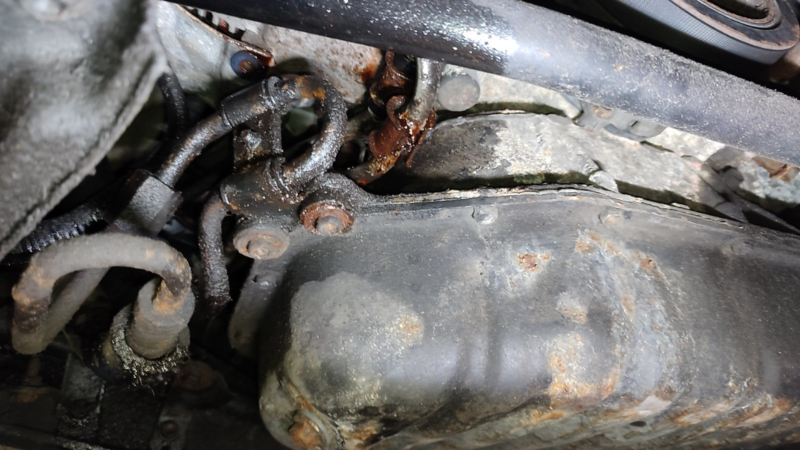

The weather was good enough this weekend to actually get something done and make some progress on the Celsior. As previously mentioned the transmission cooler line was the most important thing to tackle now that its back on the road. As you can tell, it's been leaking right where the bracket was holding it in place:
Fortunately this is indeed a pretty low pressure line so some quick sawzall action later we cut the offending section of hardline out:
Lucky for me it was close enough to the oil cooler that I just needed to replace the existing hose with a longer section. Toyota added the S-shape to clear the swaybar, I cannot see a reason why a long enough hose wouldn't do exactly the same without ever rubbing through.

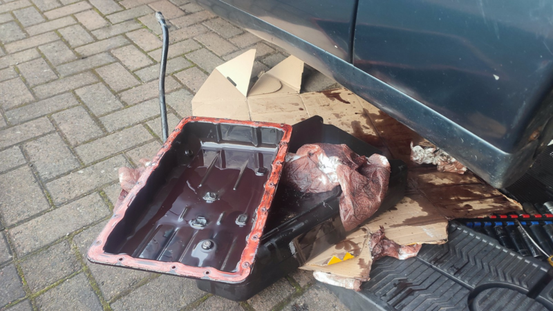

As mentioned before, it made sense to do a quick gearbox service while the atf was low. Toyota actually isn't using a gasket to seal the transmission pan but a sealant (ThreeBond 1281 to be exact) instead. I could see that it was weeping in some areas around the pan so now would be the best time to tackle it.
Naturally things had to come as expected and the inevitable total mess unfolded in due time, despite the pan actually having a drain plug. Normally removing a transmission pan isn't a particularly hard thing to do. Doing this on the drive with hardly any room to maneuver underneath the car is just one of those moments that make a garage with a lift that one thing I will not compromise on in the future. Toyota attaching half of the dipstick tube directly to the oilpan didn't help either, just another proof that all manufacturers have idiotic engineering moments. Fishing it back in while not disturbing the fresh sealant was NOT fun.

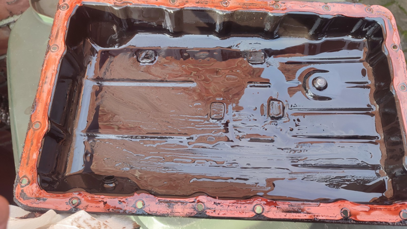

For those who wonder what the inside of an LS400 tranmission looks like. The filter is just held on by 3 10mm bolts, the seals were rock hard so probably still the original one.
The inside of the pan. The ATF that came out of it didn't look bad at all. Some sludge as to be expected at this age, the magnets didn't really catch any metal debris either.

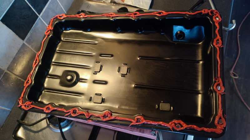

Pan properly cleaned, removing the old gasket naturally took a little while. Now with new sealant applied:
Pan back on. I've let the sealant cure over night as I wasn't sure how quickly you could fill the transmission after applying it. Apparently its supposed to be perfectly fine after 10 minutes but I cannot quite believe that.
It better not leak again in the next 20 years or so... I've tried filling it using my patented paper funnel technique this morning, naturally this immediately failed and made even more of a mess. I then found a better funnel which also left a mess as for some reason it takes absolute ages to fill the gearbox via the dipstick tube.

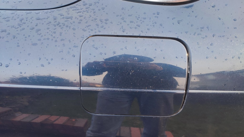

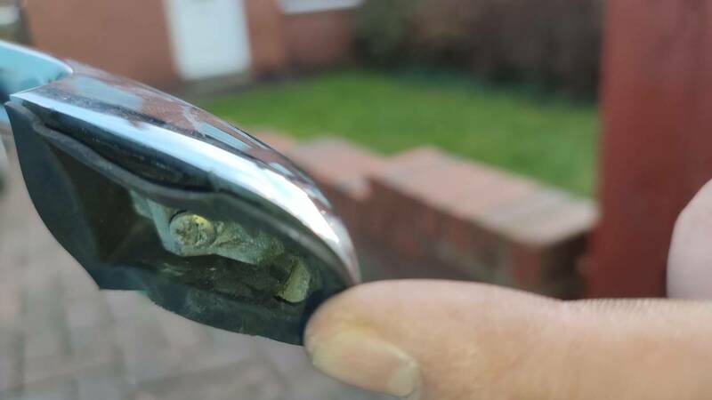

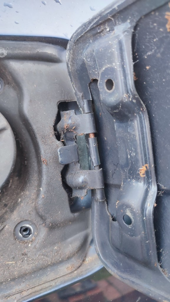

Because this is Toyota's billion dollar flagship the inside of the fuel door was hidden behind a plastic cover. I could tell that the cover didn't quite perfectly fit the door hinge though. Lets take a closer look with the cover removed:
It looks like the sheet metal holding the pin was bent back slightly. I would have expect the mounting bolts on the vehicle side to have come lose but I'm pretty sure this was the issue. Nothing a bit of force can't fix though. Much better:
Everything reassembled (sans 3 unobtanium clips). Love the service stickers, everything that reminds me of its previous life in Japan is worth preserving.

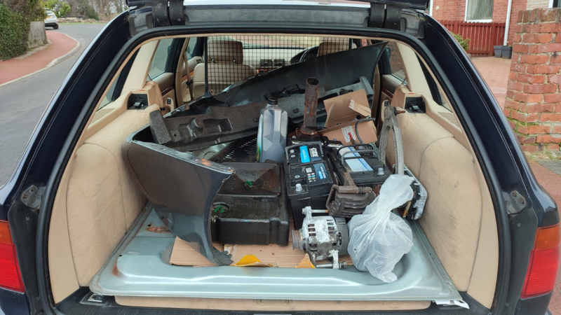

Quick update on the 540i Touring. Took half a year's worth of scrap to EMR in it which netted me 37 quid. The Alfa 166 Twinspark cat was completely unidentifiable so it went straight on the scrap heap, it was breaking apart internally anyway. Nobody wanted the front bumper either. If anything breaking the Twinspark 166 proved that absolutely nobody in the UK is willing to fix one of these up. It'll be one of most other Italian cars that will be completely wiped from the face of the earth in a few years time (in this country anyway).
It had to be done. Scrapyard action shot!
