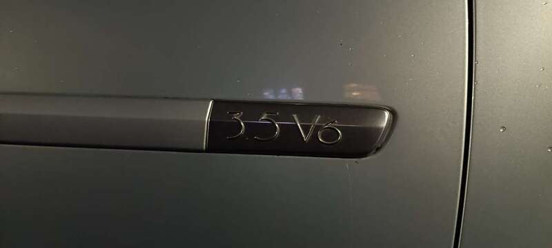

The XJR wasn't the only recent purchase that has happened over the last few weeks. As this thread shows I've always been interested in the more unusual stuff, and I'm probably not the only person looking at increasingly unusual cars after having owned so many others. I've been curious about Renault's avantgarde flagship of the early 2000s for a little while, especially after having owned its direct predecessor (the V6 Safrane) and the V6 XM before. Both of these cars are a generation older though when it was really the late 90s and early 2000s when French manufacturers, especially Renault, were starting to launch more stylish, unmistakably French cars again, particular when it came to their most prestigous models.
So when @blackbart advertised his Renault VelSatis that wasn't just the top of the range Initiale but also equipped with Nissan's venerable VQ V6 (here in the UK so well know as being the 350Z's powerplant, but also featuring in the very popular Infiniti G35, Altima, Maxima and many other Nissans and Infinitis in the US market) I just couldn't resist despite not being able to pick it up anytime soon. Once again the spirit of Autoshite showed and @grogee and @Cluffy were happy to deal with the collection, which turned out to be a bit of a undertaking considering the amount of parts that came with the car:
Two weeks later and the car is now home. My initial thoughts: I'm glad to have pulled the trigger on this one. It was kinda hard for me to imagine how it might drive without having been exposed to many french cars of this era. I'm glad to report that it does have the attributes that make an executive car a real executive car: A general feeling of solidity and mostly good quality, very low noise levels even at high speeds, a reasonably comfortable ride and a certain feeling of calmness that you really want to have in a car made for wafting. Naturally its an old Renault so it has its problems, the clearcoat peel is a little more advanced than I had hoped (and there is no cheap solution for fixing that) and the gearbox at the very least needs a service. I'm hoping that the VelSatis community in the UK is still decent enough to get the few bugs the car has sorted though. Really looking forward to driving it more.
