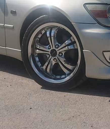

Kinda wish I brought one of these wheels with me. Just to try on the Q45.
Bother is. They are VERY JDM and are a weak spec of wheel too.
Ha, I had the choice of a similar style wheel when I bought the car (that's what it was riding on here in the UK before I bought it), I declined naturally. I wouldn't be opposed to something a little closer to this though...
I'd want to stick to a factory wheel option though. The Q45 and President came with some decent alloys, including BBS ones. I'd be happy with either.
77de4625-fd6b-4992-962b-b869b4b49055.png.fba37d4b3558e2ea591dd430f158e9be.pngINFINITIQ45-3252_1.jpg.a20eee9c8618e5fe37163e6ad8904e42.jpg

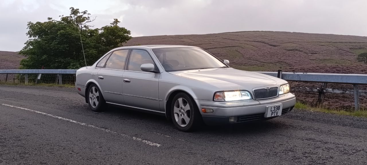

To be honest.
I agree. It needs to be back to stock height and with a OEM wheel choice.
I have to be going soft. As I'd been fully on board with the first picture of a lowered one on the chromies 😆.
Always enjoy seeing what you bring to FotU, looking forward to checking out the Infiniti. Good luck with the MoT!

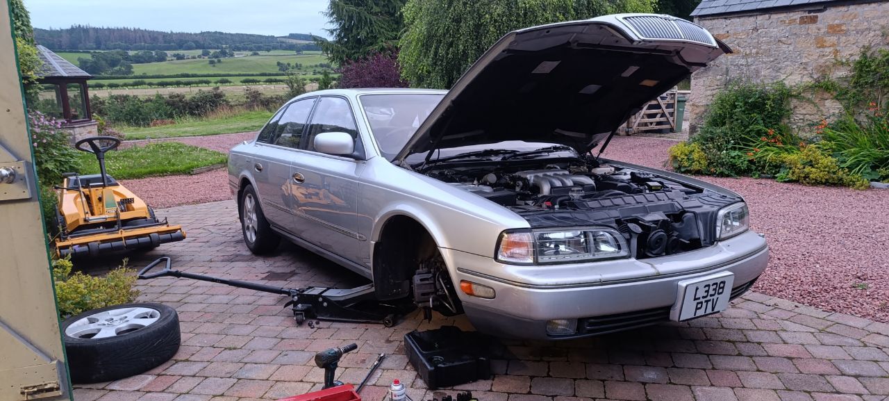

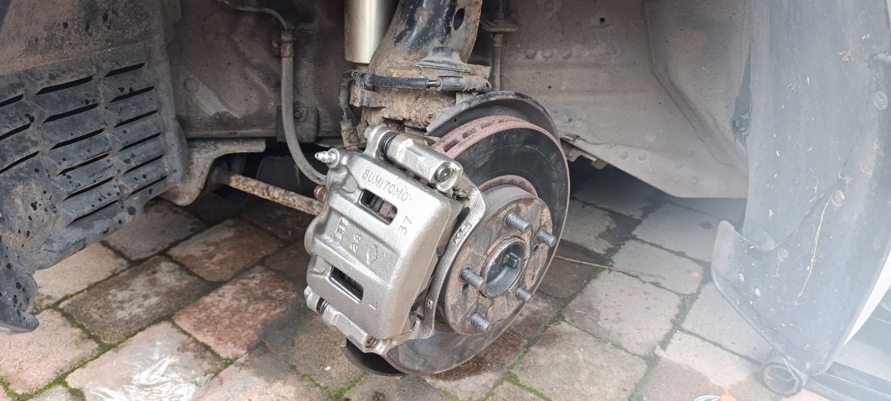

Rockauto once again delivered in record time, with me ordering parts on a Thursday evening and receiving the front caliper and rebuild kit needed to get the Infiniti going on Monday noon. Unfortunately only one of the two parcels arrived as FedEx for God knows what reason held one of them at their import facility for 2 days, so no new pistons for the driver side caliper that was NLA...

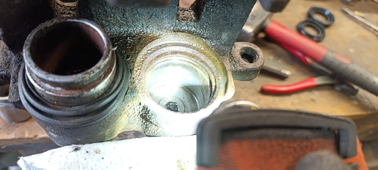

Luckily I was able to scavenge one decent piston from the caliper I did have a replacement for. I don't have compressed air yet so pushing them out using the brakes was my only option here...
No wonder the front brakes were seized nearly solid. I'm not sure how old the brake fluid was (still looked good in the reservoir) but that's the end result. The seals all looked good still. I've had to use the right and middle piston, both cleaned up well enough to be reusable for now.
The bore surfaces still looked spot on so no issues there. I've blasted it all with brake cleaner and wiped any remaining dirt out.
Here's where things got tricky. The damn dust covers wouldn't fully snap into the ridge around the bore no matter how hard I tried. Chances are I would have torn them to pieces long before they seat properly. It's a dust cover so it'll be alright for a while but should I ever find a rebuilt right front caliper those will be my reason to replace it. With replacements around 50 quid it's just not worth the hassle.
The other side naturally was easy, a fully refurb'd caliper for under £50, what more could you want.
I'll do the rear calipers another time (they seem to drag a little as well). They too are cheap so by the time I'm done it'll have new calipers and brake fluid all around. This will be the only maintenance item I needed to have done to the car so far, everything else is related to the dumb mods I'm planning to revert. Those crappy headlights LEDs that have already partially failed will be next.
For now the Q45 is ready for Fotu though. It'll be the first long trip since I picked it up in Birmingham a few years ago.

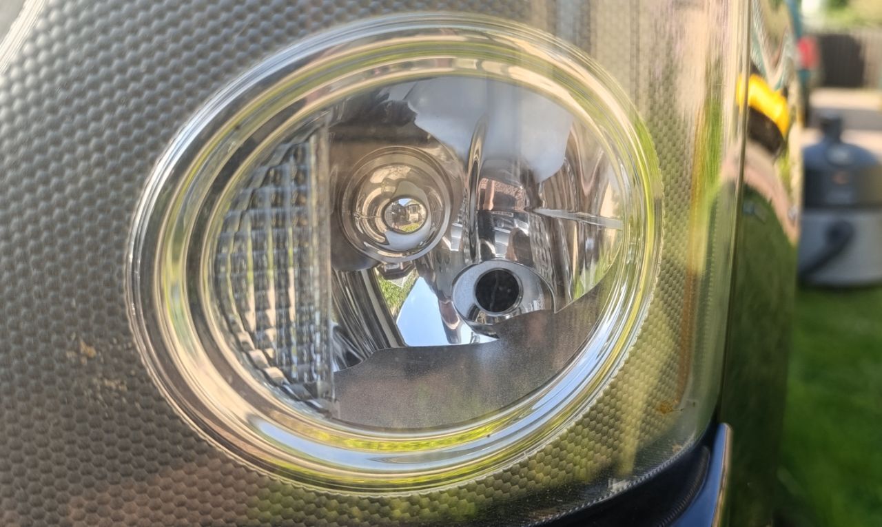

Case in point, I sorted the aftermarket headlight wiring on the Infiniti the other day. The LED units are still in there (the headlight lenses are goop'd up so there's little chance of removing them) but all bulbs are back in place and excess wiring removed:
Only the sidelight bulb holders were a bit of a problem, they are unique to the Q45 it seems (why Nissan...) and whoever installed the LEDs cut the wires right at the holder😬.
I've cut the plastic around the wires down so I got a bit of cable to solder to, which was successful enough to end up with this:
Bulbs installed, original factory lighting restored:
I've also replaced all the clips holding the covers in place, naturally most of them were missing and things just flapping around. All good now although these Chinese made clips will strip out in no time compared to the original ones I'm sure.

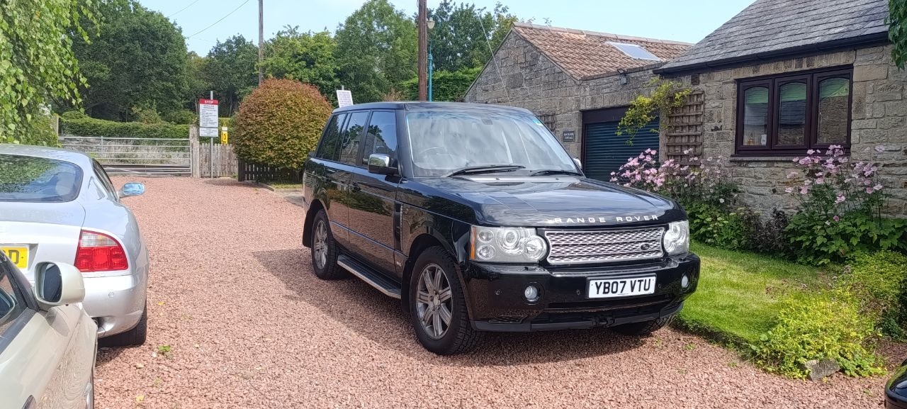

With one Rover still waiting to get its springs getting sorted yesterday was the time for another Rover to join the fleet. As everybody should have seen by now, I've decided to buy a 2007 Range Rover TDV8 from a dodgy driveway seller in Stockport, knowing that the gearbox would likely be screwed. Not necessarily a problem though as the price was right and the condition of the vehicle otherwise looked promising:
Well, the RR made it home in the end, however not without testing my survival skills when buying questionable motors. Arriving at DirtyDaily's place the car actually made a really good first impression:
While it was clearly well prepped for a sale, looking a bit closer confirmed that someone must have taken good care of it for at least a little while. There's no major damage or corrosion on any of the panels (rear sills still crispy though, but at least hidden), the interior is tidy and without any major wear, appropriate for the 108k miles its displaying. Things like the Venture Cam, tow ball and a 2nd original key are all present. Even the tyres look like they hardly have any miles on them. No visible leaks, sagging air suspension, flat battery etc after sitting for a week. We took it for a drive and all seemed well.
Knowing that this is still a Land Rover product I only filled it with 40l of diesel, just enough to get me home. I wouldn't want to risk breaking down with a full tank of diesel worth a considerable chunk of change. Well, while it did behave in city driving (probably the only journeys its done in the last few years...) joining the motorway didn't go so well...
Not only did it immediately trigger limp home mode locking me in 3rd gear (which is now pretty much confirmed to be caused by a worn rear stator bush, apparently not all too rare of a failure in Land Rovers for some reason), driving it at 3500rpm and then overtaking a Golf going 50 for god knows what reason was enough to immediately trigger a low coolant light. Which meant I had to pull over.
I could tell that it suddenly lost coolant and that it must have been somewhere in front of the engine. I only had a liter of water with me, I don't think it would have made much of a difference but I filled it in anyway. Fortunately the next petrol station was only 1.5 miles away so I limped the RR off the motorway in the hopes of finding some water there...
This is what Range Rover ownership really looks like. Still looking great there though! I had a closer look at where the coolant could be escaping from and luckily spotted the upper radiator hose having slid off the engine side flange for whatever reason. You can see it here out already but its normally sitting right underneath the driver side boost pipe:
Fair enough, its barely accessible (probably why the previous person working on it didn't manage to install it properly) but at least its something that could be fixed relatively easily! It wouldn't make much of a difference without tools though. I only brought a few screwdrivers... That's when I met the friendliest petrol station manager I must have ever encountered. She happened to have a tool kit (consisting of the most random assortment of hand tools I've ever seen, including 5 12mm spanners but no 10mm, a small incomplete socket set, a set of pliers, some vice grips (the life safer) and a few bits of what almost looked like scrap metal) that was just about enough to very slowly and painfully disassemble everything sitting above that coolant pipe, just enough for me to pull it out of there...
Its mangled but just about good enough to get me home... I stole a jubilee clip from the boost pipe and swapped it with the clamp that was holding on the coolant pipe before. I'd at least have a chance of tighting the jubiless clip with the tools I had there when I didnt have the tools to compress the clamp enough to reassamble it all securily. An hour of agony later and we were back on the road and the Range Rover now being cooled by Highland Spring still water (they didn't have a public toilet and the screen wash dispenser was more expensive than just buying bottles of drinking water...).
The trip back to Newcastle was rather uneventful after that. It naturally was stuck in 3rd most of the way and I now know that the driver rear caliper must be sticking. The tyres also make the noise of a failing wheel bearing on some road surfaces, fun when you are driving a new-to-you car. But with speeds capped at around 50mph and the rpms never going over 3200 the hose stayed on all the way (another failure would have meant a guaranteed ride in the tow truck, taking several more hours). I even managed some rather respectable fuel economy numbers despite only having half the gears I should have (an indicated 28.5mpg in the end)!
For whatever reason the GPS doesn't seem to be able to position the car correctly although it does realize that the vehicle is moving. Here it thinks I'm somewhere in the North Sea. Calibrating the position manual didn't help all that much, its very odd that you'd have to do this in the first place.
Arriving back in Newcastle the car was immediately pressed into use to haul some junk out of my old place:
Having seen some rather large cars in this driveway the L322 still looks massive:
Check out the purple exterior illumination though. I actually like that:
Anyway, that's where we are at now. I'll probably book transport to Birch 4x4 Motors for Thursday so they can put it on a ramp sometime next week. They are located in Liverpool so I probably could have saved myself a few quid by driving it directly to them but you are always wiser afterwards. A rebuilt gearbox won't be cheap but with the rest of the car in pretty decent shape it should be worth the effort. You won't be able to find an L322 TDV8 in this condition with a brand new gearbox/torque converter for the money it'll ultimately cost me, I'm crossing my fingers that it will be the last large bill for at least a little while though, the plan is to take it to Germany in October and a lap on the Nurburgring seems more and more likely...

  • Schaefft changed the title to Schaefft's Bargain Barge Extravaganza - L322 Range Rover arrives, then leaves, Q45 is receiving TLC
The Range Rover got collected this morning, wish me luck that things go smoothly with the gearbox replacement next week.😬
Until then, I have the other cars to keep me busy. Since its the Summer of the Q45 (after Fotu now also going to Radwood and Rustival over the next 2 weekends) and the ZT-T still blocking my wrenching corner I gave the Infiniti a nice little polish this afternoon. Despite having only 32k miles it has picked up quite a few scuffs over the years, plus the key marks that I'd at least like to reduce somewhat in places. Here are the before and afters:

Lever down the light lenses at the flat blade slots at the rear of the light cluster.
Once the lens is out there  are two hex screws to take out, then lever down the back and push towards the screen then remove it from the back facing the sunroof. I haven't removed the light cluster myself but I've seen a post about it on a forum somewhere.
Hope the bumper sensor sorts the pop up hood.
