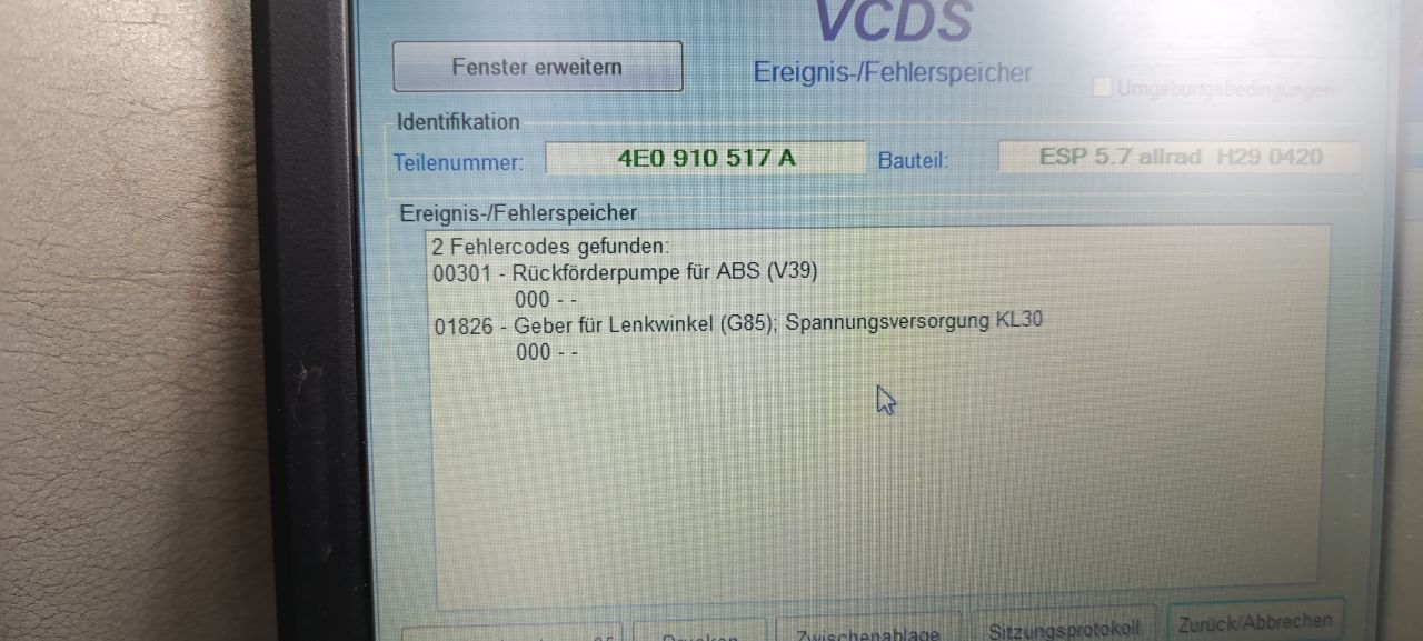

The replacement module arrived today and fortunately fixed the electrical issues for good, the MMI screen once again rises!
Unfortunately taking it through a test drive through the field quickly revealed the original reason the car must have been taken off the road for.
We can ignore the code for the steering angle sensor (always triggers after disconnecting the battery). 00301 however us a code for an issue with the ABS pump (ABS return flow pump to be specific, which is the ABS pump). While its easily accessible it also happens to be quite expensive. The part number for my pump/module assembly is 0265950061, which is for the early V8 A8 D3s as far as I can tell (so 3.7, 4.2 and 4.0TDI). There's only a single one for sale on ebay right now which is 350 quid. It could be worse but considering the car will need a few other smaller niggles sorted I'm not sure if thats going to pay off in the end. I can't see another non-V6 diesel A8 getting broken for parts either that could donate its pump. It also seems like I managed to mess up the module coding somehow so its now permanently showing a control module defective code (forunately the pump and module come as pair).
The original reason for the purchase of the A8 was as a parts car, if I can't find a replacement pump for cheap that might be its fate after all...

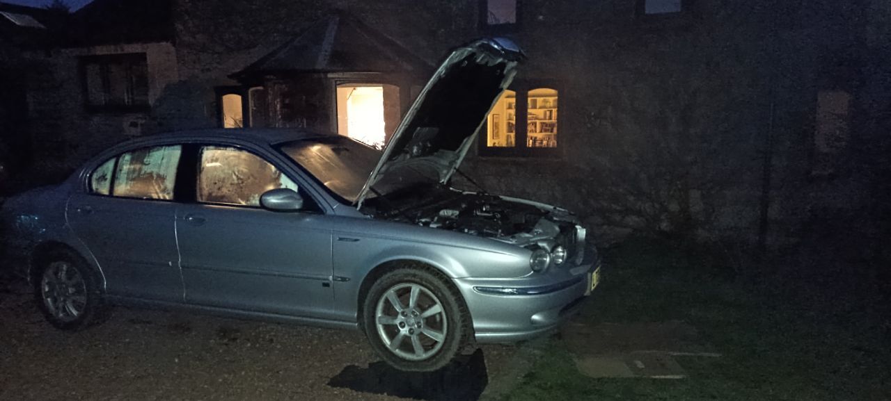

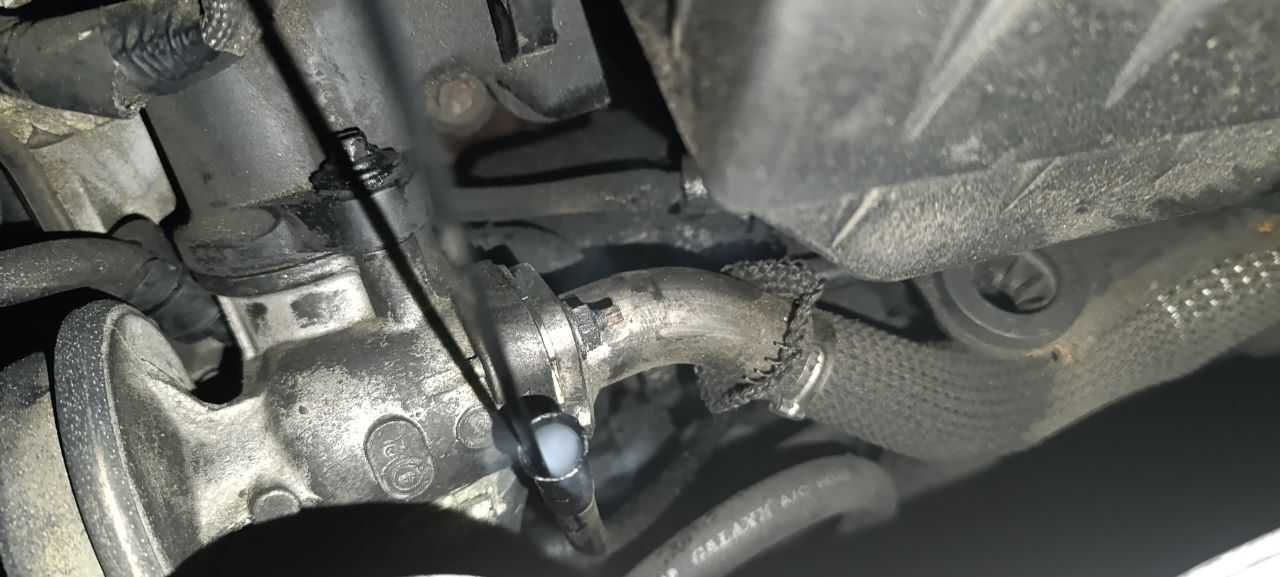

I've decided to move on to the next troublesome diesel today in form of the forum bike X-Type. It's quickly turning into quite the problem child.
Originally I thought it only popped a boost hose after booting it as it's sluggish to say the least (and I'm fairly sure I heard something along a sudden air leak when it lost power). It's pouring out a ton of white (unburnt diesel) smoke. I've had a look today and can't find any of the boost hoses to/from the intercooler loose or ruptured. I felt around all of them and all seems good. Is there anywhere else I should check for leaks that would result in no boost and a reluctance to rev? No codes stored in the ECU.IMG_20260115_172335.jpg.899311c787561a533b15664197c37ca4.jpg
Smoke out of the dispstick tube can't be good either! It sure does a great job at being a smoke machine.
  • Schaefft changed the title to Schaefft's Bargain Barge Extravaganza - X-Type Diesel Smoke Machine
22 minutes ago, Split_Pin said:
Do these have a pcv system?
I would assume so yeah. The PCV valve might be gummed up but I don't think that'll cause the lack of power. I'd assume the dipstick would become a projectile before that's causing the engine to lack that much power😅
Id be checking the turbo has not self destructed if its smoking like a trooper.
