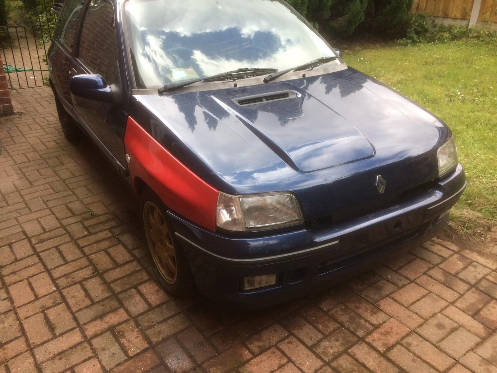

As promised here is Nicole as she stands now:

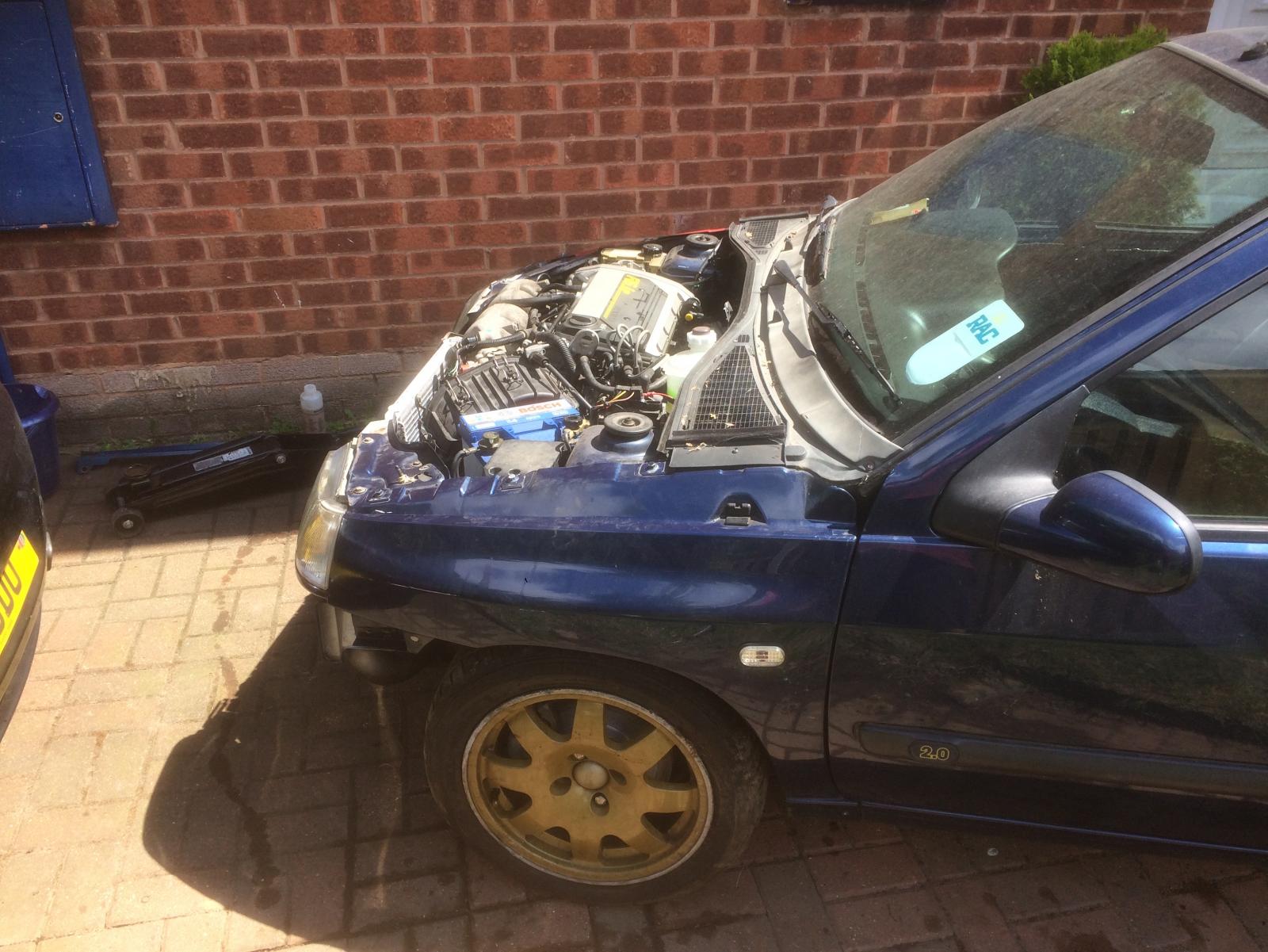

However, early today she looked like this:
It's been a job I have been putting off a while but today has finally seen me replace the brake master cylinder and the four callipers. All has gone well apart from I can't bleed the rear brakes. I'm guessing the brake bias compensator is not working so that will be the starting point when I next get a chance to play.
I have two brake bleeder appliances, one that draws a vacuum and one that pressurises the reservoir from a spare tyre. I have to say the vacuum one is a waste of time as air is drawn in around the bleed nipple no matter what plastic tubing I used. Pressurised one worked like a dream, on the fronts anyway... had a quick look and it doesn't look like replacement bias compensator units are easy to track down but here's hoping, anyone know if they had the same unit on the 19s?
