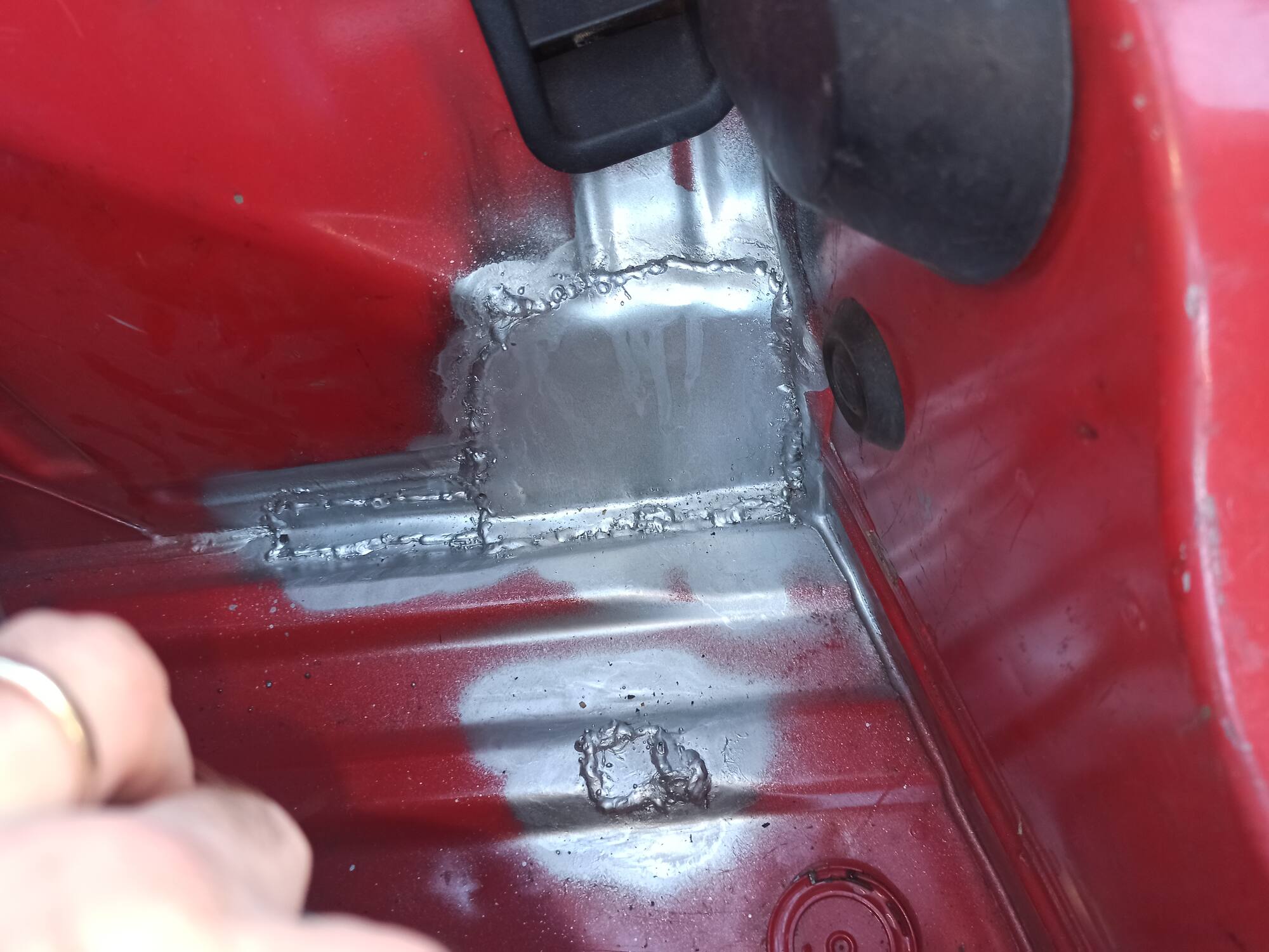

So without even taking any pictures I dived straight into the driver's side, which seemed to be the larger of the two holes. A decent session with the flap wheel on my 115mm grinder and the slit disc on my new Lidl 12V cordless 76mm grinder had me ready to start putting metal in, and a bit of a session with the lump hammer and pipe pliers had a bit of metal bent (very) roughly to shape. Here's the finished result all covered in silver galv spray:
It looks shit because it is shit; I'm an impatient and incompetent welder, But it is solid. So feeling full of myself, today I turned my attention to the other side where it appeared that the hole was quite a bit smaller.

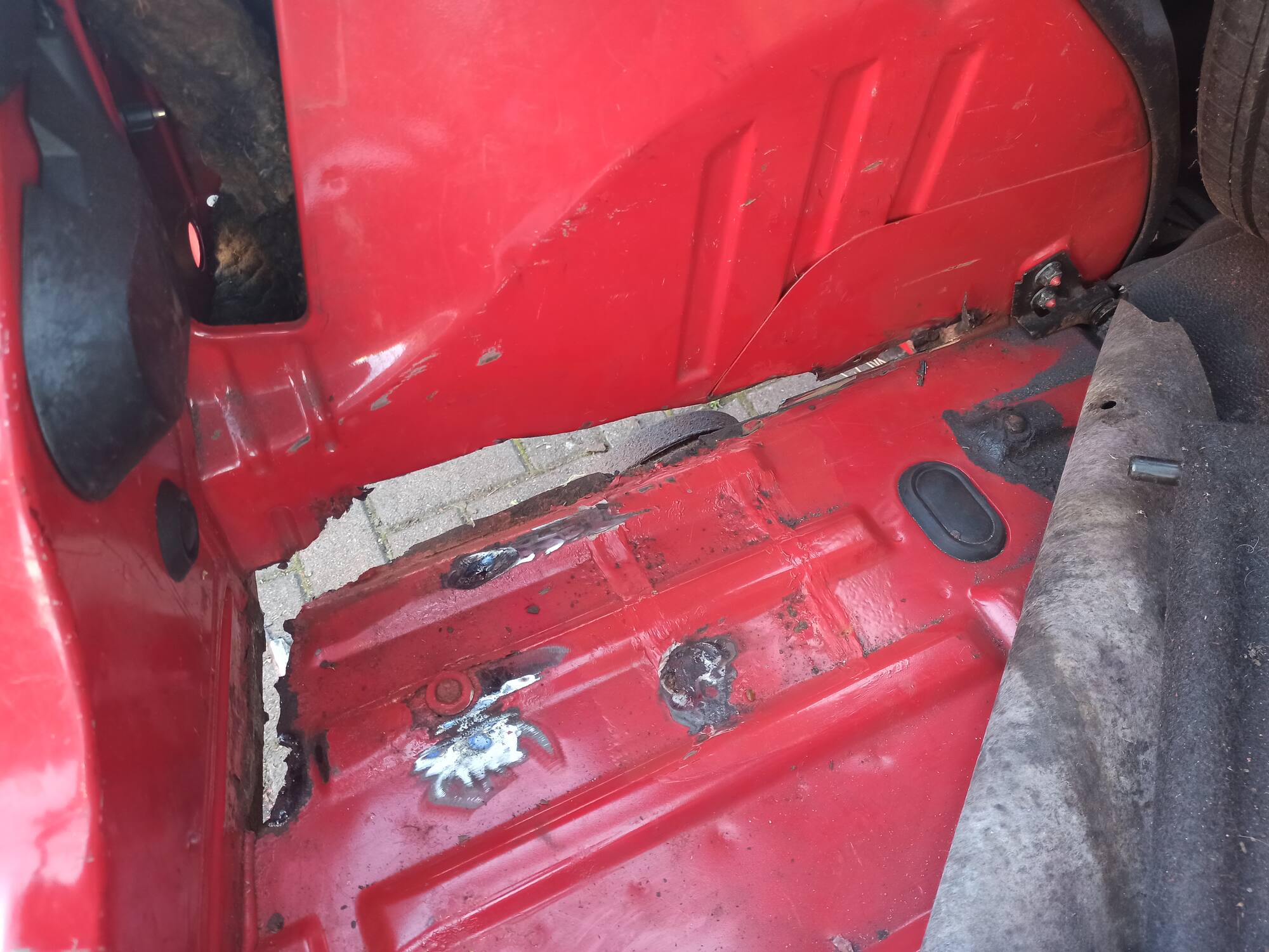

Oh.
TBH, that's not really going to present a problem, I just need to let a lot more metal in. The rust appears to stop just short of the rear seat back bracket, so I'm planning to lap weld a 90 degree piece between that section and the floor. Then I figure that rather than muck about doing loads of little patches I'll just cut the entire crusty section out of the floor and weld in a circa 12"x 8" piece of flat steel to replace it; I won't be able to form the factory ribs but my 1mm steel sheet appears to be about twice as thick as the original biscuit tin Peugeot used, so I'm confident it'll be just as strong. There's a bracket underneath the part of it that seems to have some extra seam sealer on it to hold the exhaust hanger, but hopefully I can clean that up and chuck a load of rust converter and galv spray at it before welding it back on from underneath.
But of course the other side looks worse:
As far as it's possible to tell from doing a forensic dismantling of a lot of crispy weetabix, I think the inner wheelarch panel was spot welded to that inner panel that holds the seat back bracket, and also a lower panel that for some reason forms a double skin just above the axle. Then it was all left to trap water, I guess. That delta shaped hole above the rubber bump stop reveals the interior of the beam that supports the boot floor. No part of the axle mounts to anything south of the rear main chassis rail, fortunately. So I don't think any of the totally fucked metal is particularly structural.
Basically, I need some advice as to whether to crack on here, or cut my losses. I'm happy enough to put the time in, but obviously I don't want to be selling anyone a dangerous car. I guess my plan would be to stop dicking about with the flap wheel, accept that all of that metal above the axle has got to go, and start cutting it back till I find something good to weld to. Then weld in a triangle to close off the bottom section, before sticking a plate on to join the inner wing to it. Then squirt a load of wax into the box section before closing the hole up. Finish up by spraving galv and painting underseal and stonechip all over. I figure that if Peugeot's crappy biscuit tin has lasted a quarter of a century before getting to this state, then my bodge up ought to prolong its life a few more years, but if it's not going to be safe then I guess I'll give it up.

holy moly,put the plate inside first ,than smoller plate on outside,if needed,seen, done worser on moggy minors,sill,floorpans,inner wings etc carry on regardless...
It certainly doesn't look structural. Disclaimer, I am a fairly novice repairer of frilly bits and can't see the rest of the car.
Personally as long as that's the extent of it, I would crack on. I wouldn't faff with indenting or making any of the metal look OEM. If you are using 1mm sheet I'd focus on chopping out as much as possible in a way that makes shaping and welding new panels as simple as possible for you.
If you double skin it as per original, seam seal where the edges meet. IMO it's the double skinning and crap factory sealing that starts off this kind of rot.
