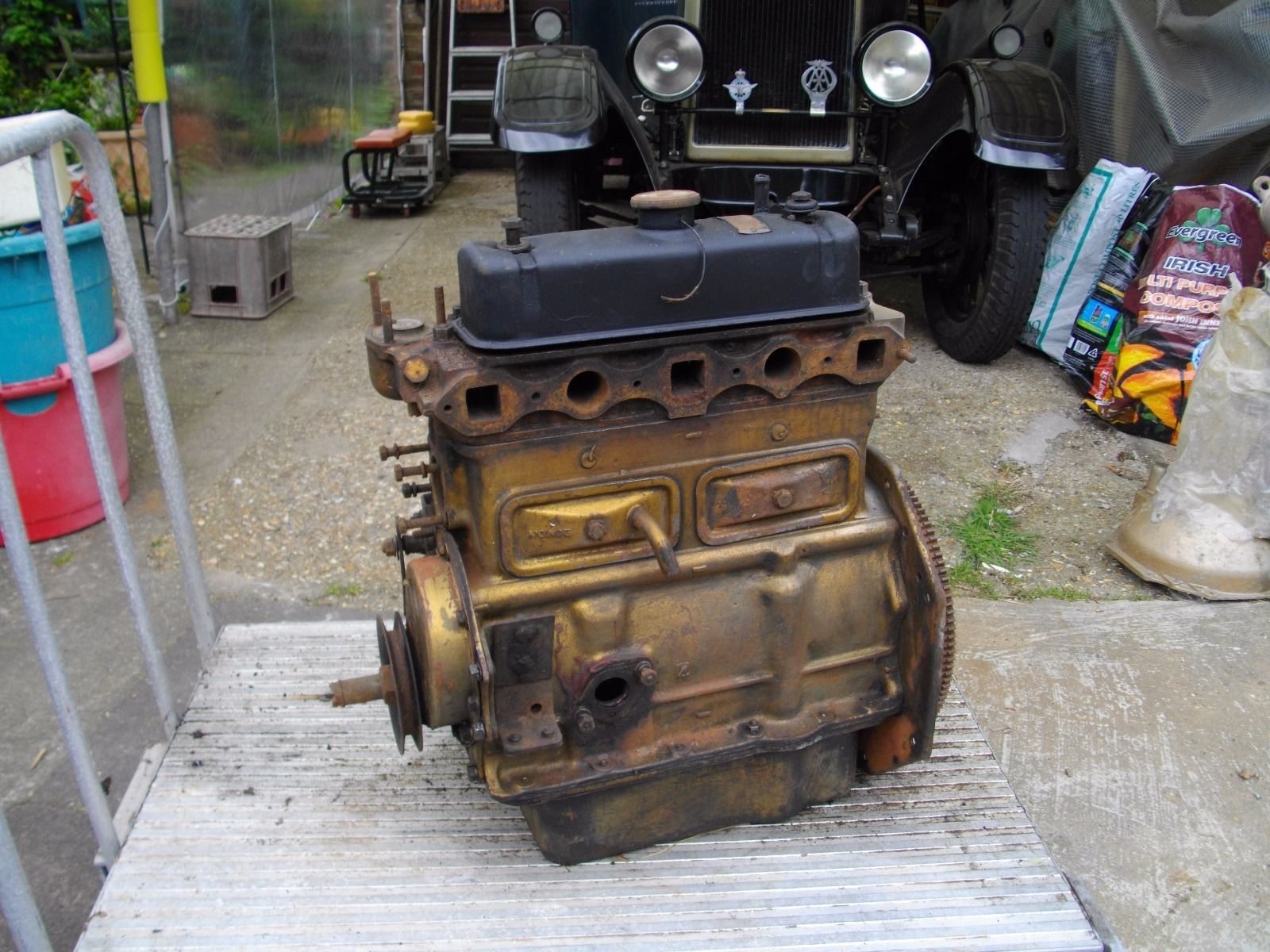

I have got a MG Midget 1500 engine and gearbox sitting here. It had trouble keep blowing head gaskets so could do with having the block decked and a head re-face. The gearbox is an unknown but a set of bearings isn't a lot of money. I should also have all the bits to bolt onto it carbs alternator etc. It would be cheap.
