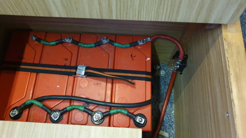

I got the rear batteries properly fitted and the 35mm2 cable run up to the split charge relay. I use a nice cable gland where it goes through the floor and ran a load of it before I remembered I had some conduit that was the perfect size. It's obviously fused properly (120A at either end) but I'd rather protect it as best I can.
With that I plonked in the inverter (£35, 1.2kW modified sine) and a 50A charger (came out of an ambulance)467786273_2019-12-2117_26_14.thumb.jpg.900ad9c9af1b39ce22b66e540993f087.jpg

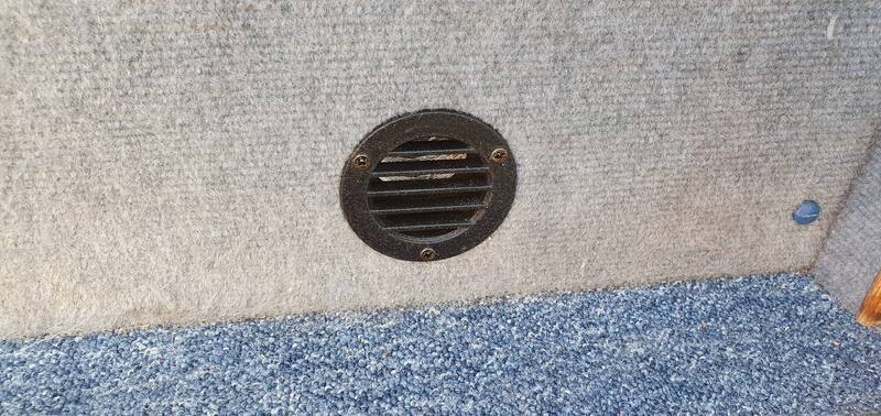

Obviously I'll need to move that cushion, it perfectly covers the vent on the charger. TBH I never use that cushion, it's for the useless bed extension between the front seats.
Pleased to say the inverter/charging system works great - I left the inverter on, powering the water heater as I drove out to camping. It takes about 80 minutes to fully warm the water tank from cold, and thats about 10 minutes less than the drive. It draws 55A which the alternator can easily keep up with.
I left the water heater on for a few hours before I had a shower and charged up my laptop etc, there's plenty of power.

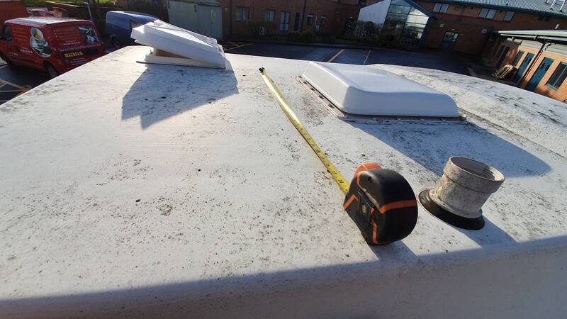

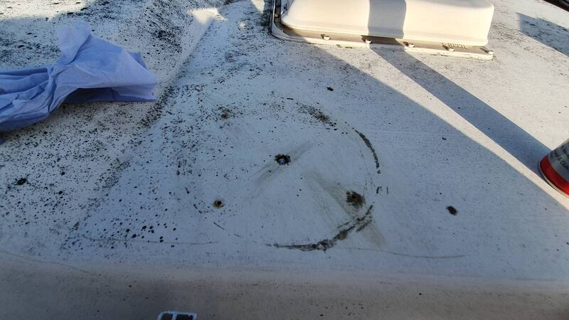

Anyway I came back from the pub last night to get settled down in the van and found water everywhere! I've had a "mystery" leak that I presumed was the skylight, but it only happened when parked at a certain angle, and yesterday I was parked at that angle. I followed the water up to a hole in a cupboard where someone had drilled a hole for a TV aerial:
I was going to fibreglass it up today, but when up a ladder I saw all that space and it got me thinking about a solar panel again. Instead of doing a permanent repair, I just siliconed a stainless M 8 coachbolt in the hole as I might use it for the power entry cables.
There's only clear room for a 50W panel unfortunately, but I have one of those spare off of my shed, so I'll fit that one day!

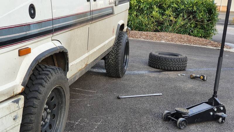

I bought a 10" wheel to try on the back because deep down I am a foolish manchild.
2110425672_2019-12-2914_10_46.thumb.jpg.3a365dabddaad8234ba69bd65aadfeb0.jpg519342571_2019-12-2914_10_39.thumb.jpg.876e77cd2018a993b887171bdbecb400.jpg
That's far too ridiculous, even for me - especially of a FWD vehicle.  Oh well! I'm keeping the wheels I have on the front (16x8) but swapping the Insa-Turbo Dakars to those tyres I have on the back soon. These mud terrains look cool but the rolling resistance is just unreal - I instinctively go to check if I've left the handbrake on 3 or 4 times each trip.

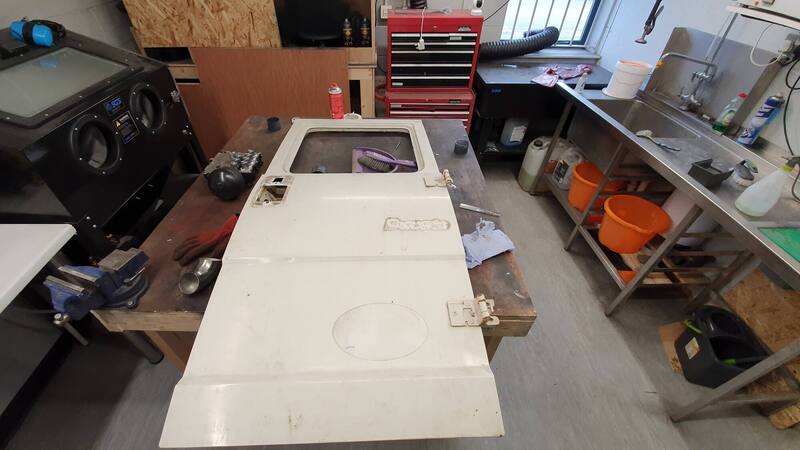

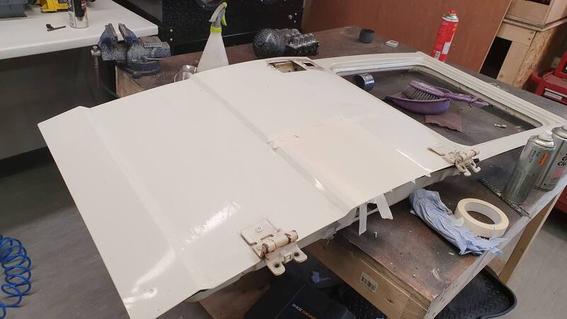

I made a start with the new doors I bought. Initially I'd planned to paint them, but other than a few scratches, they're not that bad, so I ran over on with the buffer to see how it'd come up - I'll do the same with the van and hopefully they'll match OK.
unfortunately, under the adhesive I found out someone had removed the ducato badge using half a brick, so I masked off the area round the mess and lashed over it with a coat of paint from a supposedly matching aerosol.
Of course the aerosol match is absolutely nothing like right, presumably it was matched over the phone.
I'll try the door on the van and if it's original colour is owt like the van I'll drop it off at the paint place and get them to mix me something close. I'll have to go through the charade of pretending the paint is actually for a lawnmower or a tractor, otherwise they won't be able to sell it to me to paint a van with.

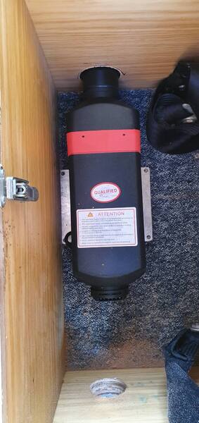

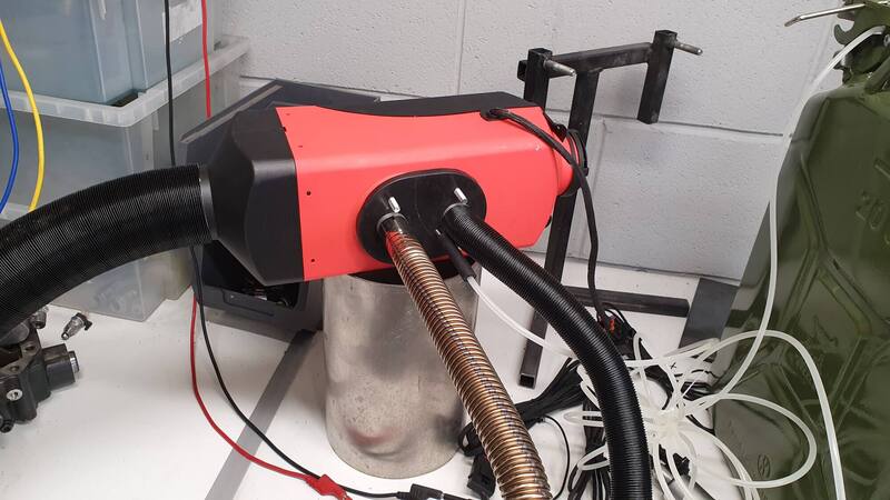

I also finally got a 2KW Diesel heater. This thing is immense  - It'll fit in the spare space next to the batteries, and I really can't believe the heat it kicks out. I'm glad I went for a 2KW instead of a 5KW, as even on the lowest setting this thing really is fierce. I've been running it up on the bench all day to make sure it doesn't pack in as soon as I've fitted it. It's absolutely amazing for £92. I just need to work out where to put the fuel tank.
be careful where you point the outlet- there's moar than one West Midlands Ambulance Service vehicle with scorchio marks on the floor!

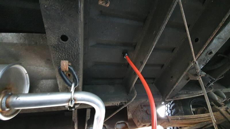

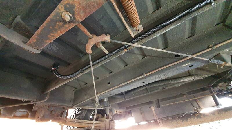

Over the last week I got the heater fitted. I wanted to fit it behind the gas heater, but when I really got started, it wasn't practical - all the holes through the floor ended up having chassis in the way, so I put it in another cupboard that I barely use - It had a shit tool kit and an old stinky sleeping bag in, both of which I forgot I owned.
The intake is over by the sliding door which is a really cold spot:

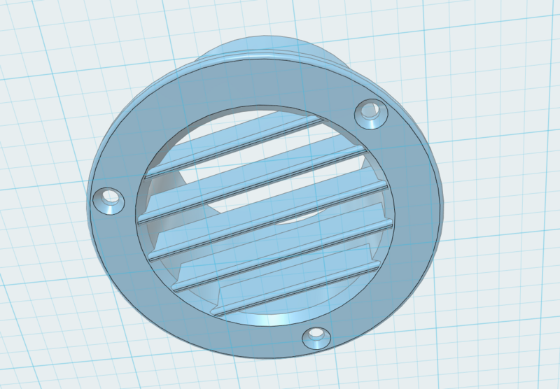

I didn't have an intake grille, so I drew one up in "naff 1980s style" and 3d printed it:
I think it fits in perfectly.

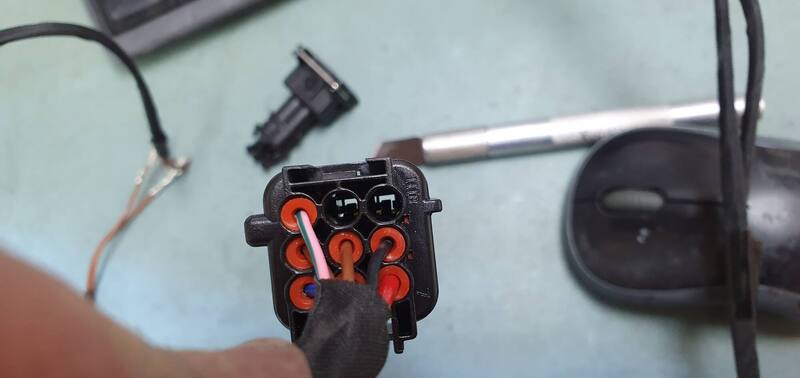

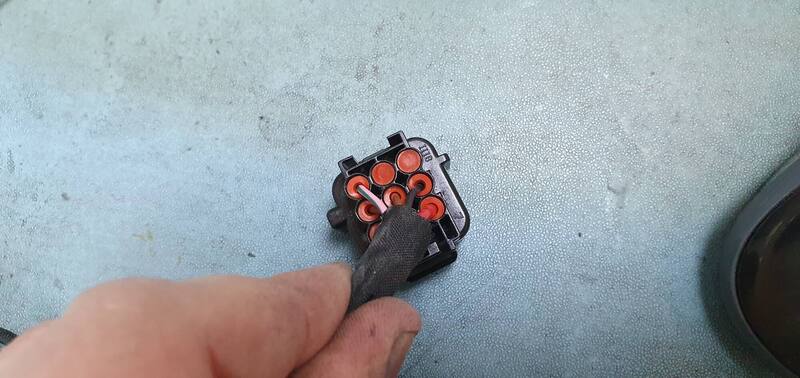

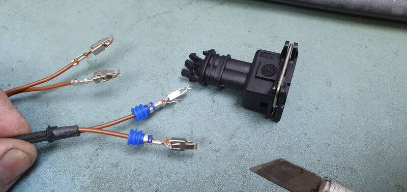

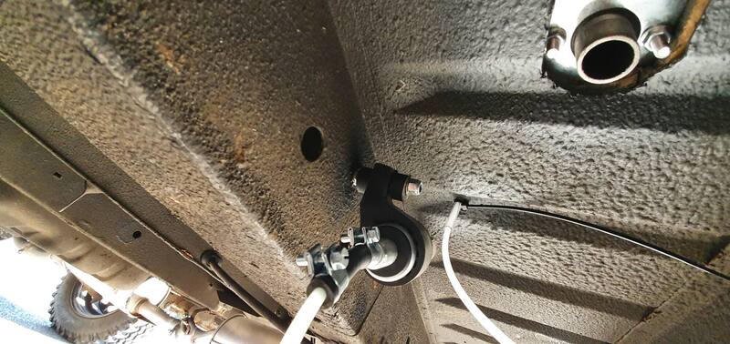

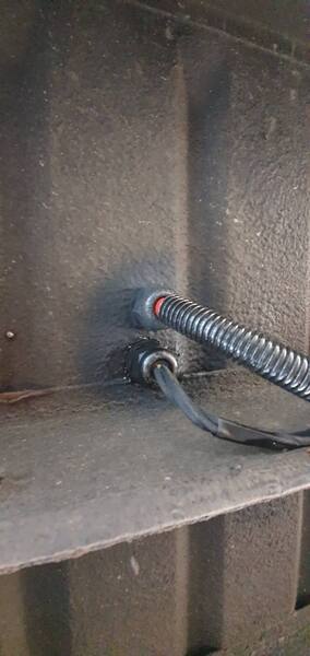

I paired down the wiring loom a bit, shortened the pump wires etc and noticed that while all the connectors are sealed for external use,  none of the connectors had all the wire seals fitted, so I fitted some.
2110891798_2020-01-1715_29_41.thumb.jpg.0acebffd2b01d773e3adc368da4a9a82.jpg1525903058_2020-01-1715_32_53.thumb.jpg.0d1d62709dc202b8f97be9b3627d261f.jpg1378914089_2020-01-1715_31_38.thumb.jpg.1550a7d1b4461478579a47e69cd38b16.jpg

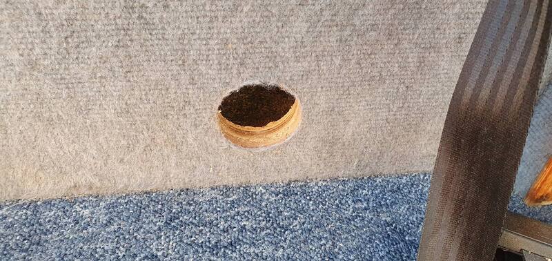

I ran them through a new gland next to the main charge wire for the pleasure batteries

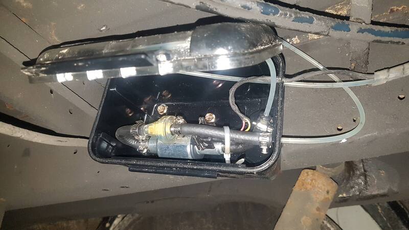

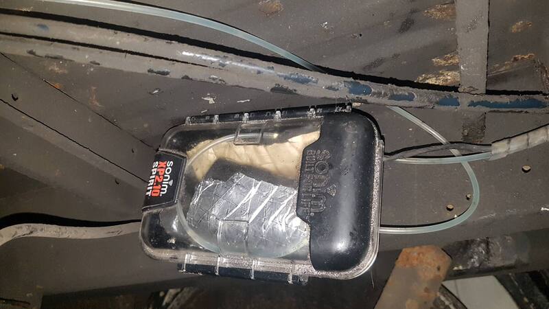

I then fitted the pump on it's rubber mount with a load of rubber hose to dampen the clicks, but it didn't work, I need to redo it - it's noisy.

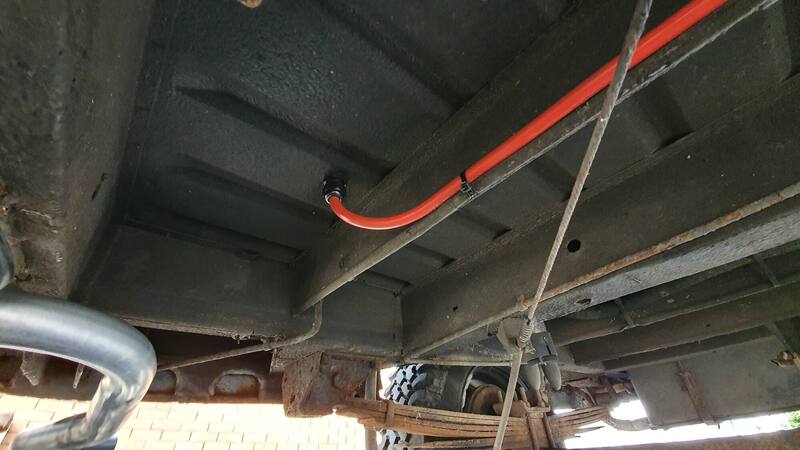

The little 5l diesel tank is fitted inside the van for now. Not ideal but I couldn't be arsed running a pipe all the way up to the engine bay. If I can fill it without spilling everywhere, then there's no smell. 5L will last about 50 hours of use.
So here we are - It's -2 outside, and I'm in the van with the heater set to the lowest it will go, and I'm really warm. I'm sat here in my underpants with the roof vent half open.
I'm glad I went for the 2KW version instead of the 5, this thing is still way more powerful than it needs to be. Great success! I just need to mount the pump on something softer because it's quite noisy - the heater fan noise itself isn't very loud, but its quite an inoffensive noise.

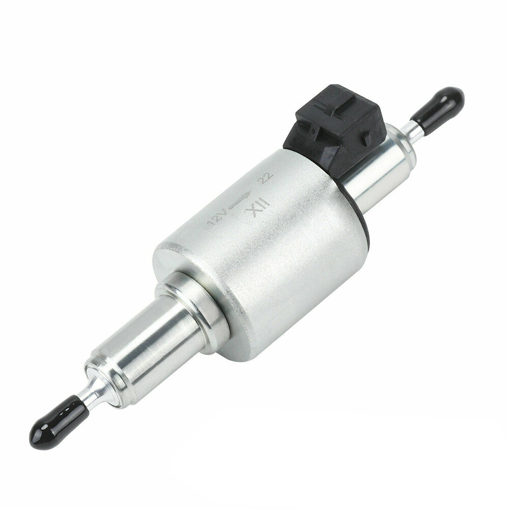

Nice bit of installing, these Chinese heaters do work really well, what kind of pump does it have?
They're a doser pump - the pump a fixed squirt of fluid per pulse and the heater controller varies the pulse frequency from about 1.5Hz-5Hz.
My pump is the smaller type that pumps 0.016ml per "click". Some people hang the pumps with cable ties, but I think I'm going to sandwhich it inside sponge inside a little box. It'll keep the water off it, too.
What worked for me was to suspend mind just above the floor (by about 1/4") by a bit of tension on the fuel lines, that seems to have pretty much eliminated the physically transmitted click.  You can still hear the actual sound a bit but it's pretty subtle and inaudible with the fan speed anywhere above the lowest setting.
That's what I did,but sadly I can still hear the damned thing!
I'm seriously considering getting one of these:
https://www.aclsretail.com/index.php/item/87-challenger-diesel-autoheat-whisper-quiet-fuel-pump
Either that, or drinking more heavily in the evening before so I pass out and can't hear it!
I don't personally mind the noise, I just don't want other people to hear it. I don't often camp in places where there's another van withing spitting distance, but sods law last night I ended up bunged in the car part about 4 meters away from another van as they'd closed the grass off for a few days.
I'd bring the pump inside the van, but I'd rather keep as much of the fuel setup outside so any leaks just go onto the floor.
I've got my eyes on a die-cast aly box, and some bulkhead hose barbs. I'll use a loop of (probably if it's diesel safe) silicone hose inside to really isolate the hoses and probably dampen the pulses a bit.
Those pumps won't work on my heater (mine needs a .016ml pulse instead of a ,022) but I've heard (ho ho) that they're not really much quieter than the standard ones - I wonder if they'll sell the damper separately?
