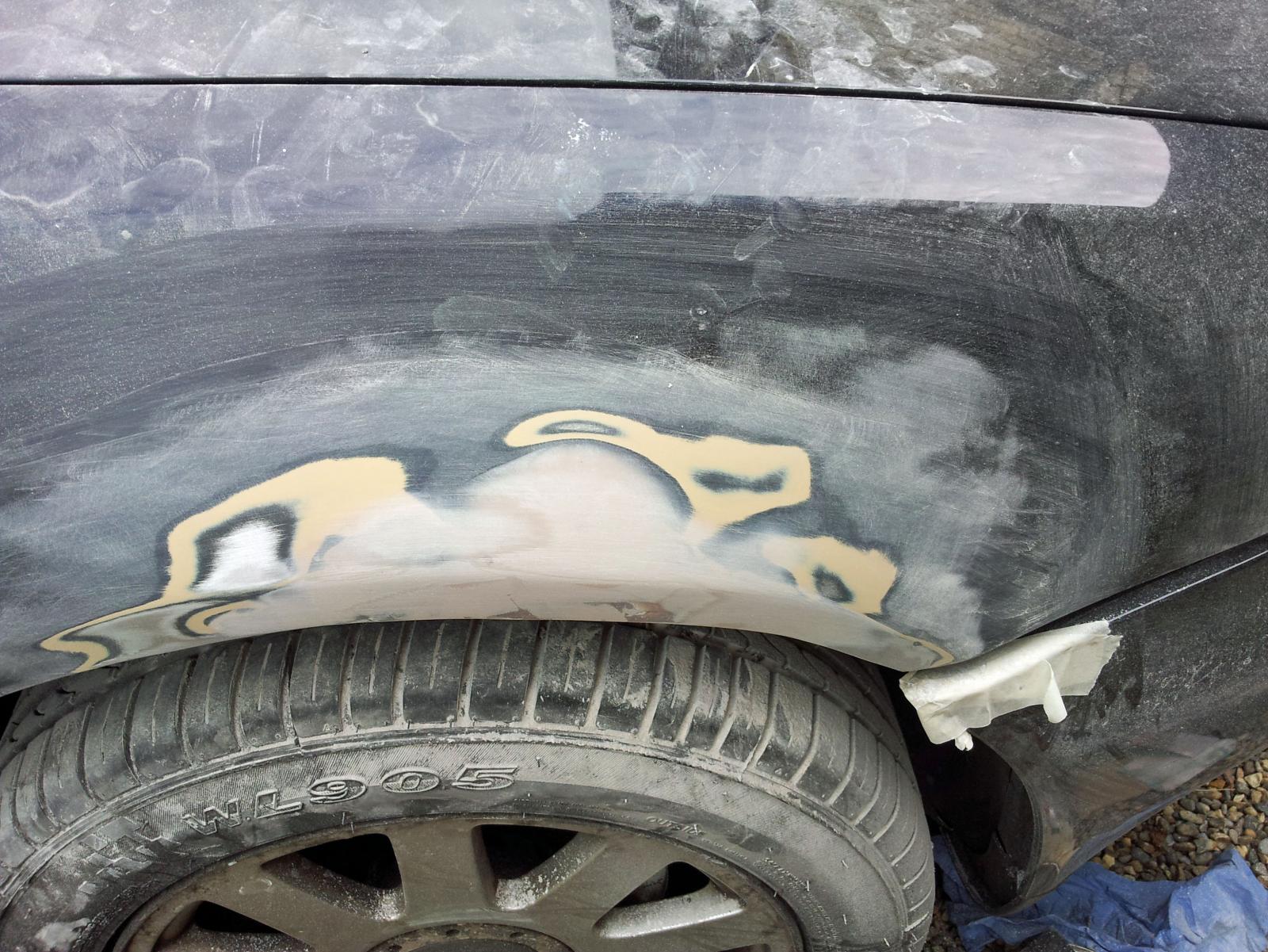

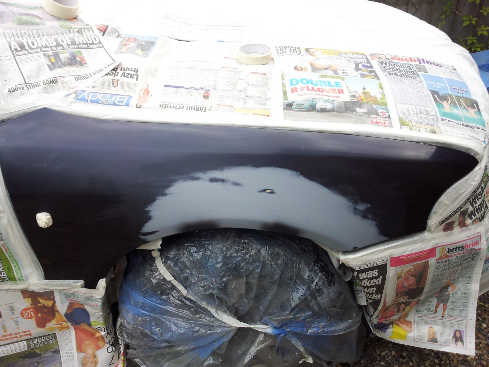

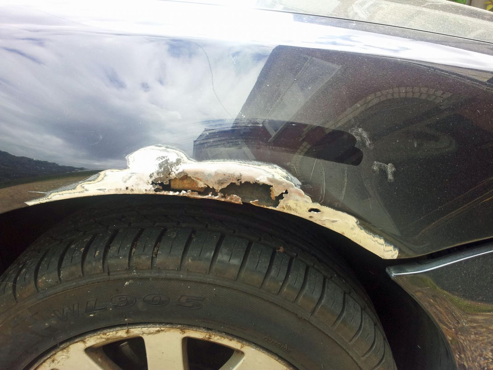

Probably more of a bodge than a alternative repair but a several years back my arsehole neighbour asked if i could repair the wing on his A4, so i cut the rust out, pot riveted a baked bean can to fill the hole, a bit of filler and same paint and came out like new!, amazingly it's lasted another 3 years before he scrapped the car and it still looked perfect even then. He paid me £100 for doing it too.
Wow - that is amazing!!
Note :- Photos are in reverse order!!!! ;-)
