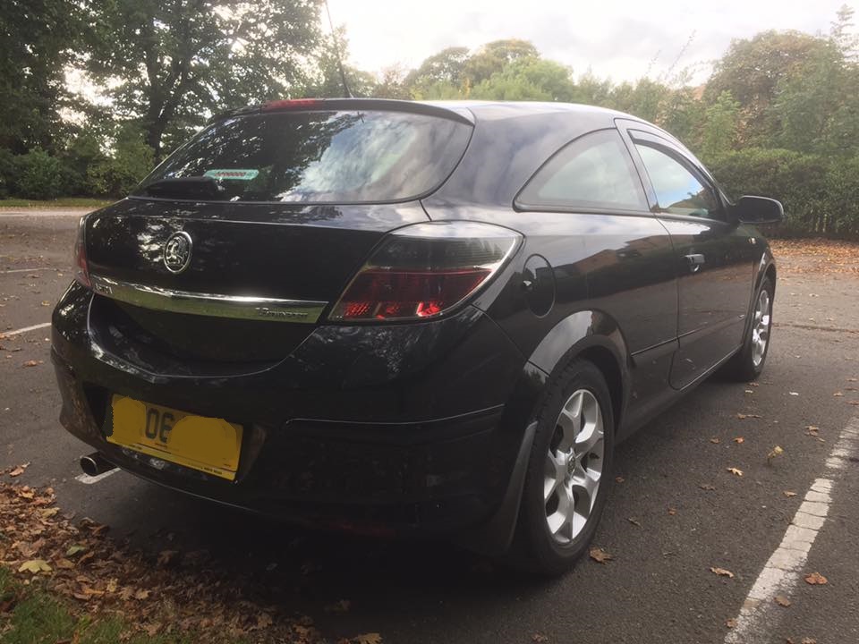

Right, the Zafira's gone now. That meant it was time to fire up the Astra H as it's sat for a while unused....
Hopeless visibility and non-working speedo aside, it's a bloody ace car. Love the look of these 3 doors, black lends itself very nicely to the shape too, imho. Great to drive, feels as nice as it looks imho.
